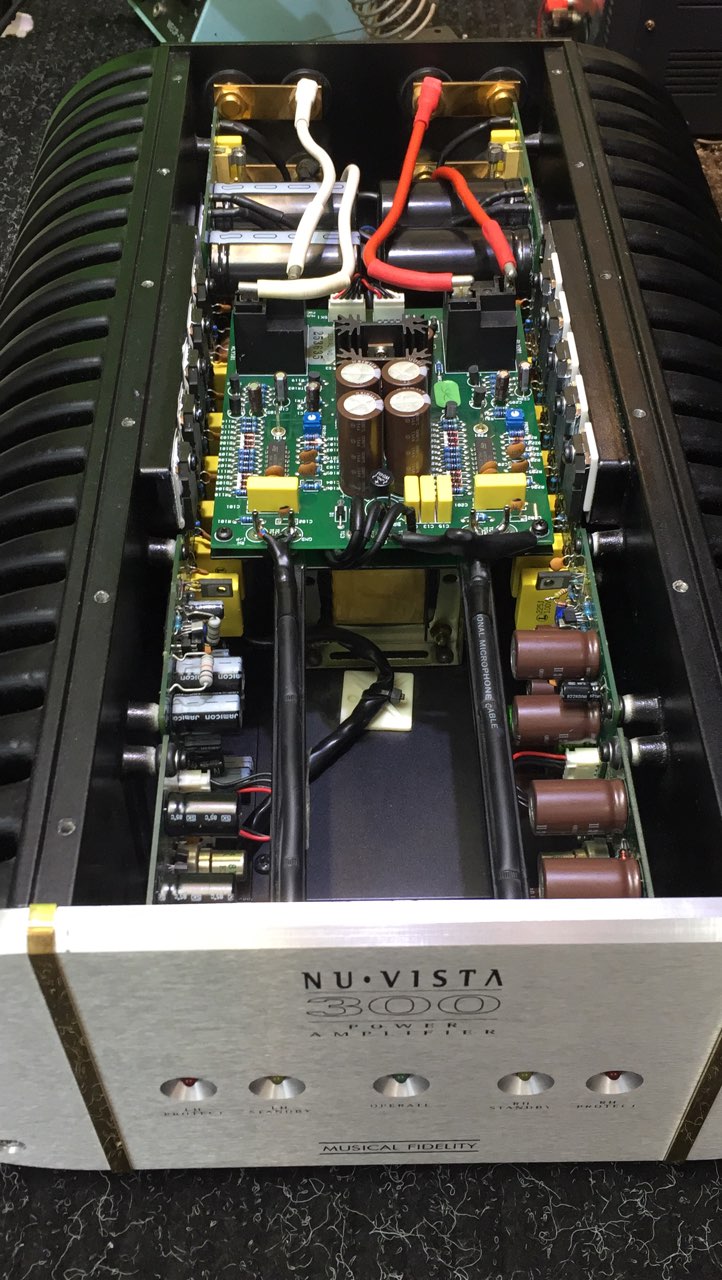

I have a Musical Fidelity Nu-Vista 300 power amp which I really love.

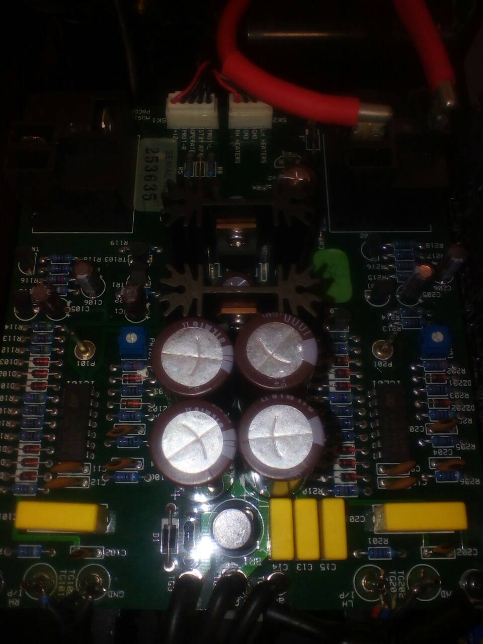

Recently I recapped it and now I am looking for TL084CN upgrades.
The amplifier uses one TL084CN per channel.
Brown dog adapters has two adapters to help me with that.
First is SO to DIP adapter that I could use for OPA1644.
The second and more interesting adapter allows to integrate two OPA1612 as TL084 replacement.
Has anyone tried it?
I don't ask if it's worth it since this is a high class amplifier and deserves a better opamp.
If anyone like, I could provide with high resolution images of the pcb's.

What task is the opamp performing in the amp?
There is an discreet toroid transformer that powers the board, the board it self also contains the amplifier protection with it's relays. The rca input cables come first to this board and after wards to the line amp pcb (the nuvistor single board per channel) for each channel.
You will be hard pushed to use an OPA in that position.

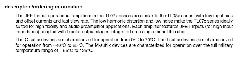

The TL084 is a quieter version of a TL074 and it is a quad op amp!
I always thought it was the other way around!
But looking at the datasheets, both op-amps have the exact same distortion and noise numbers and graphs!
On the other hand, TI, in the datasheet, suggests to use the TL07x chips for high end audio circuits.

The rca phono inputs are connectet on the input of the pcb where the op amps are and from that pcb to line amp and so on.
Well, in that case, it seems that TL084CN's are used for the signal processing, most likely to sum the phono input signal, and the feedback signal, into a single-ended output -> see attached.
If my assumptions are correct, you could try OPA4134 as a drop-in replacement. Just make sure that the Vcc / Vee are not greater than + and - 18V.

The pcb that holds the two TL084's has a discreet power supply from a discreet toroidal. At the pcb power supply there is a pair of 7812/7912 so the power supply it's 12V.
