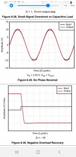

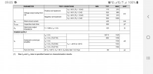

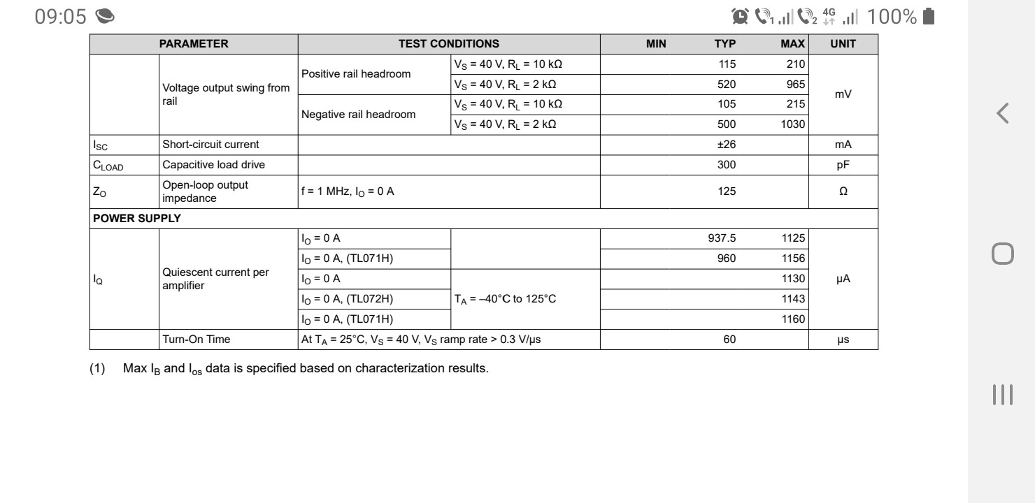

20v/us is more than enough for audio,+-2.25v.... +-20v supply says it's not working only for battery operated devices, 940uA quiescent current keeps your battery alive ...I'm not gonna post all the datasheet of tl071h-tl081h here just because....

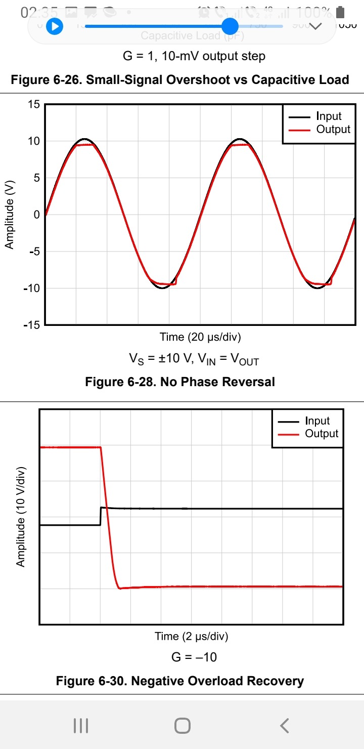

Do these also suffer from the inverting output / rail clamp when operating near rail Voltage like the elder ones ?
The old TI TL084 data sheet specified a common mode input range that you had to stay 4 volts away from both the rails.
This is a lot of voltage and many designer got caught on this when using low voltage rails like +5V/-5V.
The new TL084H data sheet shows the common mode input range extends to the positive rail and down to only 1.5 volts above the negative rail.
A very big improvement.
Unfortunately TI has stated they will NOT release undated spice models for the "H" version making simulation of any of the "H" advantages not currently possible.
Pity, I stopped designing without spice in the 1980s.
