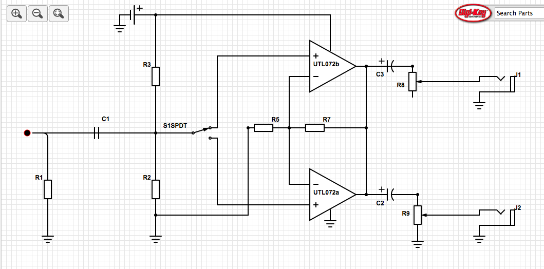

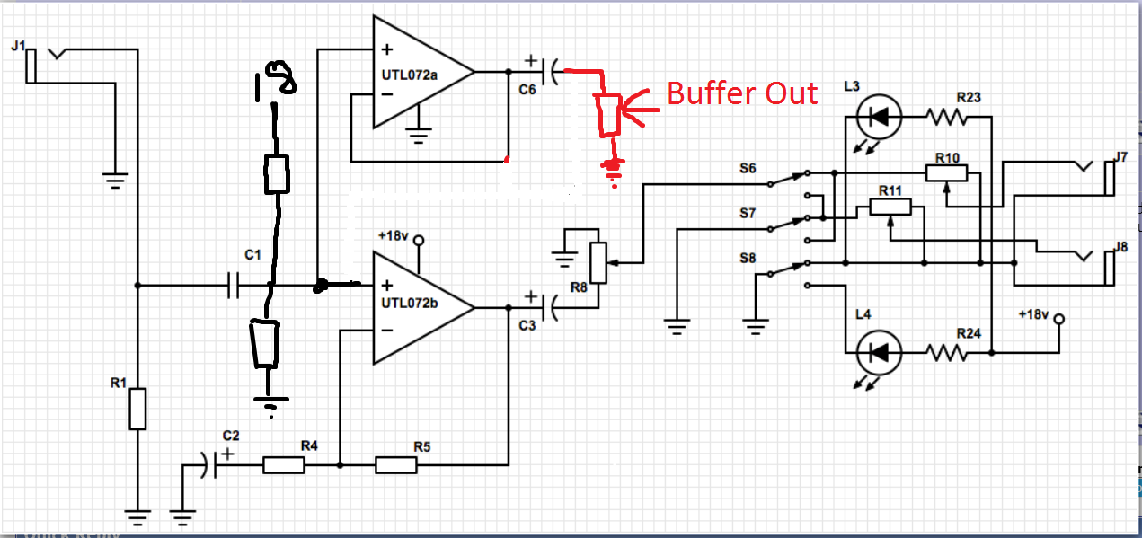

TL072 2ch booster
Update on the circuit.

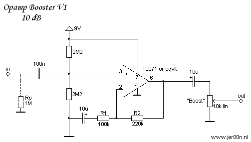

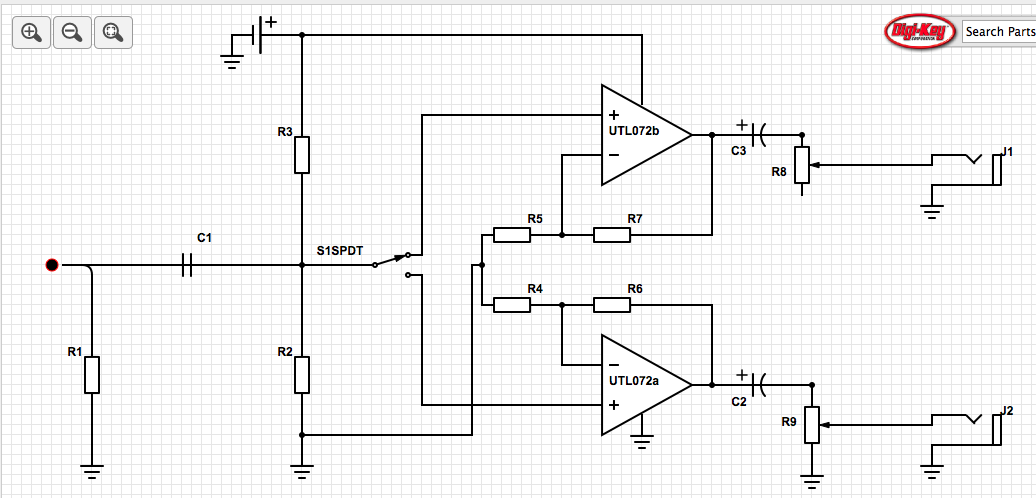

The sound has improved allot in the low end. C2 and C3 are at 10uf. C1 is at .01uf. R6 and R5 are now 220k. R2/R3 are 1meg. R1 is 470k.
The main purpose of this circuit was to have a A/B box with a adjustable 10db boost at each output, not to drive long lines, well at least no more than 10m. The boost was intended to be used musically, ie: to drive the input of a amp harder.
For all intensive purposes i could add a third TR output, then add a cap between the op-amp out and the jack.
