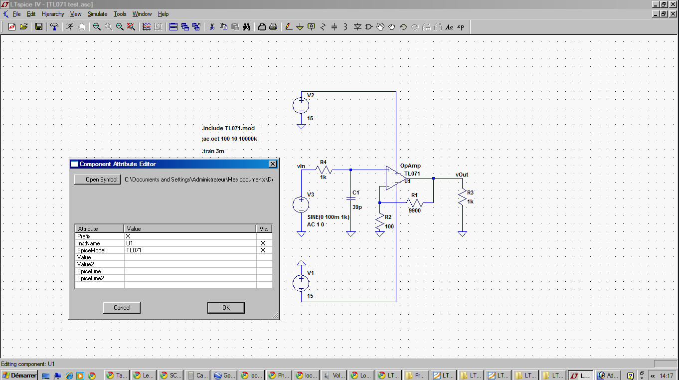

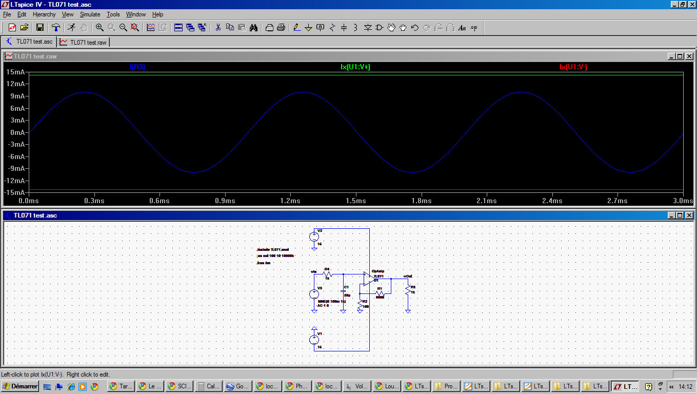

Homework done on LTspice IV. See attached .zip package. This TL071 TL081 macromodel supplied by Texas Instruments looks fine regarding gain-bandwidth product (not tested the slew-rate yet), but according to me it is definitely wrong regarding the current taken by the OpAmp supply pins. Would you check the .zip package on your side and tell me if you agree ?

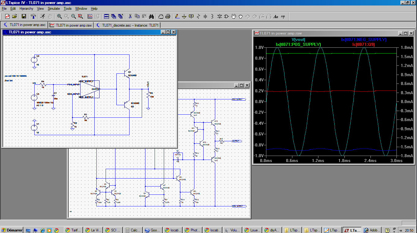

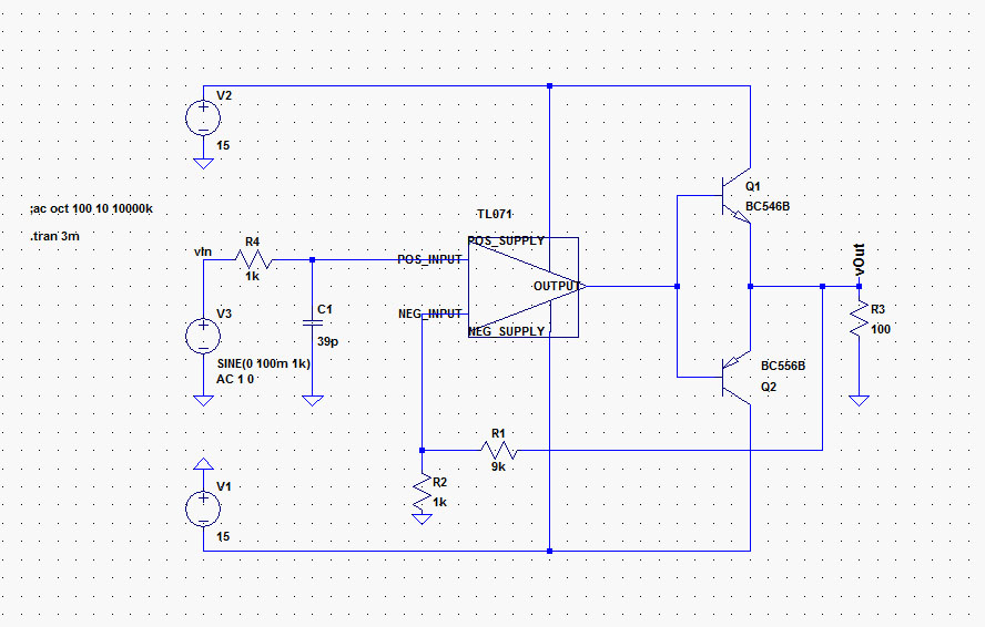

two big advantages of LTspice IV over Tina 7 T.I. is the ability to define new parts, and the ability to work using hierarchical design.
TL071_discrete.asc is the hand-made TL071 schematic, fitted with input/output ports for using it into a hierarchy. There is no ground.
TL071_discrete.asy is the symbol to be used if you want to insert a hand-made TL071 in your circuit.
TL071 in power amp.asc is an example of how to embed a TL071_discrete into a design. It makes the top-level schematic easy to read.
When the main schematic is open (TL071 in power amp), it is possible to open the low-level schematic (TL071_discrete) by right-clicking on the TL071 symbol. You then get a multi-window workspace, with both the high-level, and the low-level, at transistor level. Under LTspice IV "run simulation", all the voltages and currents of the low-level circuit can be probed provided some options are duly activated into the control panel. As explained in page 34 of the LTspiceUserGuide, those options are "Save Subcircuit Node Voltages" and "Save Subcircuit Device Currents".
