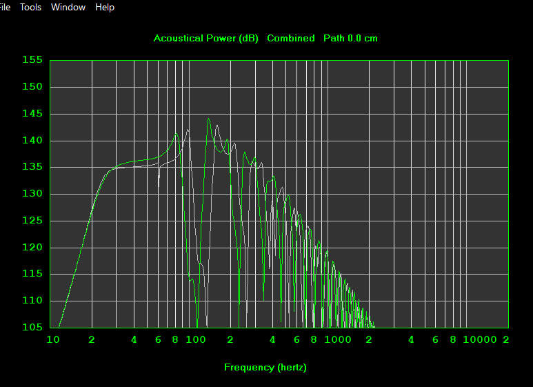

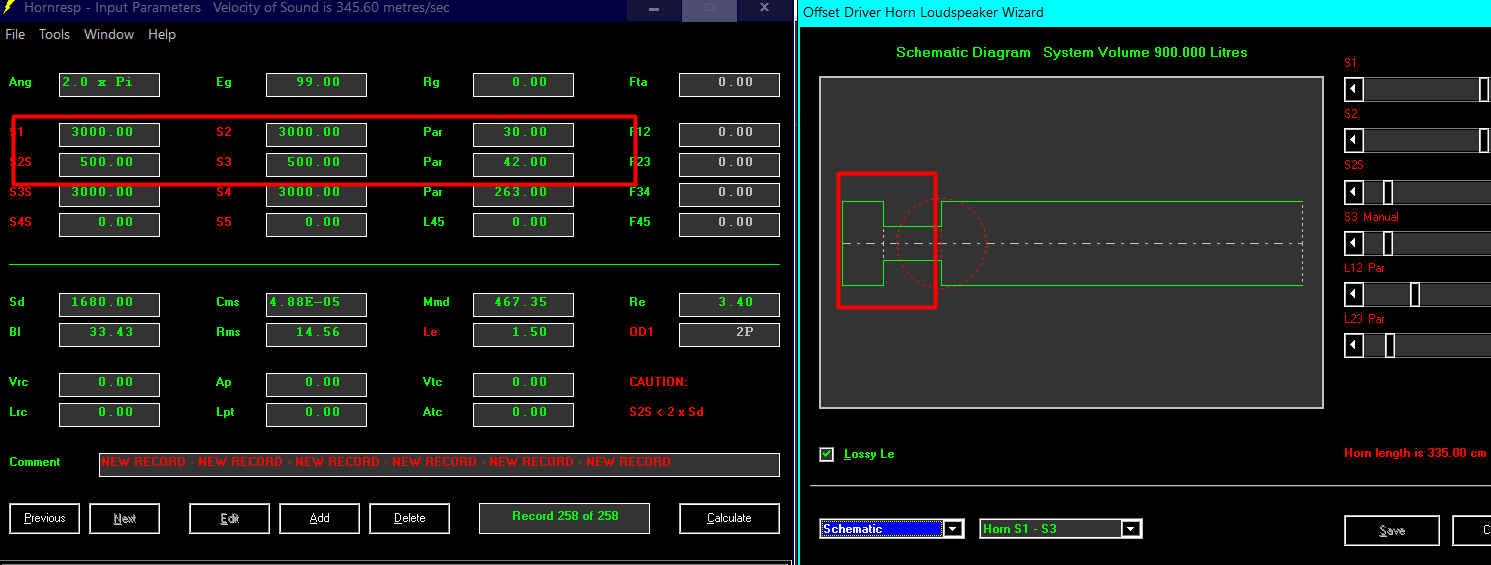

TL with helmholtz @ closed end?
In stead of the standard ‘offset driver’ To kill that second pipe resonance?
(I’m just being a nerd-geek)
the 3000cm2(90 liters) @30 cm and 500cm2 42cm port (~50 hz in the green graph )
verses the 3000cm2 offset at (~1/3) 107cm in 300total.

ID = 54.10
Comment = NEW RECORD - NEW RECORD - NEW RECORD - NEW RECORD - NEW RECORD - NEW RECORD
|RADIATION, SOURCE AND MOUTH PARAMETER VALUES:
Ang = 2.0 x Pi
Eg = 99.00
Rg = 0.00
Fta = 0.00
|HORN PARAMETER VALUES:
S1 = 3000.00
S2 = 3000.00
Par = 30.00
F12 = 0.00
S2S = 500.00
S3 = 500.00
Par = 41.00

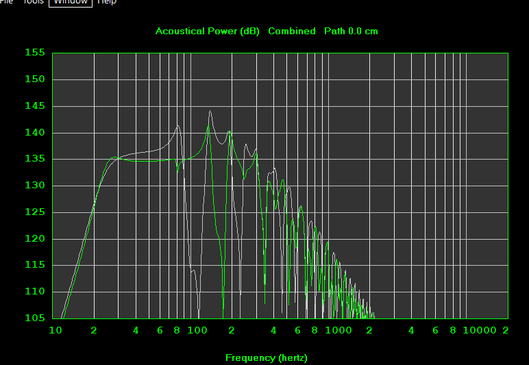

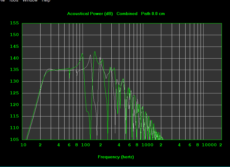

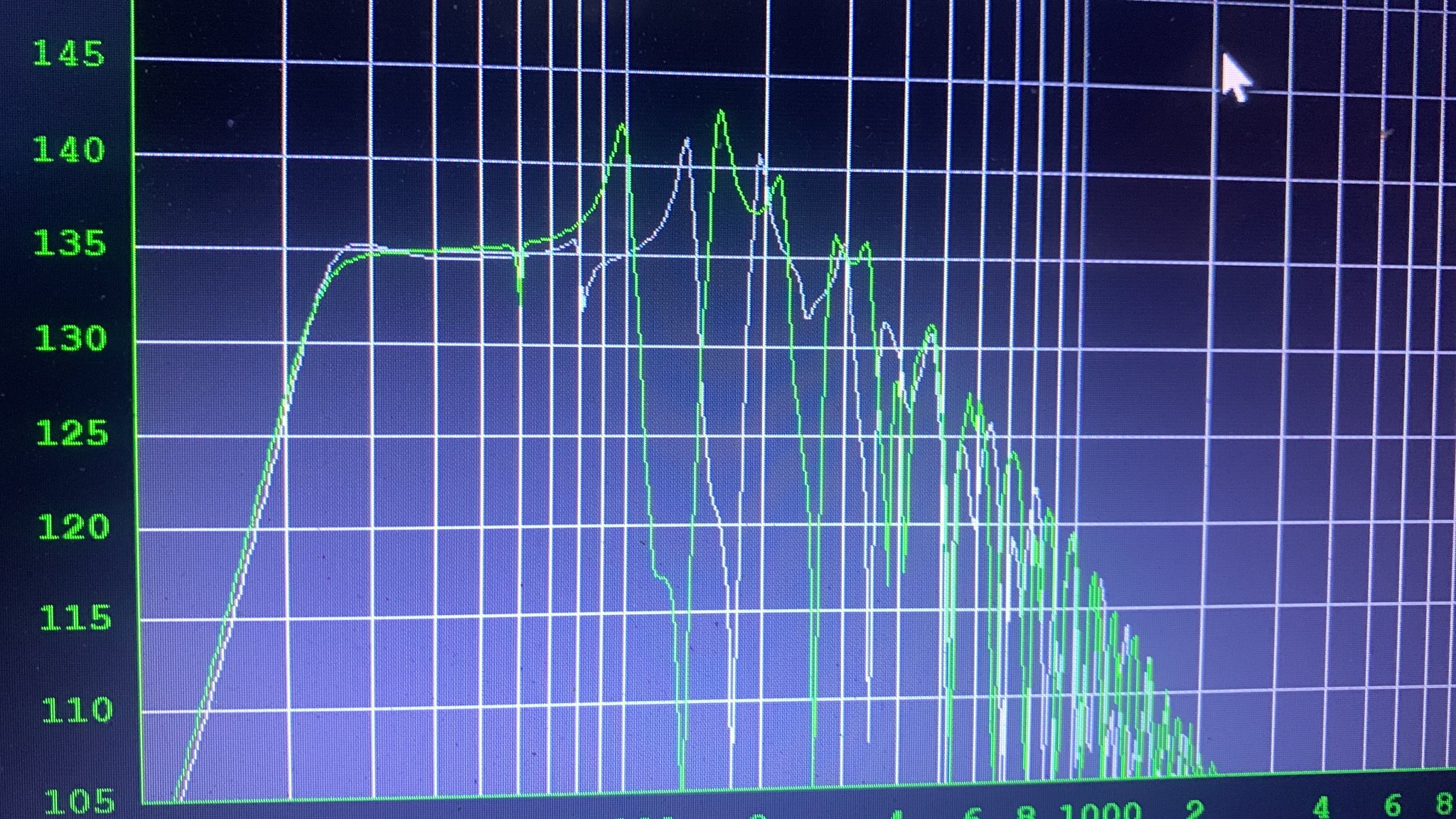

yes sir... i think ? or my dumb@ss is chasing my tail 😀
I dunno if Ibe got ‘apples to apples’, but Fb is The same in all of them
(top pic is the straight TL in white and the offset version in green )
