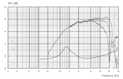

There are some differences in tweeters. The Event tweeter has a larger faceplate.
There are some impedance differences, especially around 1500 to 2000 Hz. I would suggest making sure the tweeter is hooked up to the crossover it came with-that is, ProAc tweeter to ProAc crossover, Event tweeter to Event crossover. I would advise against mixing.
The woofers are the same, so it makes no differnce there.
That website I gave you has the ProAc crossover schematic, if you want to homebrew it.
Here is the Event tweeter.

The ProAcs are 8 element crossovers, the Events 6 element. The ProAc design seems slightly more sophisticated because on both the high pass and low pass sections, the series component is broken up into 2 parts with a parallel element between them. In the crossover world, however, where simpler frequently equals better, I can't say that's necessarily an advantage.
I have not had experience with either of the Scanspeak tweeters. The event's cost $76 at Madisound, the ProAc's cost $56. Each.
If you take a look at the dispersion charts, you see that the 3/4" ProAc tweeter has better dispersion than the 1" Event tweeter. If you take a look at the bottom line-60 degrees off axis-the difference becomes fairly large. That would tend to indicate that the highs on a ProAc might have a special "sheen".
However, I have not gotten around to using 3/4" tweeters so I cannot say. And highly priced, highly rated systems use 1" tweeters.
If anyone has had experience on 3/4" tweeters versus 1" tweeters, please jump in here.
Of course, there is some difference in cost. Two ProAc tweeters are over $100 right there, than add the crossover cost. You already have the Event tweeter and crossover.
