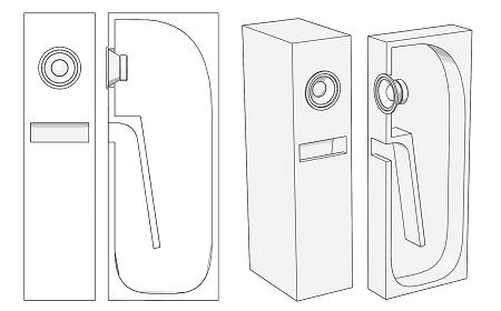

Okay, everyone,
Here is the latest design based on MJK Alignment Sheets. I haven't started on a design using dual driver yet since I intend to use a left and right pair and already have a pair of drivers. I've shown driver Sd comparisons which put the pair of 6.5" drivers at greater area than 8" driver so more air moving with the same amount of excursion.
I've also shown the physical dimensions of the proposed TL.
My next step is to to figure out how to make it shorter in stature so it can also be used as a stand for the mains. I'm thinking at most 32" - 36" tall so it's going to have to grown deeper somehow.
🙂ensen.

Box OD = 11" x 17" x 44.5" (WxDxH)
Line width = 9"
Taper from 15" to 3"
L = 67.8" measured by CAD
So= 135 sq.in.
Sl = 27 sq.in.

purplepeople said:Here is the latest design based on MJK Alignment Sheets
That design has a good feel to it ... i wonder if the smooth curves of the inside could somehow be reflected externally....

Poo! I was just looking at the calculations again and the TL dimensions are based on Sd = Driver size area - voice coil area. The new driver size is about 5.375 based on the surround and including the voice coil. So now I have to re-work including the enclosure.
🙂ensen

I've got a couple of comments, so take them for what they are worth.
1. I think that some of the impact of low bass comes really, from the ability to generate high spls. This requires swept volume-period. I currently have two ML TQWT's in my house, and working on a third. One has a 5.25" driver and an f3 around 40hz. The other is based on an 8" and has an f3 around 30hz. The difference is quite astounding. It is not explained by the 10hz difference.
2. Two 6.5"s should be better than an 8" as there is 30% more cone area, but your internal Sd will have to be 30% more, give or take, depending on your model. So if size is important, two 6.5's is more problematic for you.
3. Consider a short, squat ML TQWT. The line length in my 3 ways is only 40" and the base is a 12x12 square. I guess it depends on your definition of large.
4. Not to poo-poo TL's, as I'm very found of them, but I think for a sub only application, I'll assert (without supporting arguement-too lazy right now) that a sealed box is better and smaller to boot. If you're really only going to run it under 100hz, well...
But, for a 2 way or 3 way with an 8" LF driver, it's hard to beat the sound of a TL.

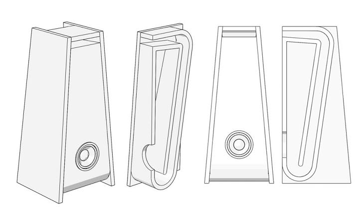

Many thanks again to Martin for his theory. The calculations worked out to So = 56 sq in and Sl = 12 sq in with L = 73" and offset just under 24" so I end up with something that looks like a Voigt pipe with the point sawed off and bent around a couple of corners.
I couldn't do this shape without the 3D modeller. I'm pretty good at sketching, but the software let's me keep an eye on the cross sections, which taper smoothly from one end to the other. It's still a box and so is fairly easy to build, although I still haven't figured out how to fabricate the large radius bends. I definitely don't want to be forming plywood and will work something out in MDF before I start.
The 2 axis tapers are in reverse initially as the width expands and the depth decreases. Then, after the bend, I run almost parallel and let the decreasing width take care of the changing section. Finally, the last bend is almost constant width so the depth changes.
The radii for the bends are not complex curves. I still haven't figured out the best snap points for my splines, so for this, I'm running an averaged radius. In the case of the big bend, there are two arcs of R=3.25" each and there is a small 1/4" section of flat at the bottom to make up the overall depth at that point.
This one will not be final design as the cabinet is top heavy and the driver is too far from the terminus. I'd like to get them both fairly close to the top of the unit so that I can take advantage of any directionality in the output and have them both near any mains that might rest on top. Besides, a driver that close to the ground is a little too near all the footwork, pets and 2-year old nephews.
🙂ensen

purplepeople said:so I end up with something that looks like a Voigt pipe
A Voigt pipe would have the terminus at the end with the large XSection... yours is just a kool tapered TL.
At the wavelengths of interest the terminus & the driver are essentially in the same place.
dave
