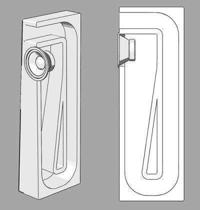

Has anybody every used a driver less than 8" for a transmission line subwoofer? In particular, the Dayton 6.5" woofer - Parts Express #295-306 - but others would be interesting to hear about. Note: the specs are below.
The enclosure will likely be a folded TL with the driver near the top of the front face and the open end of the line wrapped so that it exits out the front just below the driver. The overall height will be about 3 feet with a line length of about 6 feet. This way, it might be useful as a stand for my mains or my surrounds.
I plan to build two so that they can be driven in stereo for music and mono'ed for home theatre. My intention is to drive it with an old Sansui R-70 plugged into my old Teac 2A mixer with a passive band-pass in between (10~150Hz). Someday they may each get a chip amp with a band-pass input buffer.

Hi x.o
I'm actually trying to get the last octave as the mains already have -3dB of 40Hz. Playing sine waves from my Denon Check CD indicates that 61Hz notes are clear, but only vague "sounds" are coming at 31Hz, which points to the published specs probably being correct.
The goal is to make the -3db point even lower for HT and even some music, especially if I ever end up having that apartment warming party. In particular, there is this one track on a Global Underground CD that does a bass downsweep. I'm curious to know how far it goes.
So, the whole design is about getting more low for less and everything I've read indicates that t-lines are really good at going low. Even lower than the others. The Daytons have lower Fs than other small drivers. By using the smaller drivers, I'm trying to get more from less size. By making the cabinet the size of a speaker stand, I get even more from less. By using two, I hope to get yet more.
An afternoon, you say? I've made the box more complicated by making the top rectangular and the bottom square, so I think I'm in for a bit more "fun."
The top to bottom taper is only external. Internally the line taper is constant from just below the driver right to the opening. The side view shows an aggressive depth taper to offset the widening of the cabinet towards the bottom. On the way back up, the line is parallel in depth to take advantage of the natural taper in the width.
🙂ensen.
🙂ensen.

So, according to Martin's Alignment discussion, the calculation goes like I have it below and it looks like I have to modify the enclosure to a bit to look more like Option B.
🙂ensen.
Option A
Fs = 33Hz
Qts = 0.32
Bl = 11.07 (from http://www.partsexpress.com/pdf/295-305.pdf)
Sd = .020 m2 = 31.7 sq. in. (6.5" dia with 1.375" voice coil)
If I choose Sl / So = 0.1 to make the line as small as possible then:
Le = 64"
Zn = 40.01
Ze = 1.88
So/Sd = 5.08
So = .10 m2 = 155 sq in = 12" x 13"
Sl = .01 m2 = 15.5 sq in = 2" x 8" =
and finally...
L = 1.625m - .6(.01 / pi)^.5 = 1.591m = 62.6"
Option B
If I adjust to Sl / So = 0.2 I get instead
Le = 75" = 1.905 m
Zn = 34.255
Ze = 1.88
So/Sd = 4.35
So = .087 m2 = 135 sq in = 12" x 11"
Sl = .017 m2 = 27 sq in = 3" x 9"
and finally...
L = 1.905m - .6(.017 / pi)^.5 = 1.709m = 67.3"
🙂ensen.

Hi Bose(o)
I just need the low notes. My mains are plenty loud and accurate for most needs. Even from the hall outside my apartment with the door closed, you can hear the precision of the system.
http://www.proaudioreview.com/par/june02/Yorkville_YSM1P.shtml
Really, in most cases, I don't need the subs, but I admit to wanting to have gut-thumping capability just to impress the guests, and with a pair of subs that also integrate well physically. What I don't want is some huge black cube where people end up putting their drinks. Initially they will be driven by the Sansui R-70 receiver and will probably get chip amps when I get around to it. I like active speakers - the longest cable runs are actually shielded and are line-level so can be wire balanced if necessary.
As for changing Mach numbers and line lengths, I think that adding stuffing to "slow the speed of sound" and "make the line longer" are refering to the same thing, which is that it takes more time for a wave originating at the driver to make its way to the open end of the transmission line.
Physics has proven (to me) beyond most reasonable doubt that the speed of sound in air is dependent on pressure and temperature and remains the same if those two values don't change. It is faster in denser fluids like water and faster still in solids like steel. It does not slow when it hits the stuffing, but it does follow the contours of the surface of the stuffing which forces the wave to zig and zag over a greater distance. The line is not longer, but the travel distance is. The speed of sound is not slower, but it takes more time for the wave to hit the opening.
Wavelength has a role to play here. If you choose a stuffing with extremely rough surface elements - say tennis balls - they will also lower frequencies than stuffing that is finer, like Velcro. This is why most stuffing like wool will attenuate high frequencies but not work on bass notes. In addition to damping the energy in the wave, it forces small wavelengths to travel along the surface irregularities making them take "forever" to reach the opening of the line. If you look at the egg-crate stuffing used by PMC, it will not only attenuate higher frequencies because of the open-cell foam material being used, but will also make some of the lower frequences travel a longer distance, increasing the "effective" line length as stated in their specs.
Since I am going to use a line-level filter for highs, I won't be adding any stuffing except for fine-tuning the harmonics generated by the enclosure. I may use large diameter "speed bumps" to tune the line length but again, only as needed.
What do you all think about adding an adjustable baffle to allow for variable driver offset, as indicated by MJK?
Also, my intent for putting the opening near the driver is so that together they are more of a point source and if the mains sit on top, then also close to those drivers. I know I will lose some gain from the floor. Is there really 6db of gain by putting the driver or opening near the floor?
🙂ensen

purplepeople,
I checked you math for the alignments you calculated and it looks fine.
You wrote :
I am not sure I agree with this reasoning for the reduced speed of sound in a fiber filled pipe. Remember that a sound wave traveling down a pipe is really small back and forth motions of air at any given location. These motions act like a falling chain of dominos as the sound wave travels along the length. A particular molecule of air does not really move very far and returns to its original postion after the wave has passed.
I think that the slight slowing of the speed of sound in a fiber filled TL is due to the loss of the perfectly adiabatic expansion and compression of the air as the sound wave passes. As the air is compressed it increases in temperatue slightly and some heat is transfered to the fiber. When it expands it drops in temperature and the now warmed fibers give the heat back to the air. This is the same as what happens in a closed box when it appears to have a larger volume when fiber filling is added.
If you buy my hypothesis, the the absolute lower limit for the speed of sound is calculated as follows :
c' = c (1.0/1.4)^0.5 = 0.8452 c
This represents the transition from an adiabatic process to an isothermal process. In reality, I doubt that this lower limit can be achieved and more then likely the lower limit is closer to the following :
c' = c (1.2/1.4)^0.5 = 0.9258 c
When a sound wave, that is at least four times longer then the length of the pipe, encounters a fiber that is that small I think that the wave just passes around the fiber as if it were not there. Remember that shear stresses are not present in air so I do not see the sound wave "bending" as it wraps around an object.
Hope that helps,
Hope that helps,

Size
As an apartment dweller, any of the cannon type lines are just too big. A small footprint is worth its non-weight. Future WAF is the added bonus. I don't have a spouse now, but in future, it would be far worse to have a great sounding, but huge sub that had to be given up due to WAF. Just ask all those guys who had to sell their motorcycle.
You can see that with a 6.5" driver, the calculation shows that the closed end is already quite big. Thanks for checking, Martin. Imagine the size now with an 8" or 10" driver. I don't want it to be (much) bigger than any current or future TV screen.
Whether the 6.5" Dayton will do the job remains to be seen. However, the larger drivers have not impressed me. That's why I've asked if anyone has used the smaller ones. Most small TLs use drivers with good response out to the XO freq and give up low end extension for it. In this case, the driver only has to be good below 200Hz.
🙂ensen
🙂ensen
