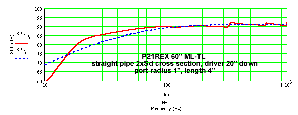

I don't have P21 HEX specs, but the P21 REX with Qts .37 and Fs 33 Hz would give an F3 of about 66Hz, so it's far from a perfect match unfortunately. If the P21 HEX has a higher Qts things would be better.
I see nothing fundamentally wrong with the design; it's actually quite ingenious and very much resembles the inverse case, a coiled folded horn, if you swapped the driver and vent positions.

There is no difference fundamentally between a TL sub and TL main as the vent is only supposed to pass low frequencies in both cases. What differs is that with a sub you just aren't feeding it any high frequencies.
Your redesign is OK, but you might want to consider if it's any better than a simple VB. The low Qts of your drivers won't let them energize the line down to it's 1/4 wavelength frequency, it really needs to be .5 or better to do so. A 55L VB will give an F3 of 38 Hz.
Even better is a dual chamber, 20L tuned to 55Hz and 40L tuned to 20 Hz will give an F3 of 32 Hz.
Considering the compexity and size of the TL I think I'd look to other alternatives with this particular driver as far as a pure sub is concerned.

Leaving aside the TL exit question, what BW are you looking to cover? The TL design you have should work OK, but the midbass will be missing in action. By this I mean there will be a phase cancellation dip from ~90-180hz. I briefly looked at it, seems to rattle on to 30hz or so, with a nice low Q rolloff knee. It might actually do ~25hz in room if you have one of those little brick english houses.
Here's another solution, depending on your room gain. It's simpler and has better impulse response. This can be tweaked to customize the low end rolloff to fit the room curve.
GB
GB
