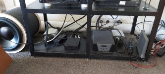

Mine is kind of based on the same design, only it has a 15-inch driver and the line uses pipe. I taper it by inserting smaller pipes in the final half. So a bit of a cheat taper. It's lightly stuffed because the HR result looked better that way.
