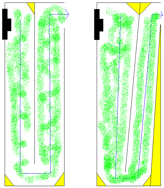

AHhh come on man 🙁 i thought i had this licked. Now you mean to tell me that Sd has nothing to do with the cross sec area ?
Say that a driver has 127 Sd . my box has inside dimensions of 10 wide 30 height and 36 depth. So i install the driver and start making a constant cross area line. I wouldnt set my divider at 12.7 approx ? That would be 10 x 12.7 which is close to the Sd of the driver. All things being equal, the volume in the box would stay constant with a few basket derivations if i swapped out drivers of the same approx diameter. So small Vas drivers and large Vas drivers would actually retune inside this constant line length Volume box? I actually stewed on this yesterday reading MJK's site and made an assumption, I thought that swapping drivers would only change the electrical characteristics of the motor itself.

I'll be real honest, I have no idea what the three posts above are trying to express. There are statements in each that make absolutely no sense, they are formed as statements and not as questions. I can only offer a couple of suggestions.
1. Sd = area of the driver cone. I use Sd as a convenient way of expressing the cross-sectional area of a transmission line as a ratio with driver size. I could just as easily use in^2 or m^2. Please don't place any significance on Sd, it is only used as a convenience so I can normalize and compare TL geometries for different sized drivers.
2. The length equations above are just wrong, I have no idea where you got these equations. Put them back wherever you found them. I suggest you look at Table 1 in my alignment table article to get a handle on the length as a function of area ratio.
3. Purplepeople, you have lost me completely with the fluids analogy. The air perticles in a TL are oscillating back and forth about an average position. I look at this as a vibration problem and not as a fluid flow problem. I can not make any sense of your rules of thumb for sizing TL geometry.

If Sd is just an expression of Cross sectional area then i DID understand. I panicked Dave said it wasnt. But i get the Vas. analogy as well. Interdependent. Anyway this is a dead subject for me. I am using what i understand and building the box. Tapered line- 66 inches heavy stuffing -2 turns -front exit with a 1/2 So. From that ill just play with stuffing.

Okay, a chance to get less wordy.
Drivers have a physical size. For example a 3" driver might have an SD of 5 sq in. But you cannot mount this on a baffle that is only 2" wide... the enclosure must be at least 3" wide. SD affects SL but only it's form, not necessarily its dimensions.
