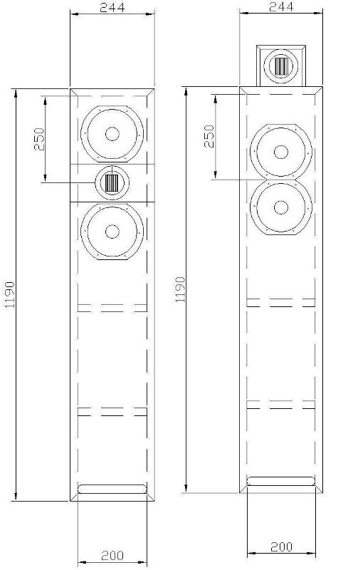

Vogo, your sketch of the ML-TL I described and modeled is correct except for the mass-loading port's length. That total length is 44 mm, so twice the thickness of the wall you're using. And, don't forget the stuffing in the top half or so of the cabinet as I stated.

Vigo said:I made a sketch after design information i get from pkitt ito see if i understod it correct.
I hope i get it right this time and that it is not supose to be any divider in the center.

Yes i remember the port and the stuffing i just did not put it in this very early sketch. Thank you for reminding me

Yes, the window frame brace is as you described it. I usually use that type of frame and depending on the specific design, I make the width of the four sides and the two cross pieces either 3/4" or 1". For this design, that would mean the four rectangular holes will each be about 2-7/8" wide by about 5-5/8" deep. With this increase in height and volume, F3 didn't go more than about 1 Hz lower, ending in the 36-38 Hz range.

Vigo, your sketch is correct but make sure the top of the second brace, the one used as a "stop" for the stuffing, is the correct distance from the top. Also, I feel it's necessary for a cautionary comment. I modeled with the T/S values as published by Tymphany, which you provided, and if the actual T/S values for your four drivers are appreciably different than those published, the model may not be as optimum as it could be.
Yes the second brace is but sow that the stuffing stops at 600mm from the top.

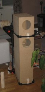

Me together with the material put together to see the fit of the mdf.
Looks bigger in real life then expected,

When i see the speakers size in real life i can see that it is way to high to put the tweeter on top.
This together with the input from pkitt made me decide to put the tweeter in the middle.

Vigo said:Sow far i have glued all the parts except the front. I will still mount the speakers and test the amount of damping before i glue the front on

Inside of the speaker with 3 support frames.
Speaker from the side, the front shield is made from oak.
