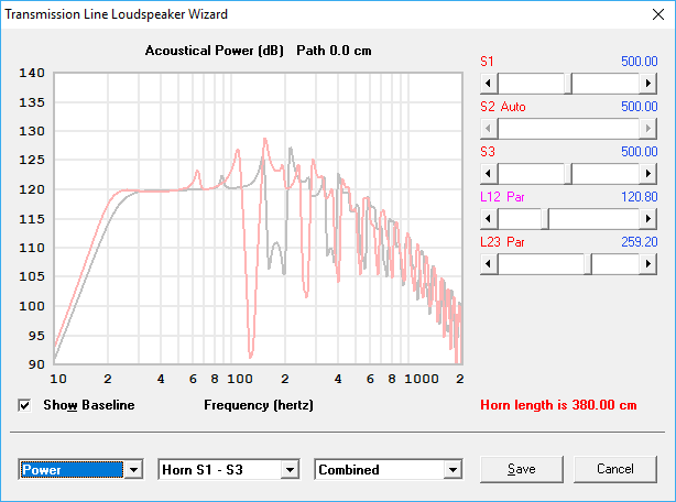

Tapering a TL (mouth < throat) reduces box size requirements and extends the useful passband, at the expense of some output capability and the increased possibility of vent compression effects at high output levels.
The exact opposite happens when mouth> throat.
Image: tapered offset-TL (grey) vs. straight offset-TL (red) with the same driver. Box size has increased from 114 L to 190 L going from tapered to straight.
That is some significant increase in volume but worth it if you're chasing bottom end. Assume expanding would be in the order of 300+ liters.
