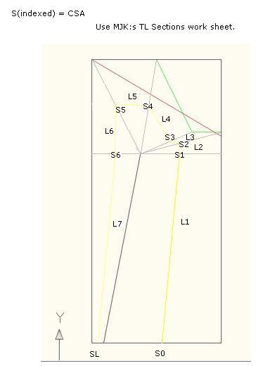

I'm building a TL and I was wondering which enclosure design is better. I would like to build the TL using the green lines instead of the red, but the red lines look like a TL MJK's Mathcad files can predict.
Will the TL with the green lines have roughly the same sound as the TL made with the red lines?
The picture is of TL that has a 10:1 taper with the 8" woofer ~29" from the bottom. The line should have a length of 80-90 inches, I believe the picture line length is ~86 inches. The inside of the enclosure should be 22" by 48" tall by 8.5." The reason I kind of want the enclosure with the green lines is because I want the mid and bass drivers close together since the speaker will be close to my head and I'm not sure how high I want to cross-over the bass and midrange.

Hi Jimmy,
No, It isn't ,See the picture where suggested interconnected sections are shown that can be entered into MJK:s Sections worksheet.
As you haven't placed the driver in your picture I had to start the area counting from S0 but in the reality you should start from the driver and go towards the closed end, then from driver to the open end to allow an acoustical model to be correctly designed.
Oops, I forgot about that worksheet. I have never used it.
The woofer is located next to L2. So my sections would start at S1 -> S0 -> S2 -> S3 -> S4 -> S5 -> S6 -> SL, would that be right? Or is it: S1 -> S0 -> S1 -> S2 -> S3 -> S4 -> S5 -> S6 -> SL?
I should check out the worksheet, now.
Thanks for the help. That worksheet was really useful because it simulates the differences in the placement of stuffing. The shape I chose didn't seem to matter much from that of a design with a top that is parallel to the bottom.
Oh that picture you made really helped me :hug: I might not have divided my sections into too few parts.
