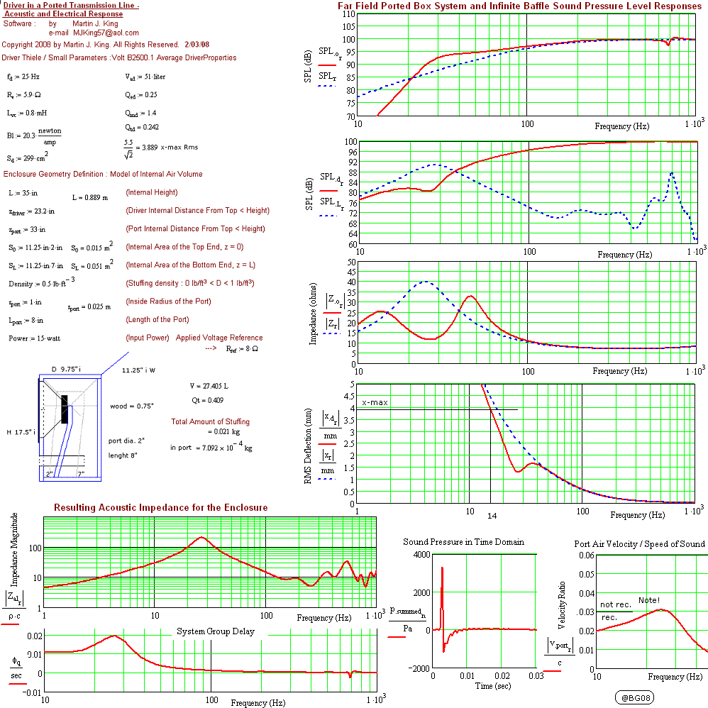

I want to build a transmission line enclosure for a Volt B2500.1
http://www.voltloudspeakers.co.uk/Loudspeakers/Studio_Range/B2500_1/body_b2500_1.html
Fs is 25Hz but has low Qts so i'm guessing a tuning freq of around 30Hz would be better.
A Tapered TL would need to be around 8 - 9ft long. I havn't looked at ML TLs at all. What kinda size would one of them need to be?
I would like to use a pair of these drivers to get even more power handling, although i realise that this would need a doubling of line area, and i think this would result in an enclosure being way too big.
any ways around this? Would a MLTL be smaller?
Has anyone already got any enclosure designs for this driver?
Thanks alot
Pete

A TL will ~mirror a driver's IB response, so about the only difference between 25-30 Hz will be size.
Hmm, a 10:1 25 Hz TQWT only needs to be ~70" long/~1.2851 ft^3 net.........
Due to the driver's low Fs, Vas and Qts, it's not as suitable for a low Fb as the TQWT and no smaller once you factor in the long vent required.
L = 70"
SO = ~67.2"^2
SL = ~6.72"^2
zdriver = 5"
stuffing density = 0.25 lbs/ft^3 of polyfil shown
GM
Ok, well that is fairly small indeed!
Quite pleasing really. So if i were to use two drivers i would simply double the cross sectional area?
So i would have:
L = 70"
So = 134"^2
SL = 13.4"^2
What is zdriver.

Well, what can I say, I was in a hurry as usual and I'd already done a design ages ago for this driver, so just posted it without really reading your post in detail ergo didn't notice you were planning to use two drivers.
Bottom line, make the pipe twice as large at each end and 'connect the dots' with the drivers at the top.
MJK recommends putting the driver at 0.336*L = 23.52" down and while its marginally smoother to ~200 Hz, this is a sub, so end loading yields the most gain up to ~110 Hz.
