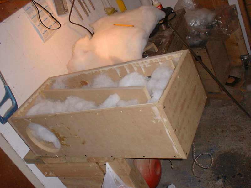

For the stuffing inside the TL, theres 0.2 lb/cuFT of that stuffing, I chose stuffing that has long strings, but when i get the tl standing up, the stuffing compressed a bit, I'd imagine it'll get worse when theres bass.... any ideas?
and I cant really figure out the SD from front and rear,
I'm using Martin J. King's software wich is brilliant to make my TL
www.quarter-wave.com (awsome stuff!!)
I have a pic, here im still stuffing it.

Hi Ilianh,
Thanks for the positive feedback!
If you draw a line down the middle of the path from the closed end to the open end, then the area of the line is the area normal to this path. In your case, at the closed end it is the internal width times the internal depth from the front baffle to the divider. The standing waves will occur along the length of this line.

Hi Ilianh,
I am not sure if I completely understand your question. So if I miss something please ask again.
To understand the input needed for the TL MathCad worksheets I recommend downloading the application note. In this note the TL path (length) is defined and the various cross-sectional areas are shown. The path is a straight dotted line that runs the length of the TL from the closed end to the open end. The areas are shown as dashed lines. All of the TL worksheets model the enclosure shown in the figure.

Well I'm only trying to figure out what SD at closed end, and SD at open end really means...
I just want to make sure of something...
Is it the tapering ratio?
that means the TL in you application notes is 1:1?

Hi Ilianh,
OK, let me try again. The area at the closed end is denoted by S0 and the area at the open end is denoted by SL. Traditionally in TL design discussions these areas are described as multiples of the driver cone area Sd. So for my straight Focal TL shown in the application note :
S0 = 3 x Sd
SL = 3 x Sd
This is a way of normalizing the line area so that designs can be compared when different drivers are used.
When you are entering data into the first page of the MathCad worksheets, you can put the area in as a multiple of the driver cone area Sd or as the actual physical dimensions. In almost all of my worksheets you only need to enter data on the first page. The exception to this rule is the more general "TL Sections" worksheet. The taper ratio TR is calculated automatically from S0, SL, and L on the second page and does not need to be defined.

Ahhhhh... ok
thats better now..
ok thats what I tought at first, but then I realised it could be some else... ok, well Thx alot!
