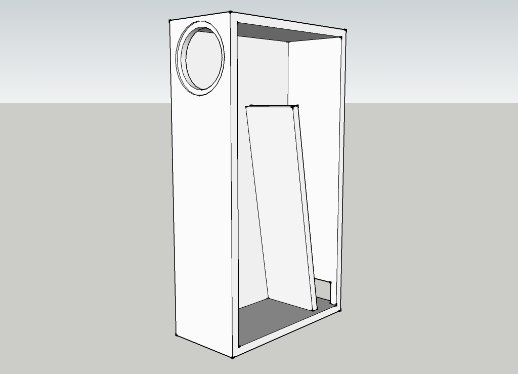

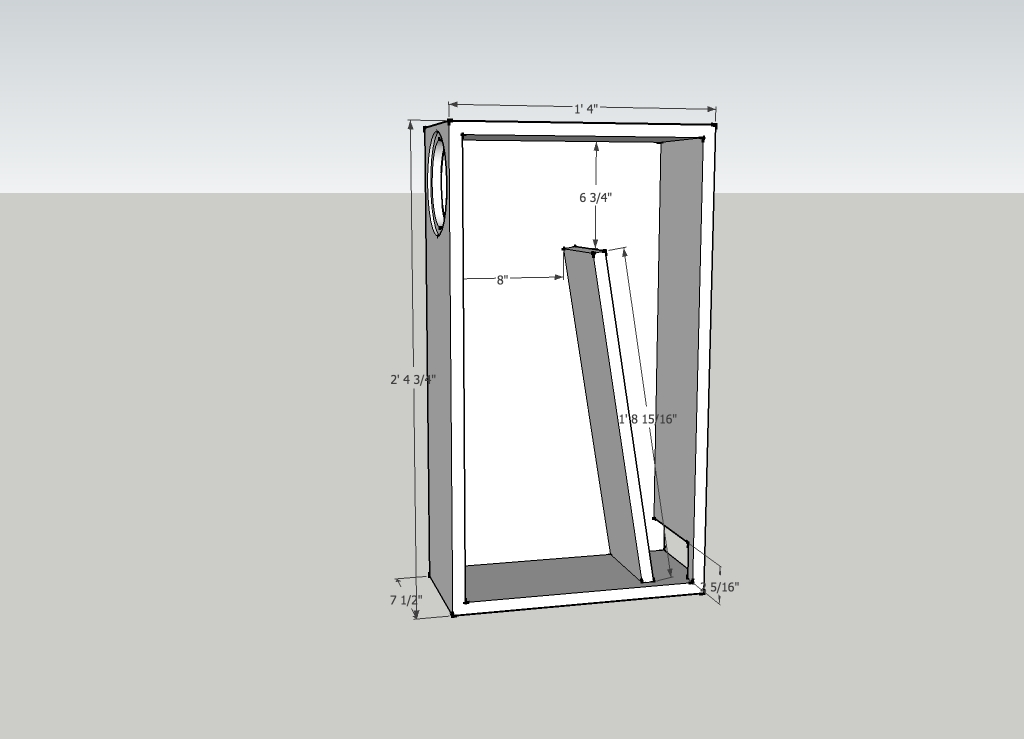

FWIW, I'm working on a folded TL for the W5 using Henkjan's TL spreadsheets. The tuning will be the same as the W5 Tabaq, under the assumption that the performance will be comparable. I'm motivated by the desire for a shorter, more diminutive cabinet.
...And here it is. 1/5 taper, 43hz tuning. Very compact albeit deep. A SUPER XL desktop TL, as it were. 😉

Nice pipe. Hey Chaz -- will these be floor units like your OB design was? Just thinking maybe you might want to tilt the baffle back so that you get some HF when seated a ways away. That's one mistake I made when I made a small floor box. FWIW.
Good point, and yes, I'm thinking of at least propping the speakers up from the front. It would look really nice to build them with a slanted baffle though.

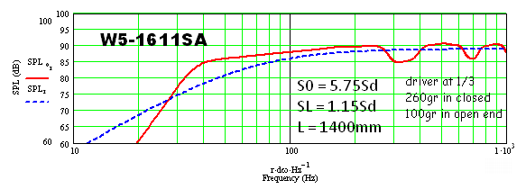

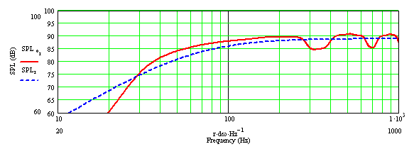

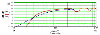

Henkjan, many thanks to you for running those simulations. The 5db dip at 300hz seems too deep and broad to make this a really good design; will changing the taper of the TL have any significant effect on that? If not, maybe I'll still give this a try just to compare it to my DBR design.
1st: in real life, these dips will be less than simulated.
if the taper is increased, then the line length will decrease (for a given tuning) and the frequency of the dip increase, increasing the effectiveness of the stuffing in eliminating the dip. lower tuning will have an effect in the same direction. I'll do some additional runs later in the week.
Perhaps 43hz is a little too ambitious for a tapered line. Maybe a higher tuning is the way to go, say 48 or 50hz?
By the way, when I play around with the worksheets (in this case, the W5 driver with 50hz tuning in various iterations) I tend to get cabinets that are very short and deep, sometimes deeper than they are tall. changing the taper doesn't seem to do much. Am I doing something wrong?

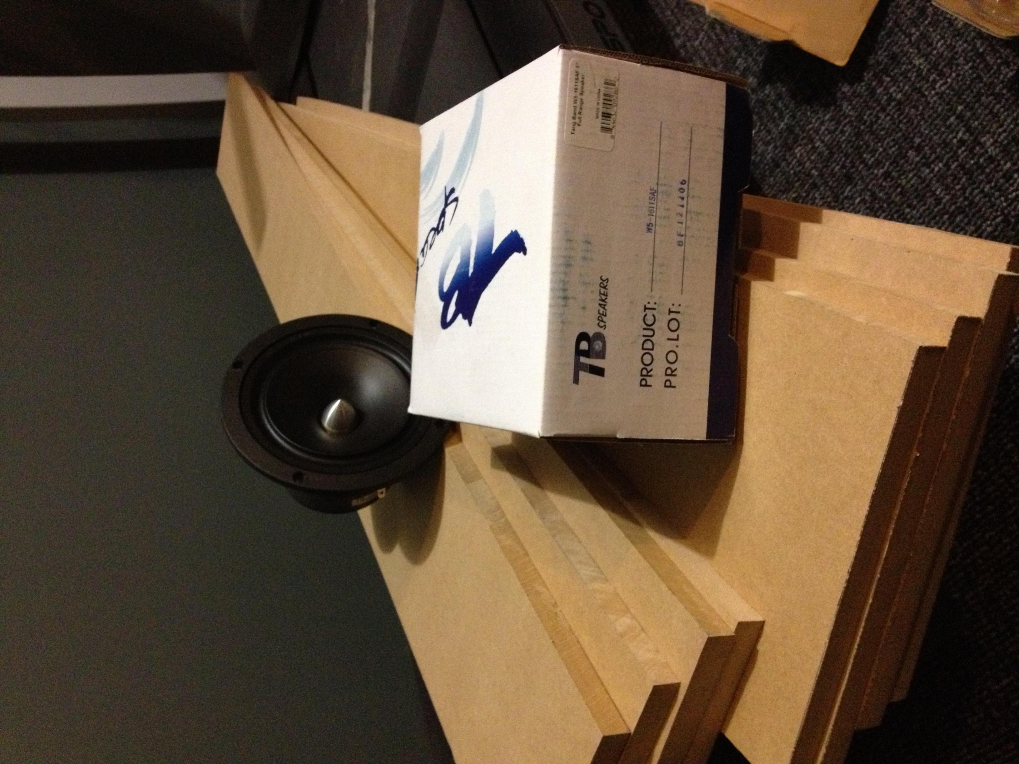

Gonna have a crack at the TABAQ
I've got my w5 TBs and my front and sides cut didn't have enough off cut for the top and bottoms will need another trip to the hardware store
My local only had 16 mm MDF so I made the necessary adjustments to keep the same internal dimensions
Question will it effect the boxes tuning if I rounded the port opening and front edges asthteticly I think it would be better
What about stuffing it mentioned it need some in the top third what would be best to use
