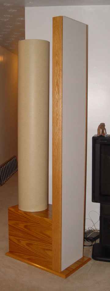

Allow me to jump in. Would you call this TL, because of the box on the bottom.
Dimension of the box is 22"x17"x13" and tube is 10"x58" everything filled very
dens.
Woofer is 10" Peerless, Fs 22Hz. Reading about TL enclosures I come to
conclusion that there is no sure thing in design, so I took a chance and used the most
length I could. Sound is OK but I think little boomy for my taste. It could be my
room or maybe electrostatic panels aren't efficient enough to mach woofers or the
box itself makes that sound. What do you think?

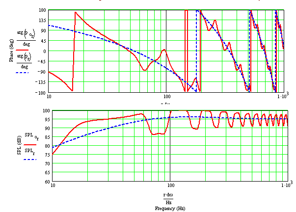

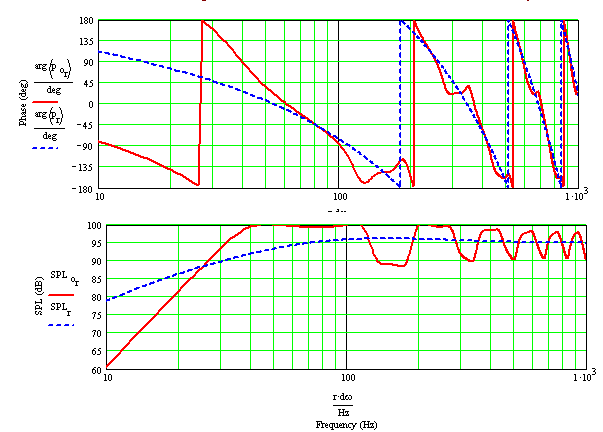

I have tried reading your information article but they are just too advanced for me. Could you give a brief rundown on exactly how to use the worksheets?? I figured out so far the blue line is some sort of reference, but what does it reference? And then all your driver specs end in a d instead of an s, ex fd instead of fs.. I asume that it is the same thing as the fs, vas, qes, qms and so on that come with the driver? somewher else smeone suggested a woofer with a .Qts from .5 .. 1 and I have been trying to model a driver with a Qts of .38 with some odd results, namely I cant get the redline to go over the blue line below 100 hz in the closed end worksheet. Is this just a poor choice for a TL design?
I alo shave 2 8" JL-audio 8ib4 drivers that are made for free air use. would a driver such as this which needs a massive sealed box be a better choice for a TL design? This driver did not come with the Lvc or Bl specs.. can I fudge this somehow?
Thanks for any and all pointers !!

Hi Jared,
Looks like you are making progress and starting to understand how to use the MathCad worksheets.
Dave has provided the key to translating from my terminology to the traditional terminology used in speaker building. I use a "d" subscript and the rest of the world uses a "s" subscript. My crazy terminology dates back to my first set of notes on speaker design from 20+ yeasr ago. Unfortunatley I have stuck with my own subscipts and never invisioned people using my work on speaker design. My appologies for the confusion.
The TL Open End, TL Offset Driver, TL Sections, and maybe ML TQWT worksheets are the ones you want to work with. The TL Closed End is for a TL that has a closed reflecting terminus and I originally set it up to model the B&W Nautilus speakers. As far as guidelines on how to use these worksheets, my recommendation is to play with them changing one parameter at a time until you get a desirable response. There are many different design possibilities and no absolutely best design.
The curve definitions can be found in the plot titles. I usually plot two variables as stated in the title. The first variable is the solid red curve and the second is the blue dashed curve. In the plots you have provided, the solid redcurve is the total TL system respone and the dashed blue curve is the same driver mounted in an infinite baffle. The infinite baffle response is provided as a reference to show what the enclosure is doing for the design.
Hope that helps,
thanks very much for the reply. It is re-assuring to know I have all the corect driver specs entered. I feel like I am threadjacking, even if it is on topic, so Im going to limit myself to one more question.. If I do not add stuffing, and leave the design with the ripple, and low pass it at ~80 hz will th eripple cause any problems? wont it be at such a low magnitude that it does not afect anything??
