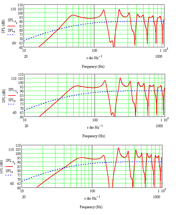

In a TL alignement with SO = SL, if the (constant) cross-sectionnal area is diminished, what would be the effect?
I would think it'd increase the acoustic impedance, further load the driver and add some damping to smooth the low frequency peaks, at the expense of LF output. Does that make sense or is it another story completely?

I mean a non-tapered line, thus SL = SO. By "constant", I meant it "constant throughout line lenght", sorry if it was confusing. What happens if the cross-section is diminished, so both SL and SO would be made smaller by the same ammount, leaving all else unchanged.

Well, like anything else, a TL needs a minimum volume (Vp in this case rather than Vb). The pipe always resonates at a specific frequency determined by it's length; that's inherent. However, as you reduce the CSA LF output will become progressively 'strangled' by the lack of volume. See the attached -undamped of course, for clarity. Once you start damping it, things just get worse.

Can you tell me what was the magnitude of the CSA change from top to bottom graph in your example?
I would have been looking to diminish CSA in my alignement to 25% of what the MJK alignement prescribes. Might be a tad much.

Those were very much generic, so don't expect the same to apply in all situations. For information though, the lower graph shows a pipe 1/3 the volume of the top. Mr Sod's Law decrees that demonstrations never turn out as well as you'd like, and in this particular instance, the length / CSA / driver I happened to use probably weren't the best examples. Remember too, that things rapidly get worse when damping is added to the smaller CSA pipe.
Less obviously, what the machine doesn't show in addition to the above is the severe subjective 'strangling' that the undersized pipe causes once damped sufficiently to smooth the response out to an acceptable level, particularly WRT dynamic BW & transient attacks.
25% is a pretty hefty reduction; I'd be very cautious there. As well-known an engineer as Joe d'Appolito fell foul of that one when he designed the Thor TL for Seas. Bad idea.

Yeah, I thought it was kinda steep. I would have liked the outlook to be a bit brighter, as material availability and cost would blow this project's low price point aim through the roof were I to stay with 100% prescribed CSA. I'll look into other solutions.
