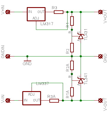

ask to calculate r Value
Hallo.
i want to ask anyone whose know
how to calculate R
(R1,R2,R3 /R1A,R2A,R2B) value of combination Reg LM317/337 and TL 341
i plant to use for reg +15 -15 output current 300Ma.
input volate +- 20V dc
output 15V
this the schematic.
please heelp anyone.
thx

Re: ask to calculate r Value
first download the datasheets for the 317 and 431.
Set the 317 (CCS) to ~= Iload + Ishunt.
Then calculate according to the datasheets.
Hi,ridwans said:
how to calculate R
