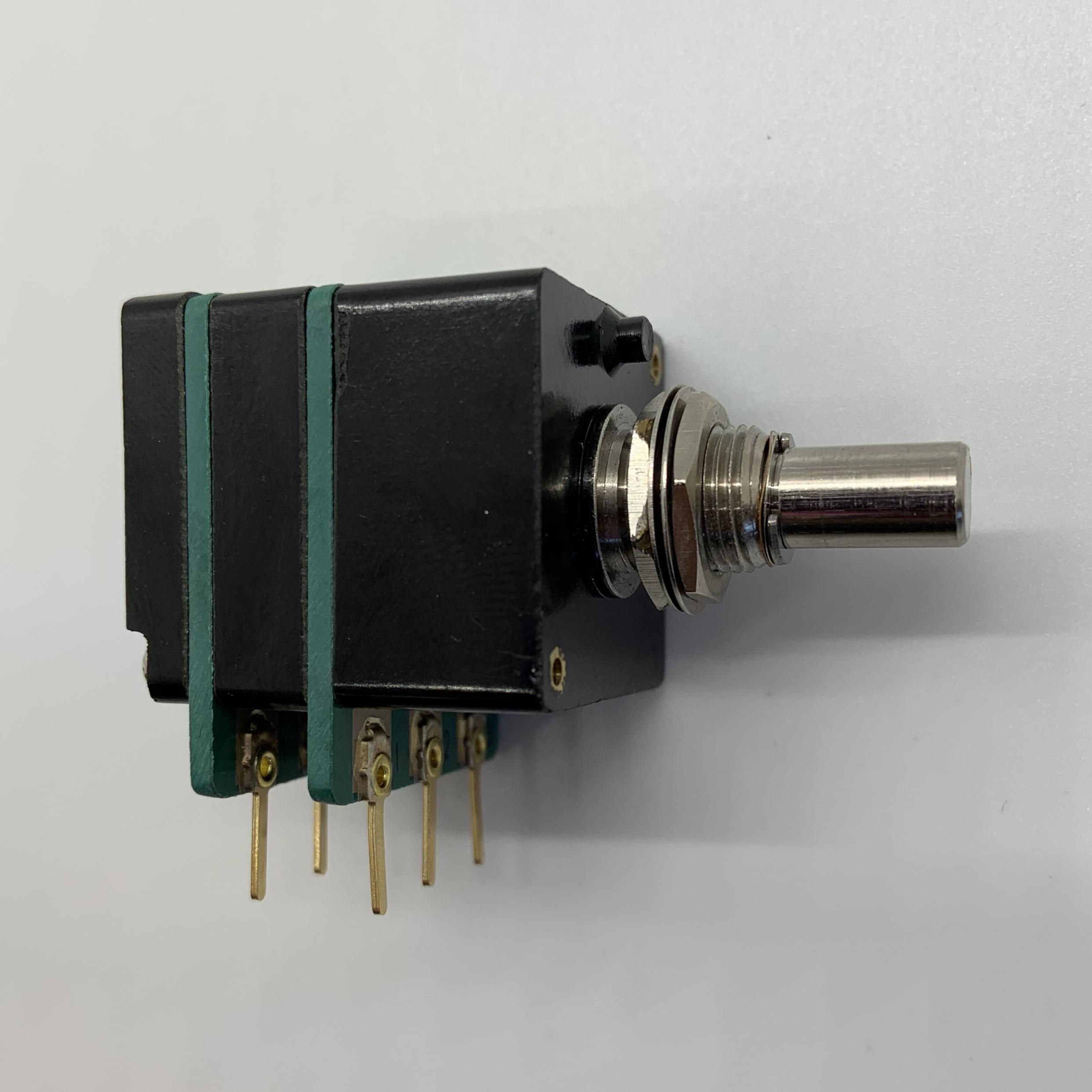

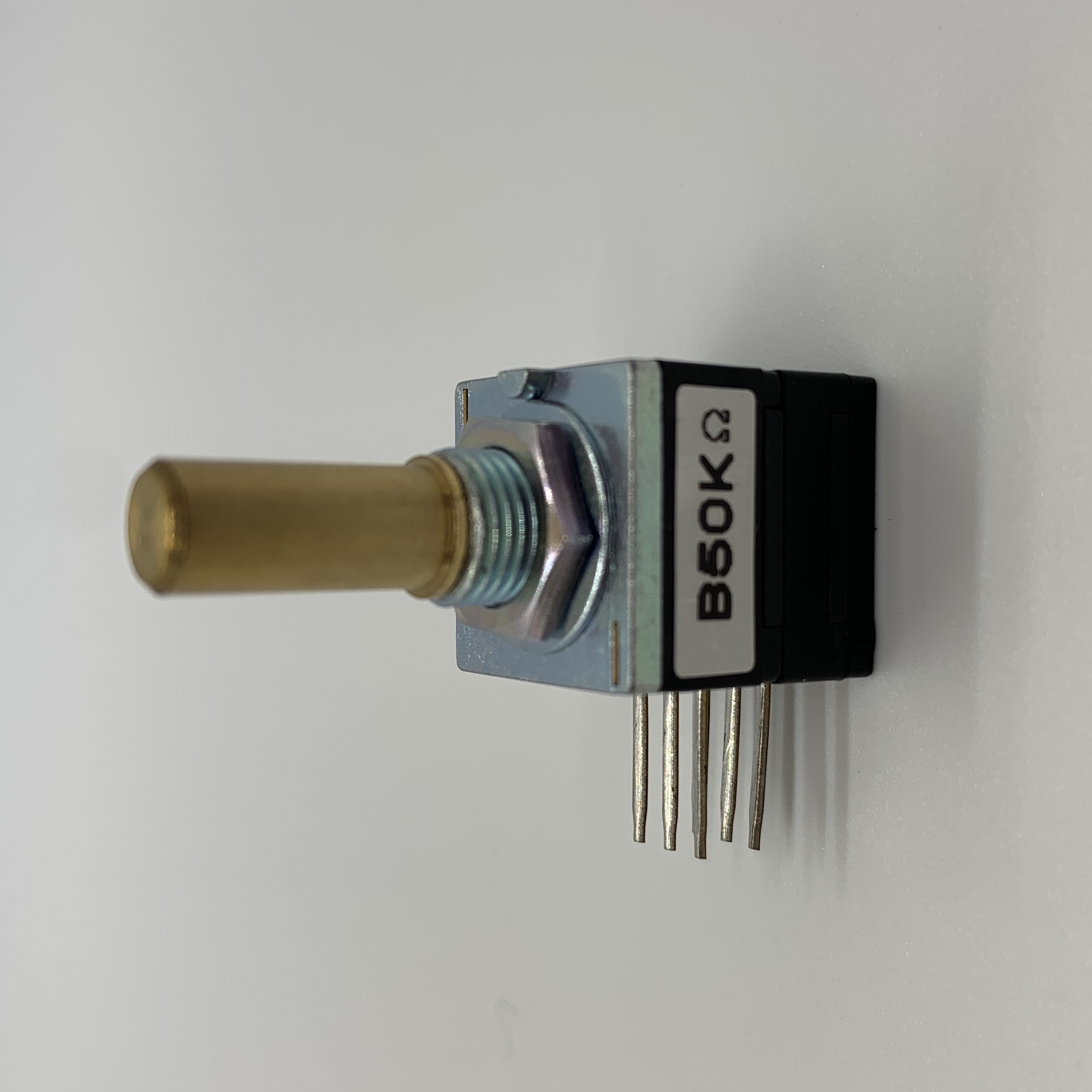

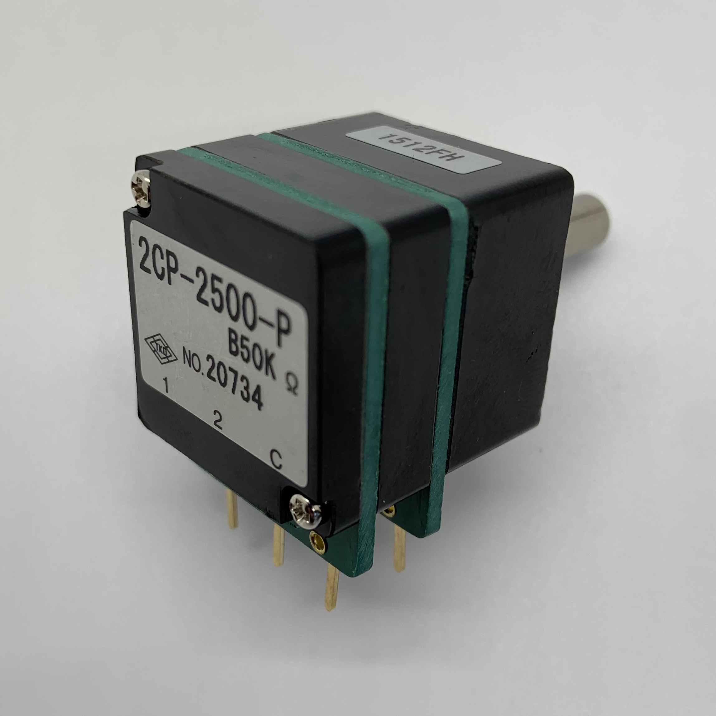

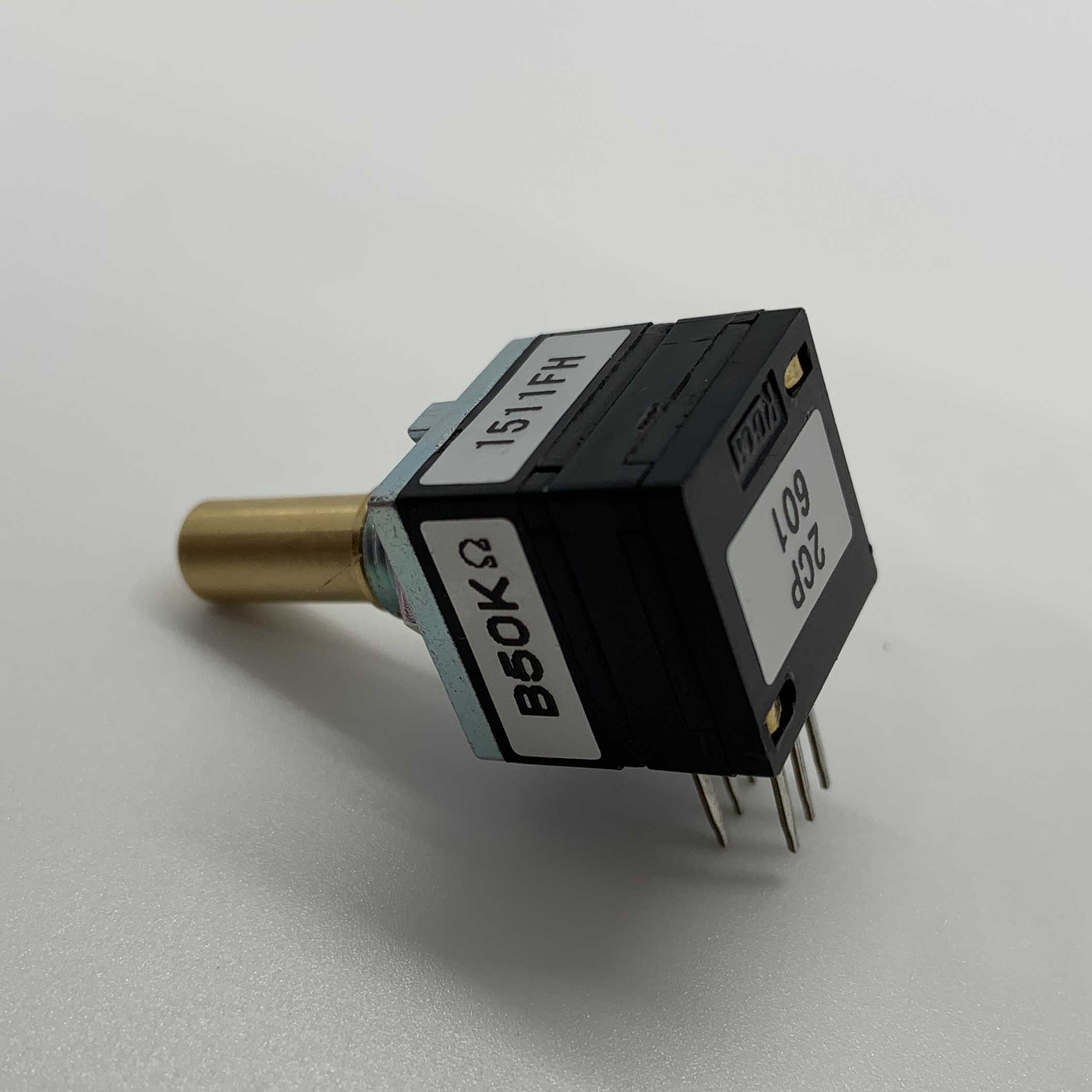

I have a few TKD potentiometers available. All of them are dual linear taper 50K resistance made with conductive plastic. These have been installed once, but never used. Pricing is $60 for the 2CP-2500 (25mm size) type and $25 for the 2CP-601 (16mm size) type.
As of 04/02/2025:
QTY: 17pcs 2CP-601 50k
https://www.tkd-corp.com/en/products/pot/cp600p-spec.html
QTY: 1pcs 2CP2500-P
https://www.tkd-corp.com/en/products/pot/cp2500p-spec.html
Shipping in the USA is $5 via USPS and outside of the US will be rated based upon location.
