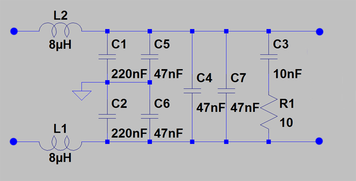

The ouput filter was changed to WURTH SMD high current inductors, 10 µH, the caps are now 470 nF film types from ELNA, and the differential cap is now 100 nF from ELNA too. Please all note the SURE original values are wrong and give an unuseful lower cut-off frequency.

At first I thought it could be a problem with the transit time of the output filter that was favoring too much the highs. But then I recalled that the output filter does not work at all in audio band but is just there to clean the noise. Even if its Q factor was miscalculated, the overshoot would be well after 20 Khz, probably 4 or 5 times more.

And someone who wasn't that satisfied with it at all, through this 'customer' of yours I discovered even the charge current of the battery wasn't taken care of properly giving a 25% overcharge on an SLA. That's fire and/or explosions waiting to happen in someones livingroom! If you haven't even got the knowledge of electronics to get that right how come you think you can start to mod a class D amplifier?? Let alone the output filter section!!
I know it is super cool to mod, hearing the differences in sound appear and gaining some experience with electronics. Only you won't become half as good in the matter as when you study the basics first. Actually you shouldn't even start modding until you have at least gained some knowledge on safety.
Then if you are a nowbie modder, start at the place that does the least harm, the power supply section and input section. The effects of mods are great there and at least don't turn it in to a hazard that quickly.
Then if you are brave and most of all wise enough to work on the output section you must have basic knowledge of radio frequencies, transmitting, parasitics and last but not least power.
