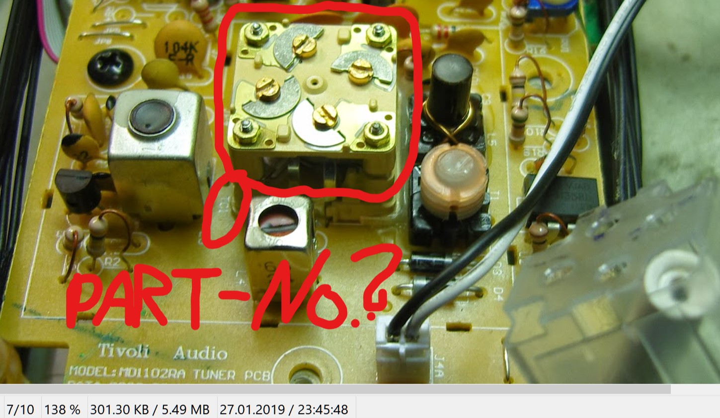

I searched now for hours to find an original PartNumber. No found.
In every that i find are the speak from different values....an no one had a 100% identification.

Why do you want this? If the reception is erratic, you just need to exercise
the tuning capacitor for 10-100 times in full rotation to redistribute the lubrication.
There's likely nothing wrong otherwise.
I do all what I can do before.That is a lot i can ;-)
The part is defenitly broken.

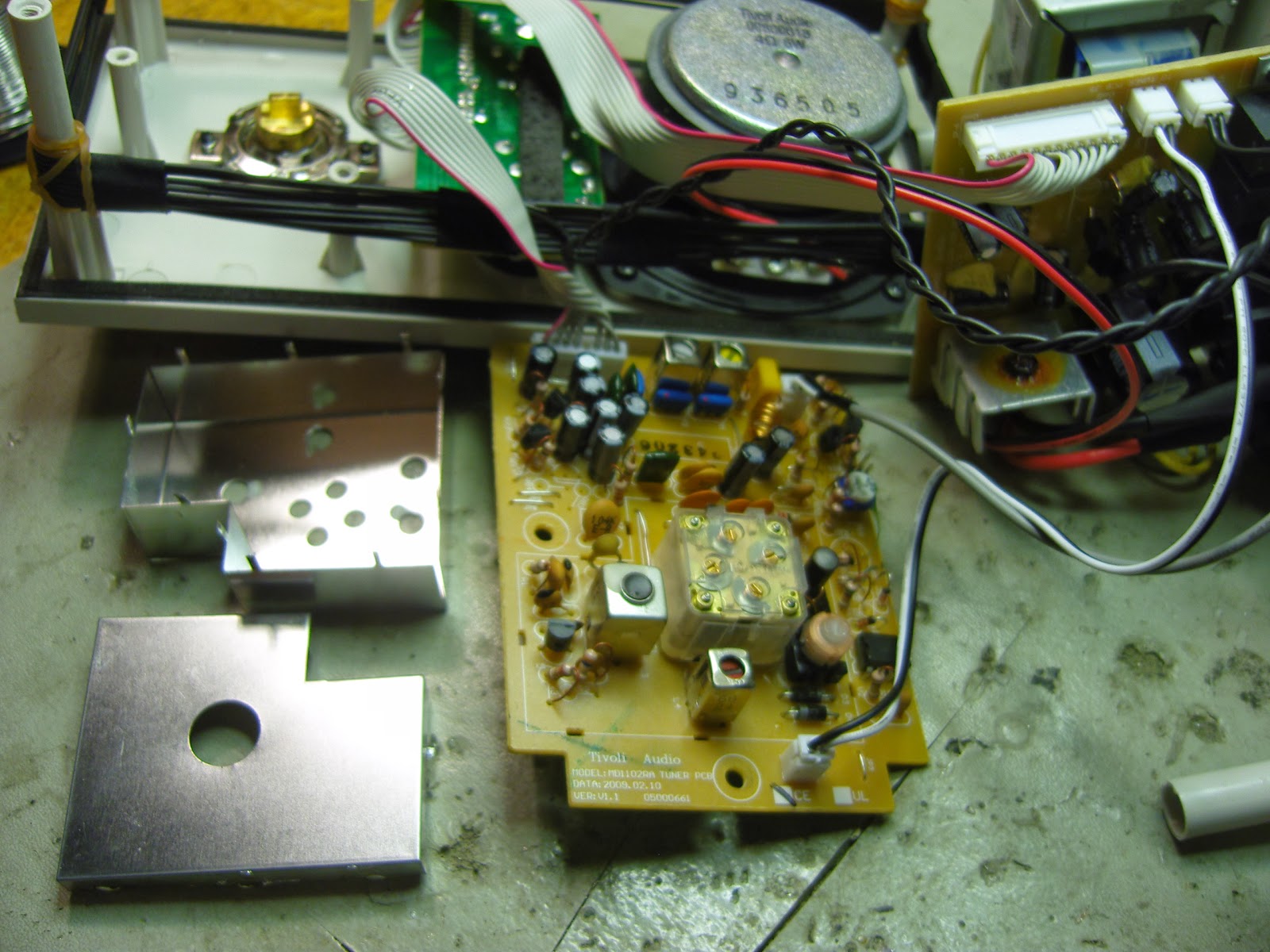

I do all Tips before I searched the Net and writing my Post, but it doesn,t work.
I´m a learned Technican I like repair professionaly.....you know?
Please no tips from Google here.. I know them ALL for Tivoli ONE.

No Spare Parts from Tivoli Audio available
Info from 06.02.2019
Tivoli Service linked to an German Service Partner to ask for Spare Parts.
This Service Partner tells they only repair or change the device.
No Spare Parts available.

Tuningcapacitor Tivoli Model One, Two and Three
The part number of The tuning capacitor for Tivoli Model One, Two and Three is ACC-9622 But Tivoli stoped Selling them a few years back.

You need to find out the capacitance of both sections, but this is a standard pattern AM/FM tuning capacitor, like AM / FM Radio Film Variable Capacitor 270p Dual + 20PFM Dual CBM 443BF|capacitor variable|capacitor radio|capacitor film - AliExpress
Figure out what chip that board uses and look up its datasheet, it will probably have an application circuit that's a good guess for the Tivoli.
Then you'll have to figure out trimming the thing so the dial is accurate.

You may be right about the values but the one on aliexpress is not possible to fitt on the board of Tivoli radio, and the prize is way too high.
The last prize from Tivoli was about 8 to 9 usd.

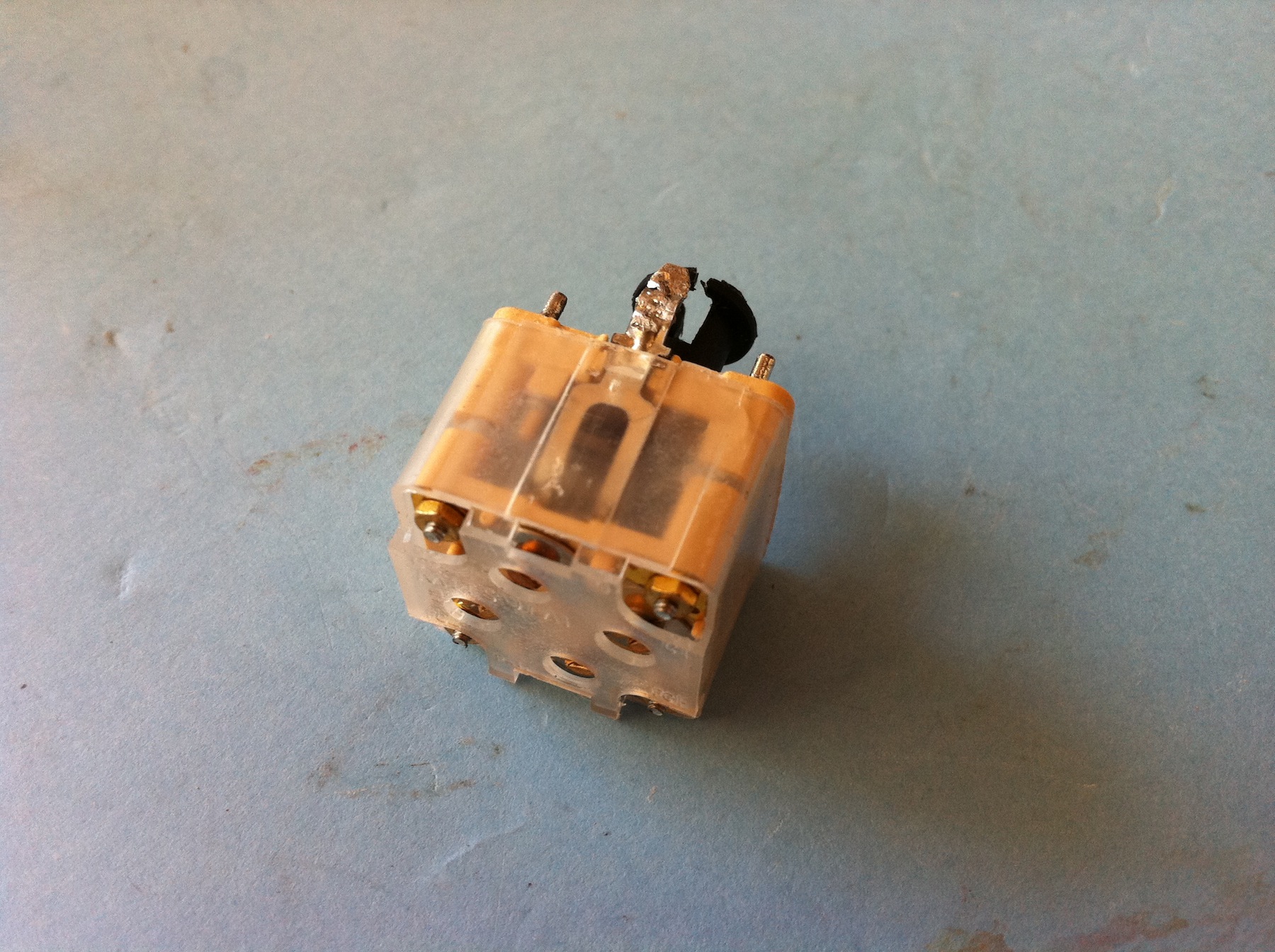

I have two of these. The older one (w/o the AUX in) only has a minor case of this disease. The newer is almost unusable.
The problem, as everyone knows, is that the rotor's ground connection is made through the mechanical bearing. Back in 60's these condensers used a coiled metal strip - sort of a 1-turn hairspring - that was soldered to both the rotor shaft and the ground pin. This assured connection between the rotor and ground.
I took the condenser out of the newer unit and cleaned the bearing and then applied a drop of Nye's Clock Oil. That helped a lot. But after a few months the problem started again.

This is a Mitssumi Polyvaricon 2LHT-L5No Spare Parts from Tivoli Audio available

We owned a Tivoli one some yrs ago. A look into int lets me shudder: cheapest far east transistor radio technique originating from the sixties.This is a Mitssumi Polyvaricon 2LHT-L5
