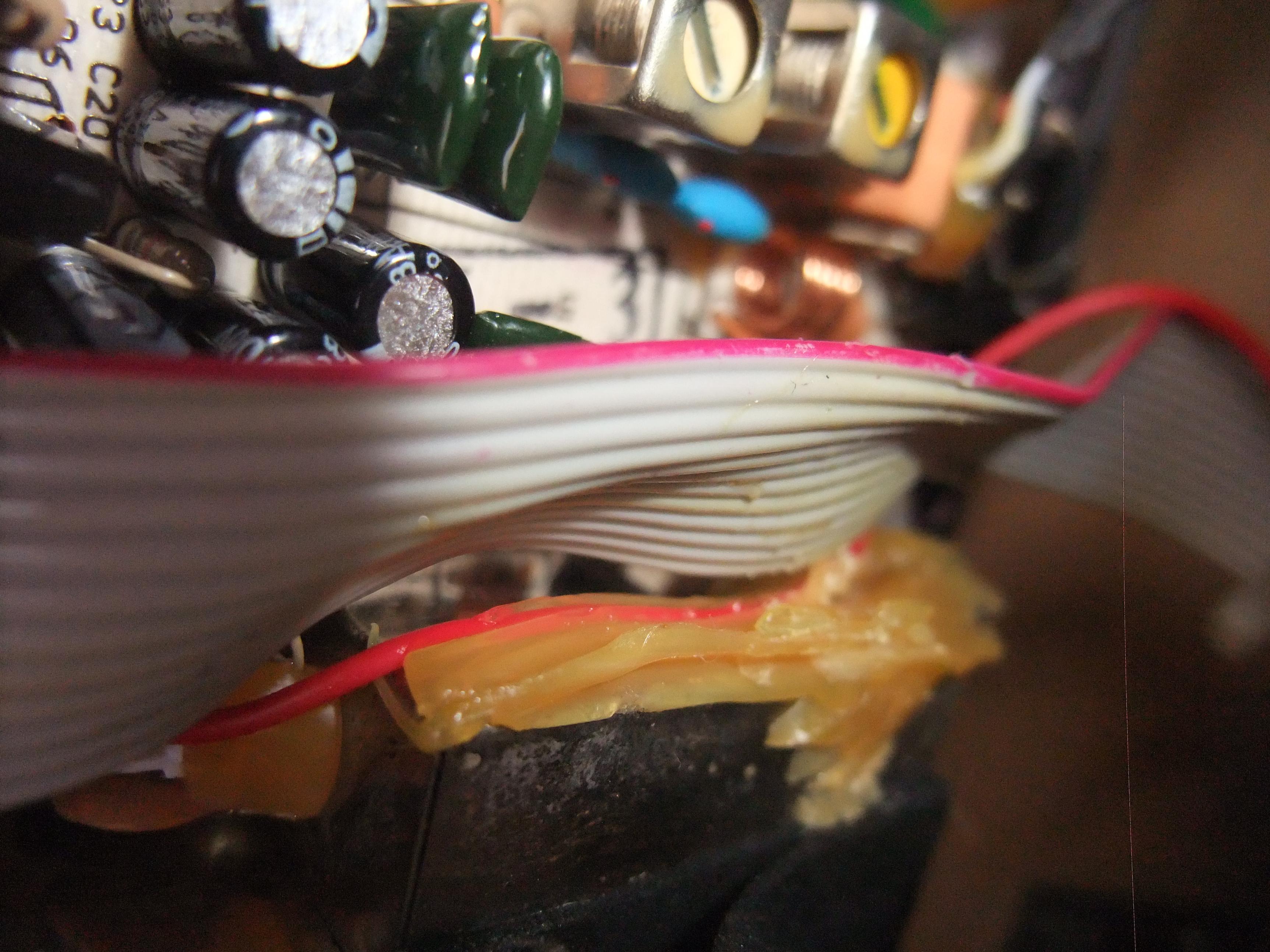

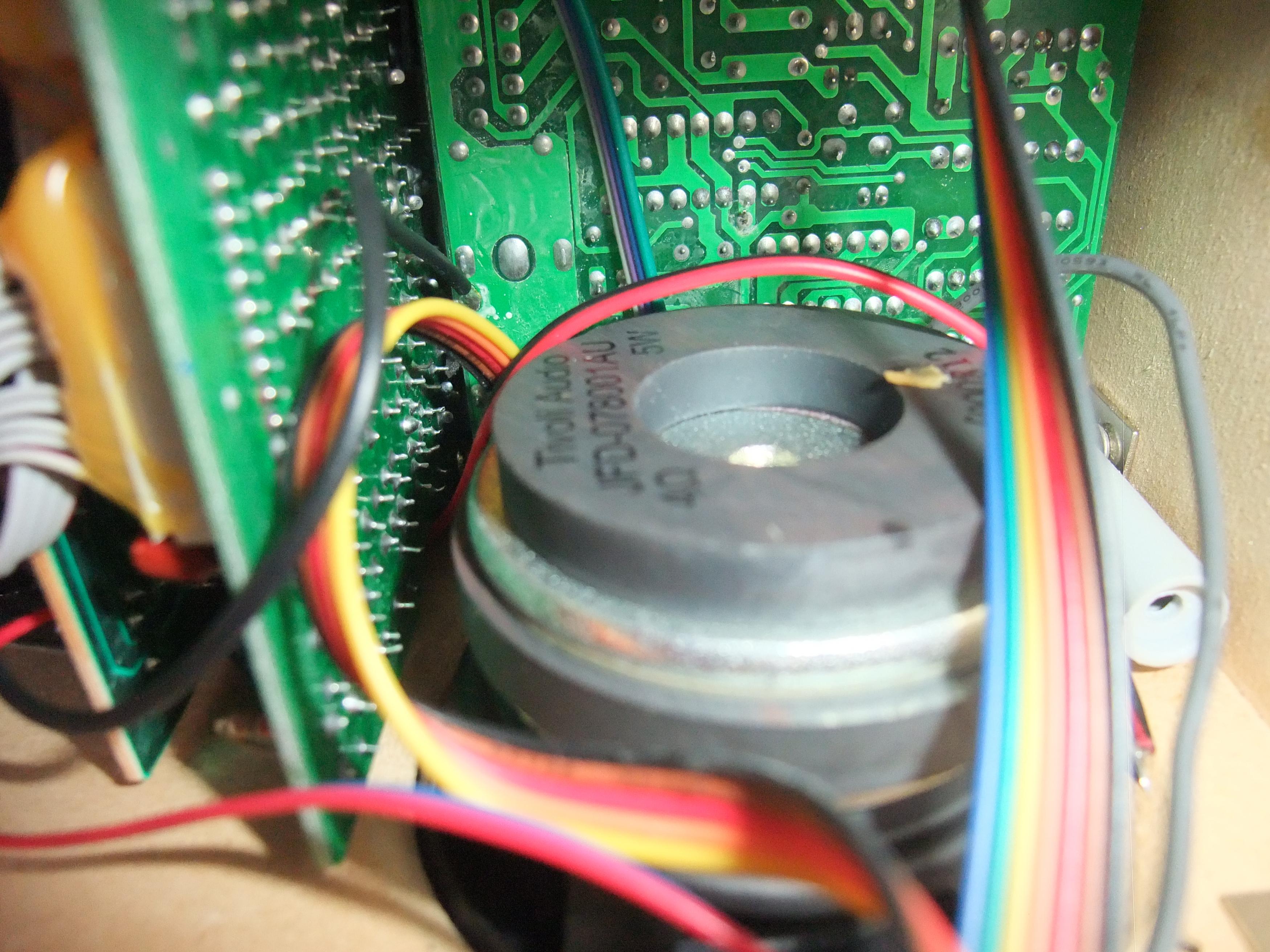

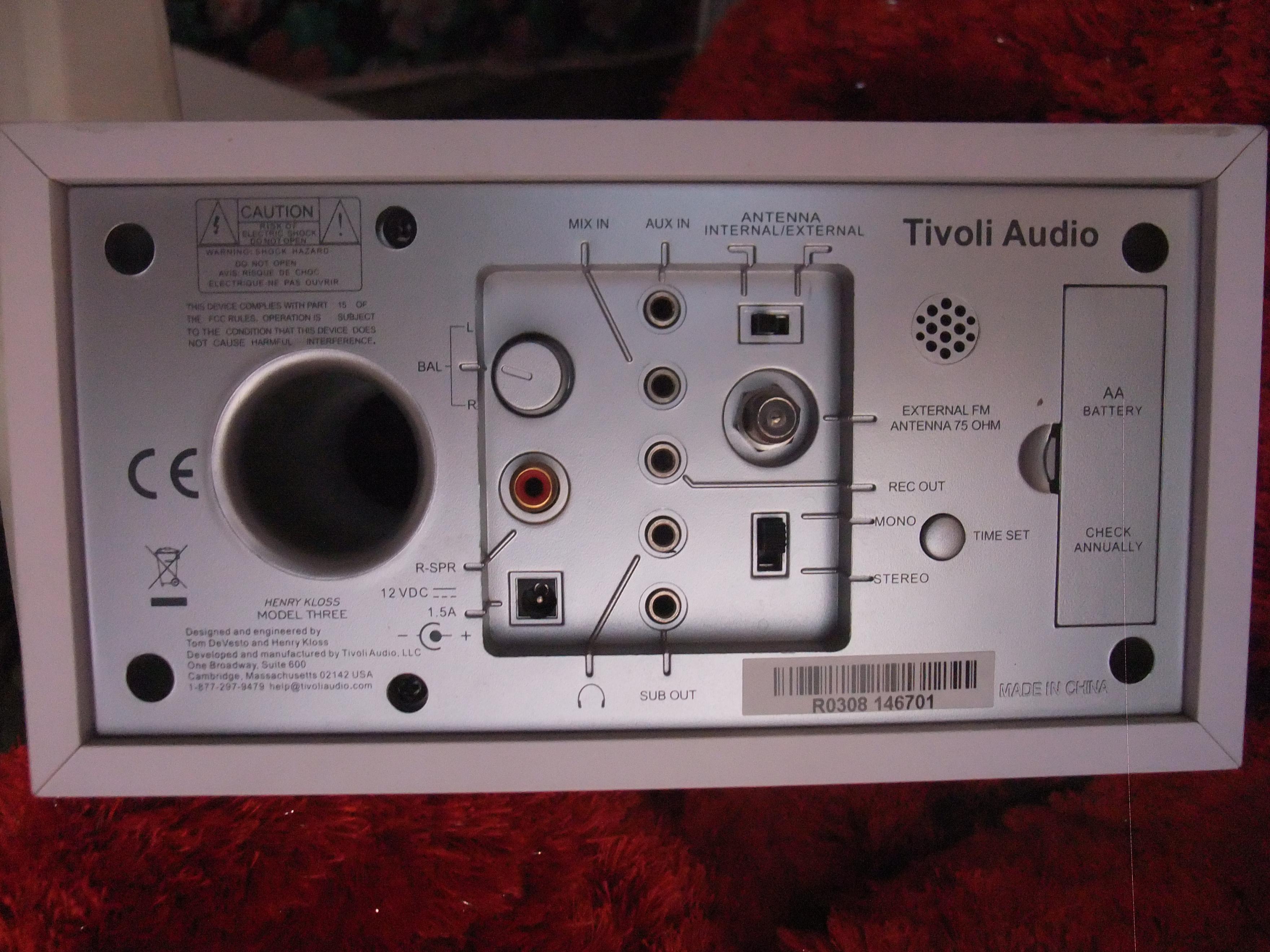

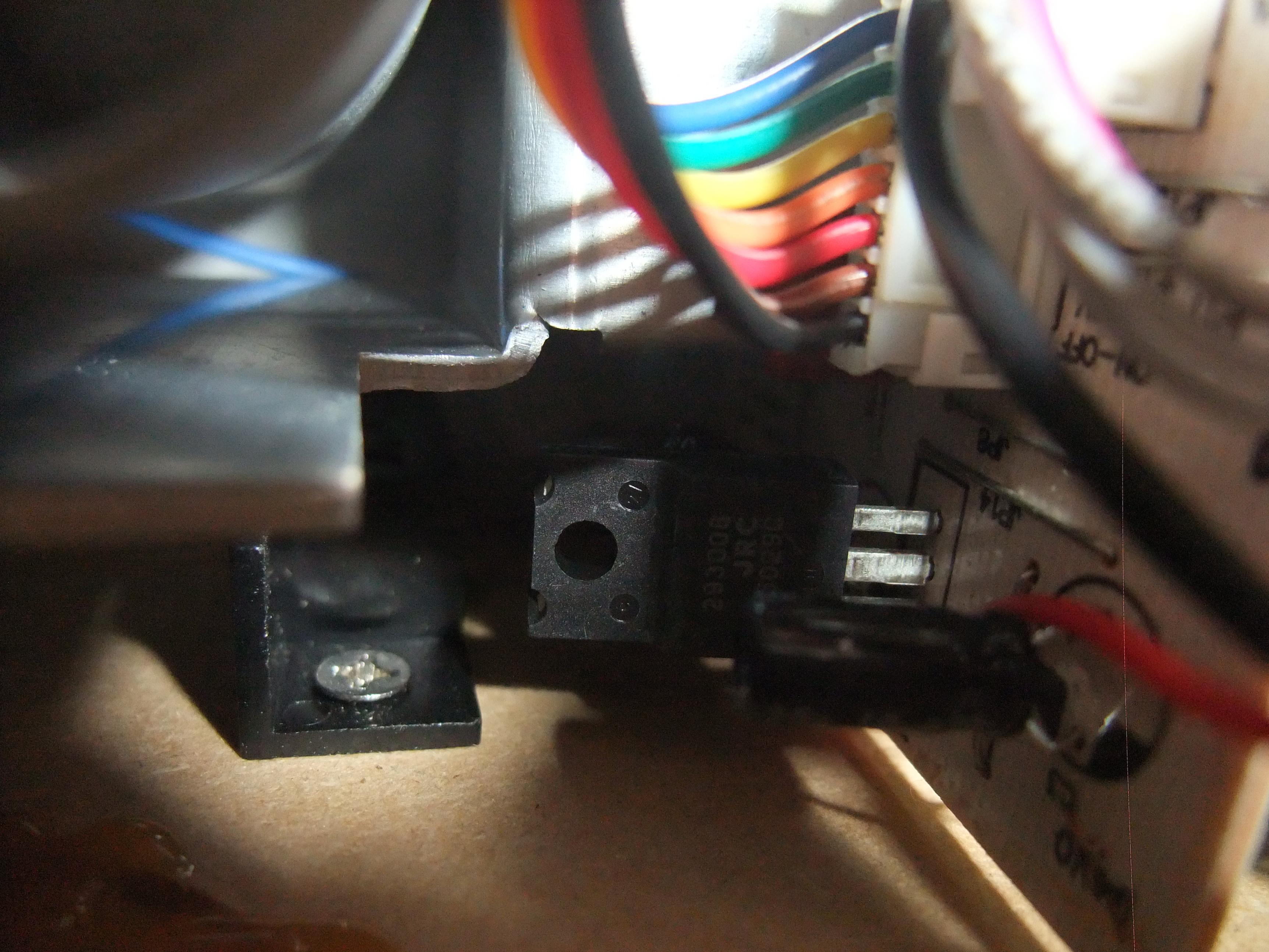

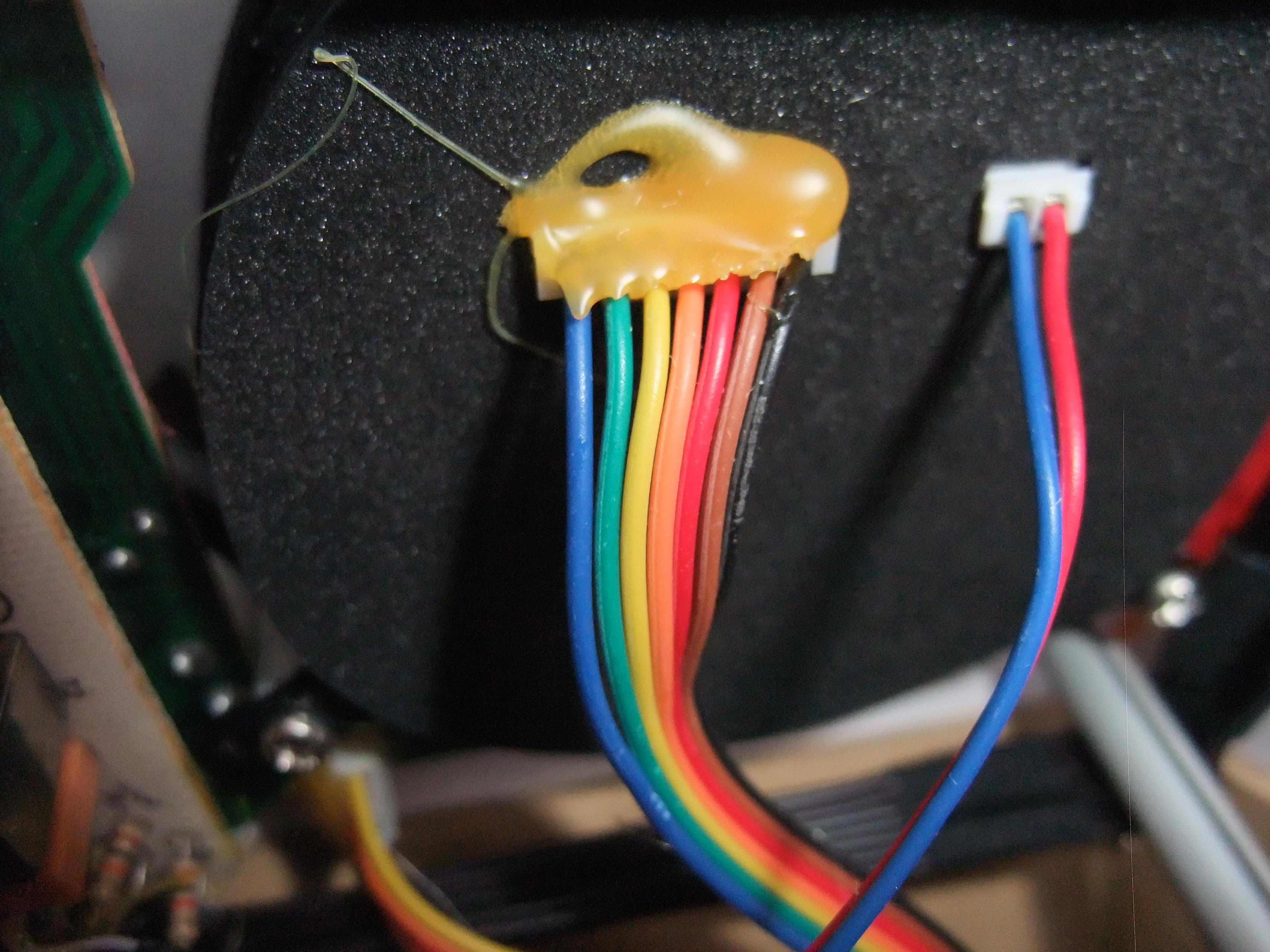

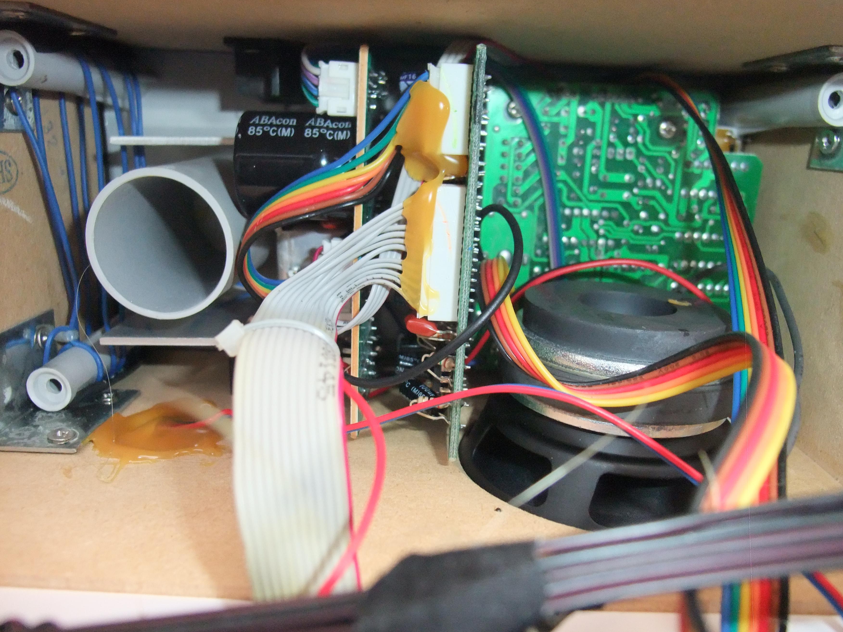

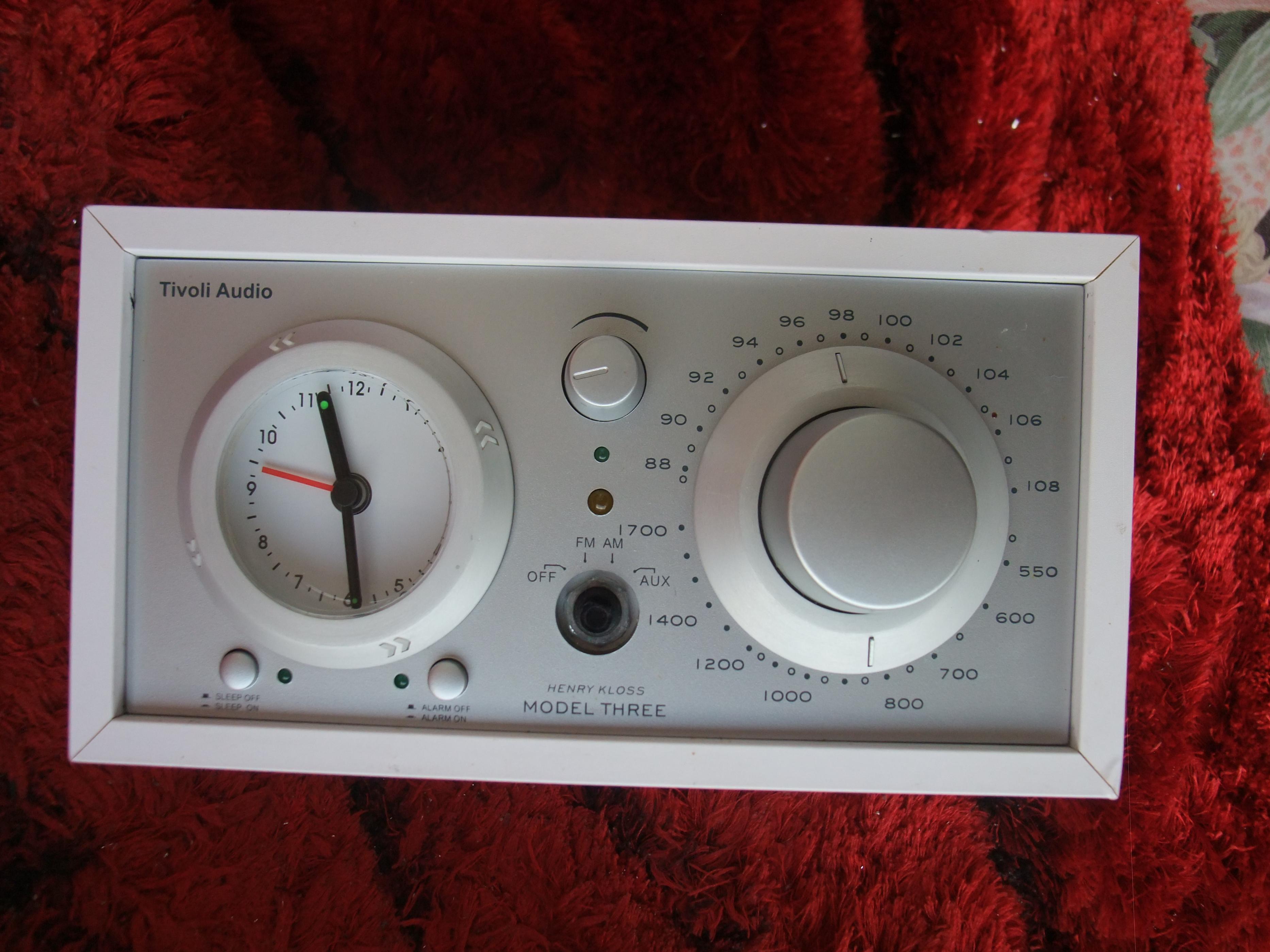

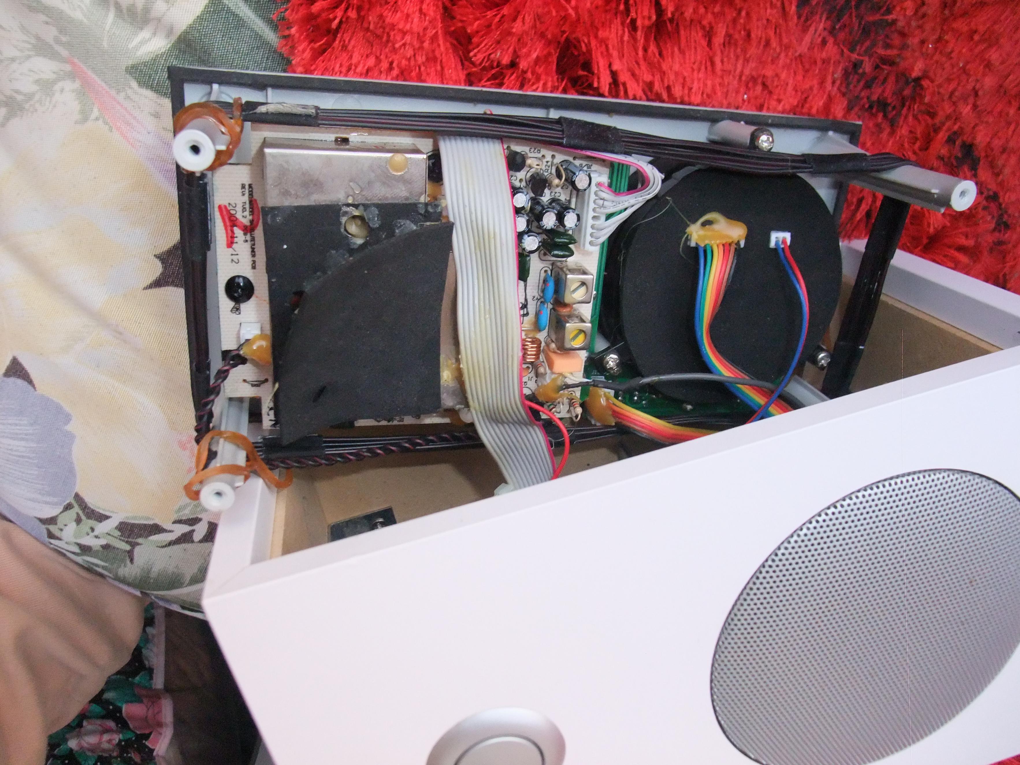

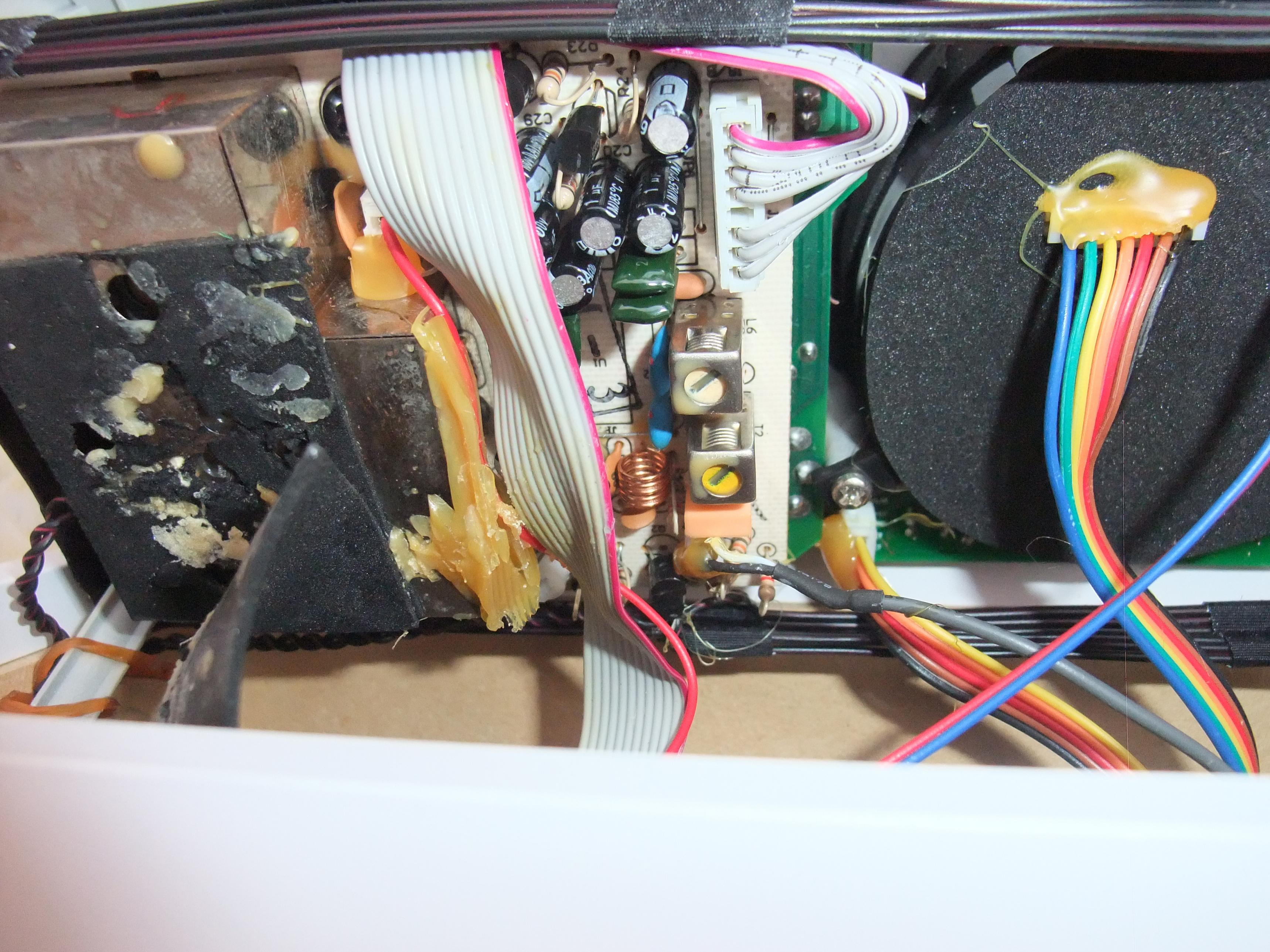

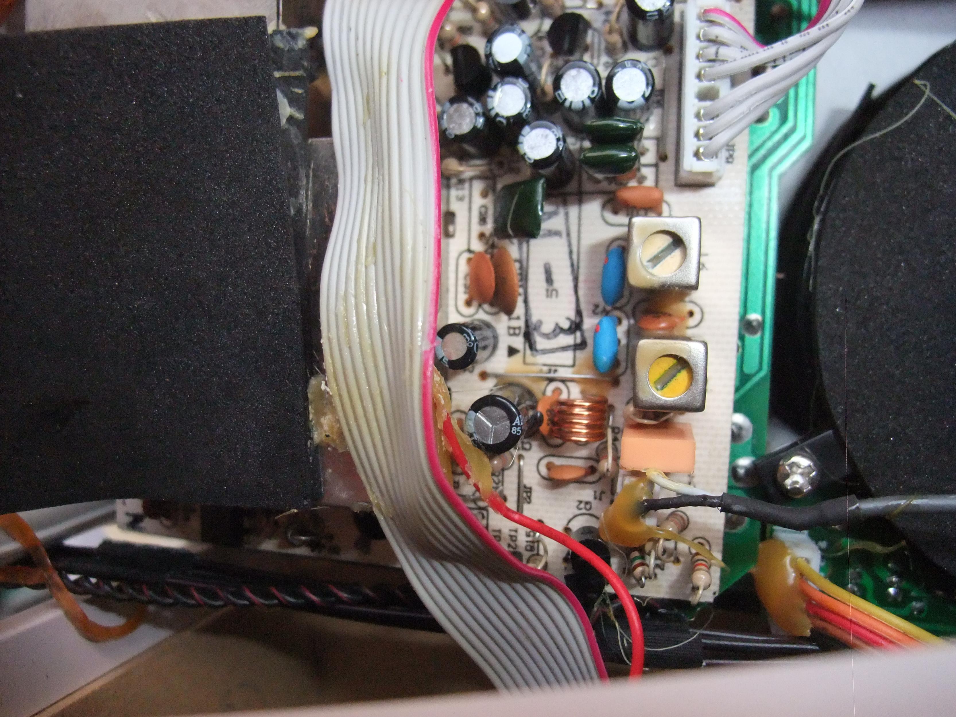

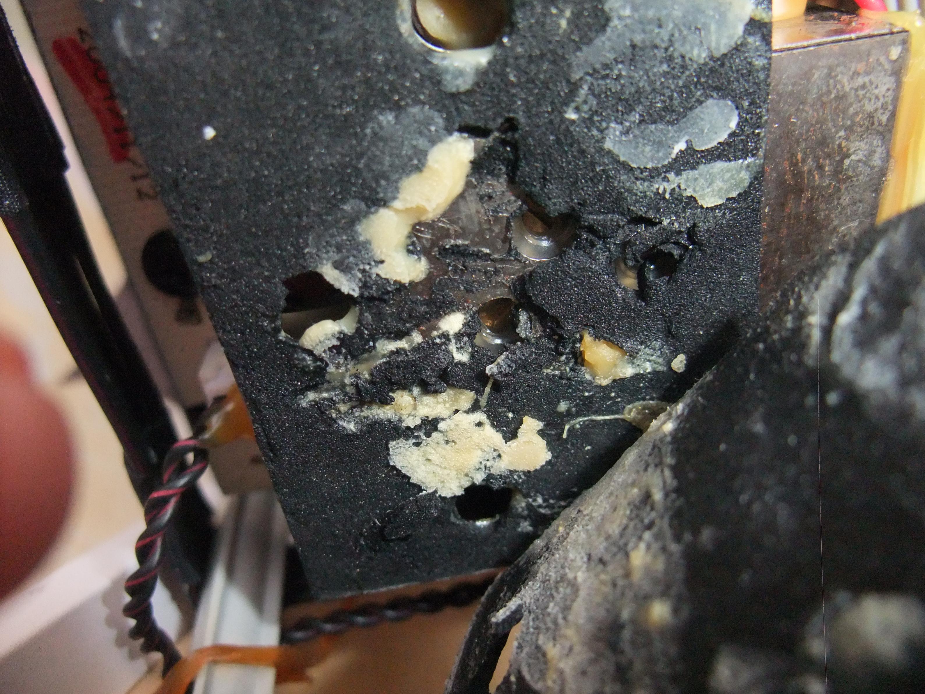

Pictures from inside MODEL THREE
even less service-friendly than model ONE
