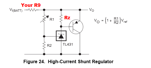

What is the top circuit supposed to do? It can't be a voltage regulator, it has no voltage reference or error amplifier.
Both rails has the TL431 shunt regs, but the current trough them is rather high, cind of close to the max limmit of 100mA. On the other hand i do not like one bit that so called rectifyer config on the upper rail, that is not verry good for audio circuits, i think it would be much better to get a power transformer with the proper voltages and quit that multiplyer alltogether, as long as you have regulated voltage then you have no voltage ripple, all that spider web of there is just asking for trouble, if the circuit powering up from this regulator does not need more than 50mA of current then just TL431 with maybe some compensation would do just fine, if the current is bigger then a small power transistor can be added to help.
You will be exceeding the TL 431's dissipation limit (if the previous poster is correct that they are running at circa 100ma current) which is under 1 watt if I recall correctly. I suspect this is why it is failing.

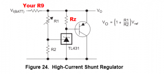

There's a nice idea in the datasheet of the TL431: connect an external transistor to conduct most of the current and let the LT431 control this transistor. See drawing. If you set Rz = 330 ohms then the TL431 will conduct (VBE / 330) = 2.1 milliamps, and the external transistor will conduct all the rest ... up to (Beta x 1mA) of additional current.
The circuit is fubar. Overcomplicated.
Build the circuit with 48V CT transformer and bridge rectifier or a 24V transformer with symmetrical voltage doubler or whatever (symmetrical DC) or even 2 independent transformers (asymmetrical) and regulate with LM317 & LM337 to +27V and -9V.
