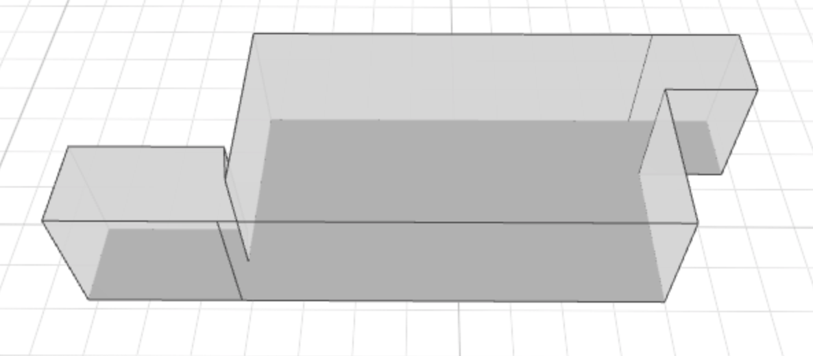

Basic room dimensions:
Main space is 8x5m, 2.6m high (front wall on top here)
Top right area is 2x1.6m, same height
Bottom left for stairs, only 90cm open to a 2x3x5m high volume behind then opened to second floor.
Maybe already too much details so not showing doors, windows, chimney etc
All walls are granite, ceiling and floor in concrete.

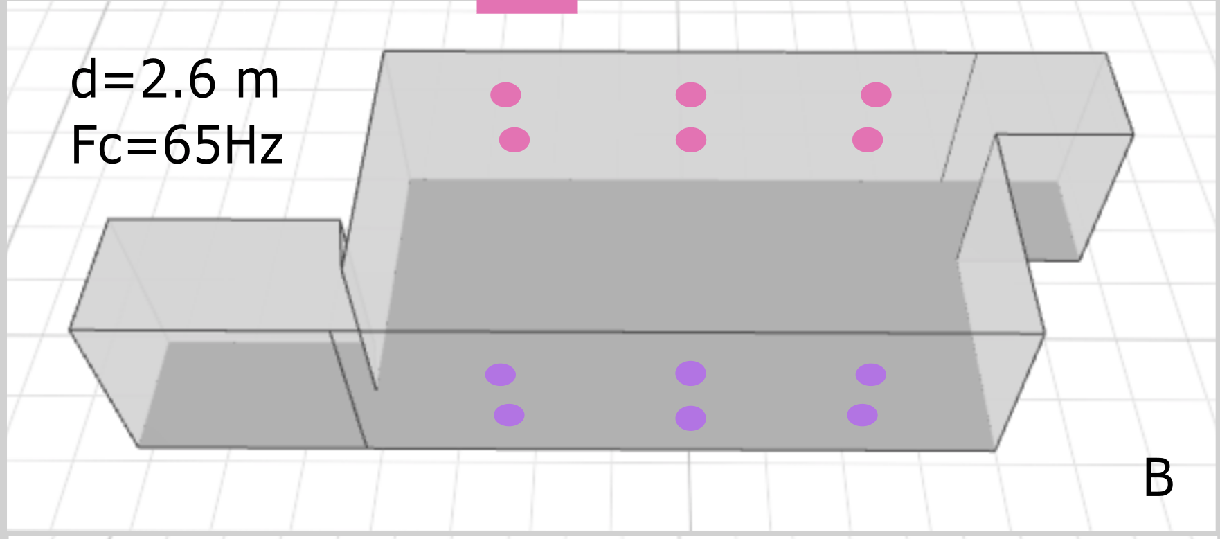

Based on this I have few options:

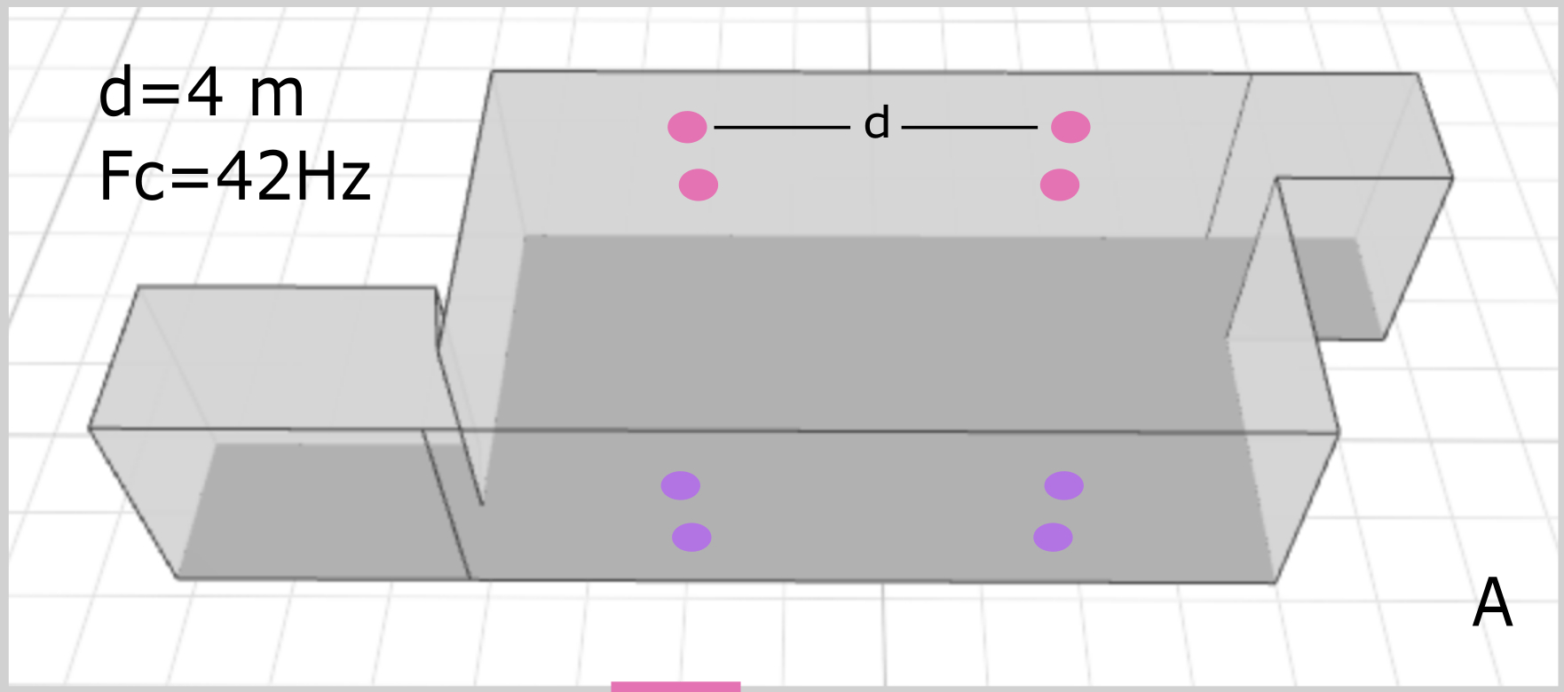

A - simple 4.4 grid, clearly not optimum but I wonder if it could still deliver a good compromise as I'm targeting a 50hz XO.
Maybe it could already significant, like the dipoles.
Now I wonder if a minimal 2.2 could work, as the 2.6m height would still be lower than the horizontal d
B - better for the intended XO, 4 more drivers (ouch), but still unknown about the top right opening.
I use this space right now but could also maybe fill it a bit with fiberglass, trying an hybrid SBA/DBA but in lateral.
Also the front central bottom sub will have to be placed a bit lower but it should not be a big deal.
B' - Deal with the opening with 2 more subs, that will require 1 more dsp channel (unless by luck just delay and not inverting it could work).

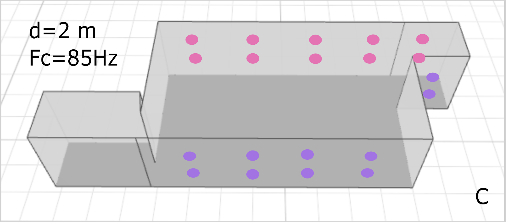

C - in case 65hz is not good enough... insane, but DBA is insane
D - No I'm not even showing how to deal with the stairs, I will have to live with the mess from there 😀
So,
  • A or B, is A a good starting point to experience the DBA effect or should I already target B?
  • then B or B'? Does anyone have experience with a similar "small" L shape?
In all cases I could also adjust a bit the rear array, with maybe less driver like 4.2 or 6.4, these solutions seem to work well enough in the papers.

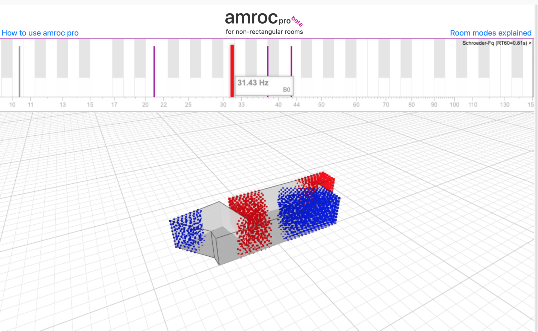

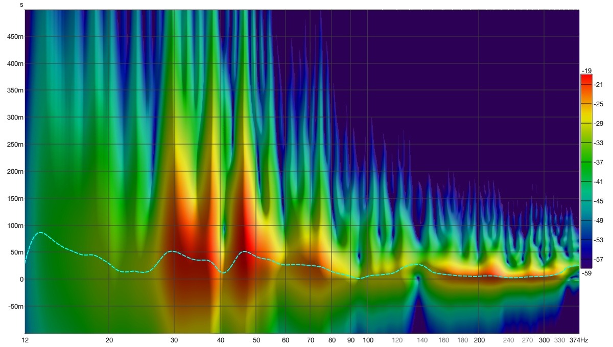

I was playing a bit more with amroc, trying to build a room that would match my REW measurements.
It's not possible to have variable height (or I didn't find it) so I played with the stairs opening and the volume of the stair space behind.
This one seemed to work, extending the volume but still at 260cm, and reducing the opening width to match the Sd of the « non door », if it makes sense.
Anyway:
Rew modes, no Eq:
  • a few below 20hz
  • 23hz
  • 30hz
  • 37hz
  • 47hz
  • 55hz and some smaller ones around 70hz
The simulation, the closest I could find with few matches: 23, 30, 37 and 47Hz
With the multiple shapes I tried it appeared the stair are not the issue really as the modes build up behind and don't interfere much with the main room.
But the right side space has more impact.
So probably treating it will help.
Ok I think I will do a plan for 12 drivers, 6.6, it should cover the 20-65hz range and maybe careful placement of the mains could help for 75hz.
With the option to add a big basstrap in the right side.

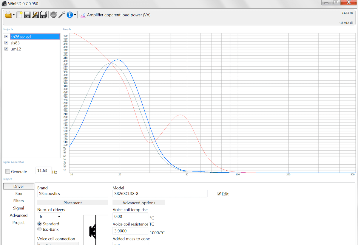

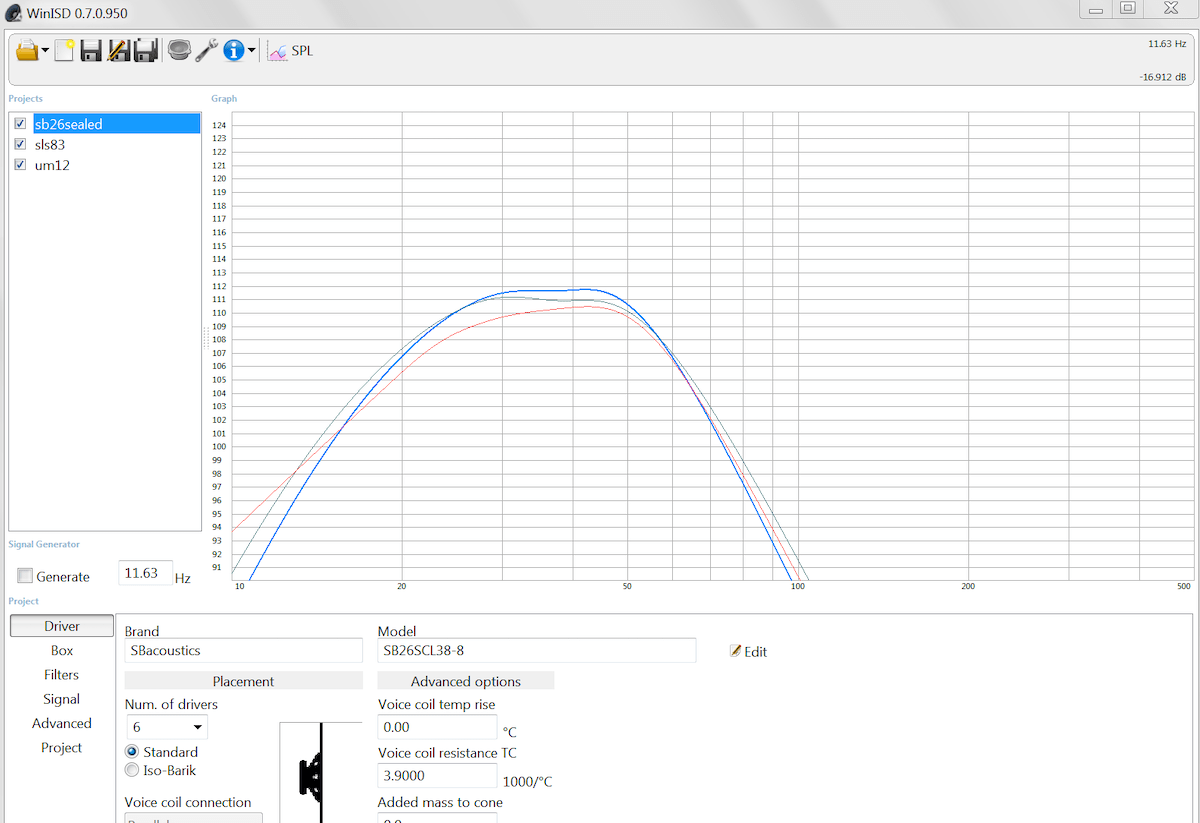

I have hard time to define the spl needs, right now I'm sub-less but I remember when having 2x or 3x 12" ported it was enough, and probably more than enough based on the XLS1502 power lighting scheme.
So I picked 2x12" as a reference, a baseline, so a total Vd of nearly 2 liters.
I found an answer in the big DBA thread on AVS, there is room gain in dba/sba, confirmed by measurements.
So I would go with sealed, much easier but that drives the driver selection.
The plan is 50 L. net per box, shallow like 60x60x20 cm outside.

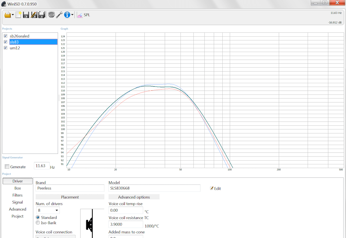

Then I compared everything I could find in winisd, mostly from the TLHP library as it's very easy with their filters, speakerlite box was useful too.
Even if I have limited trust in all these I believe it should be close enough to real world results.
So tried a lot from SBacoustics, some ciare, sica, visaton, daytons + some PAs etc

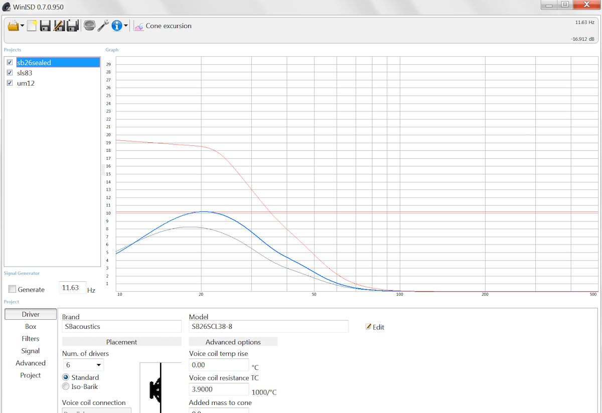

But to match the total Vd with 6 front drivers means a Vd per driver near 0.3 Liter, not that easy for non expensive ones.
That's either an 8" with 15mm Xmax or a 10" with 10mm Xmax, with low FS, low Vas, reputable and reasonable price, I couldn't count them on my hand...
So price was the driving factor and I took the other way around, starting based on price.
I ended up with 10", either the SB26STWGC or the SLS-P830668.
Here are some sims maximising excursion with eq, 8x sls / 6x sb26 / 2x um12:

8x sls + boxes would mean around 800eur, 6x sb26 + boxes around 700eur (double it for both walls).
I think will try with the SLS as it would give a better spread.
