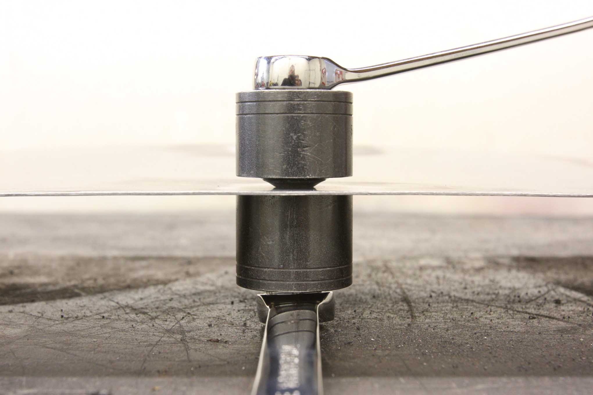

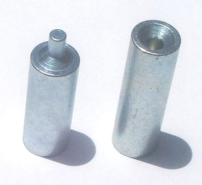

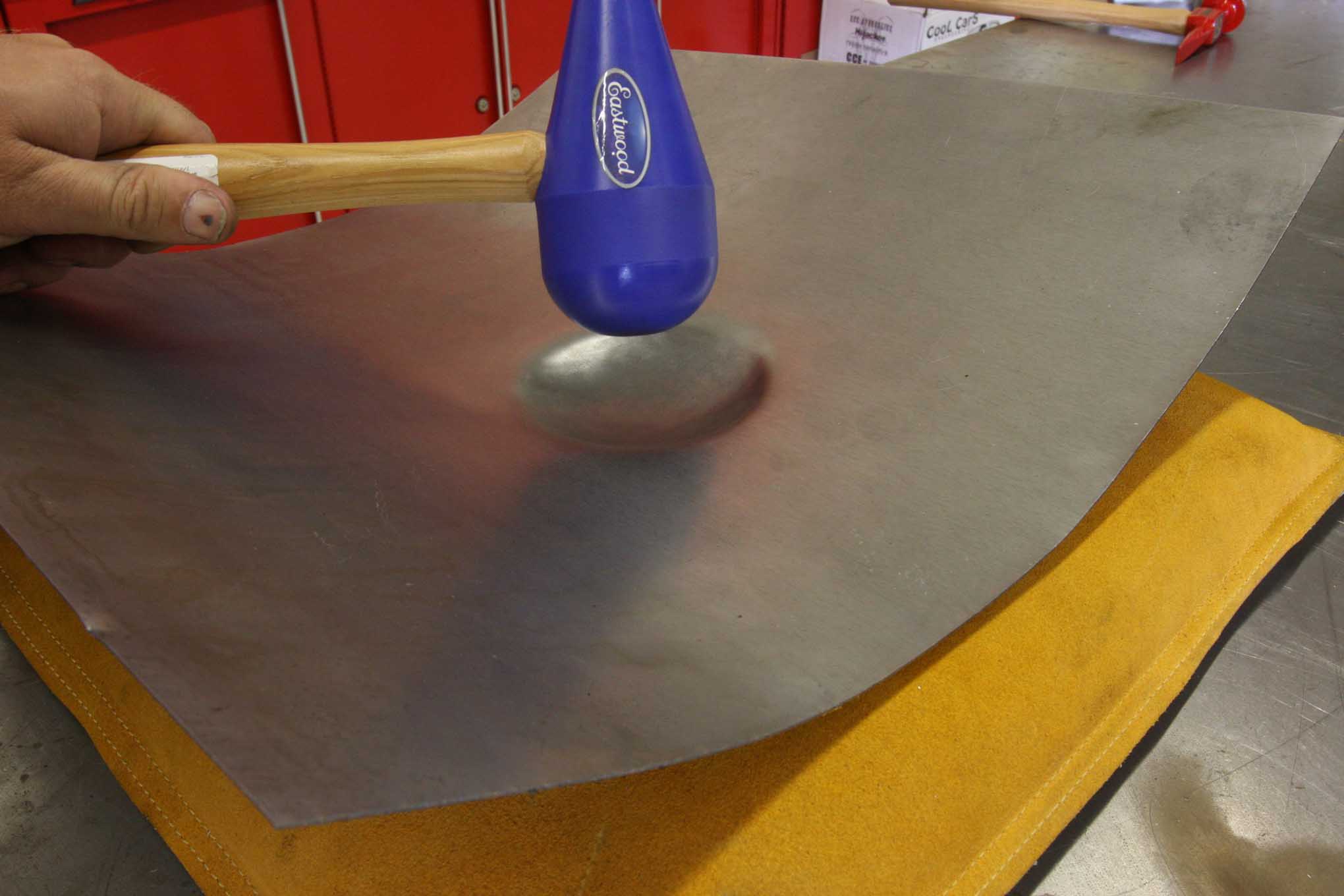

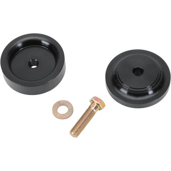

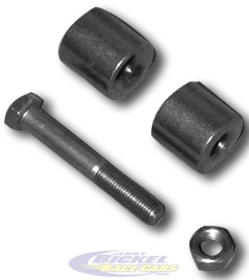

From the other forum:
> It's possible to upload some photos?
Of what? A dimple? A wrench socket? A bolt?
The "big money" is in tapered dimples. Lots of tapered dimple-dies for that job.
You only need a flat dimple bigger than your bolt+wrench, deeper than your bolt head, and nobody will see it. You can do a respectable job with two sockets and bolt or hammer. (You can even use a round rock on sand, but it takes a steady hand.)
