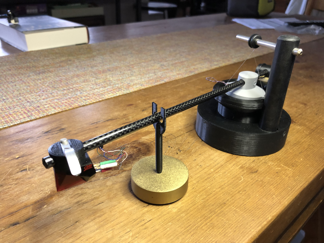

I'm making a couple 3D-printed tonearms using carbon fiber tubes (7mm OD x 5mm ID) and hope you have tips on grounding. I've made a few arms in the past (the first used a spare wired WT arm wand) for self[-use and followed what's been done by Well Tempered, but there's often ground hum once done...
I use very fine Litz wires, which are coated with enamel and wrapped with silk. I separately twisted left and right pairs and then wrap them with the ground wire, which connects at the table's ground post and floats free inside the arm after wrapping around the twisted left and right pairs. Well Tempered connected their ground to a screw at the end of the metal tone arm shaft behind the headshell mount, but theres no metal to connect to with a fiber shaft...
For damping, I use hermit crab sand, which seems to work well. I cut apart a large O-ring to close off the arm ends and cut apart smaller rings to fill to holes where the wires feed in and out.
There's very little room in an arm like this in which to add a loosely woven shield netting around the arm wires, etc... Once completed, my arms seem to have a bit of a hum, not noticeable when the music is being played but audible in silent passages.
I see that others have run the arm pairs outside along the sides of the fiber arm tube, holding them in place with heat shrink tubing...
btw: We all know how hard it is to solder Litz wires - I've had luck removing the enamel on the Litz wires by fanning out the tiny wires and dabbing them with lacquer thinner first.
Thoughts?

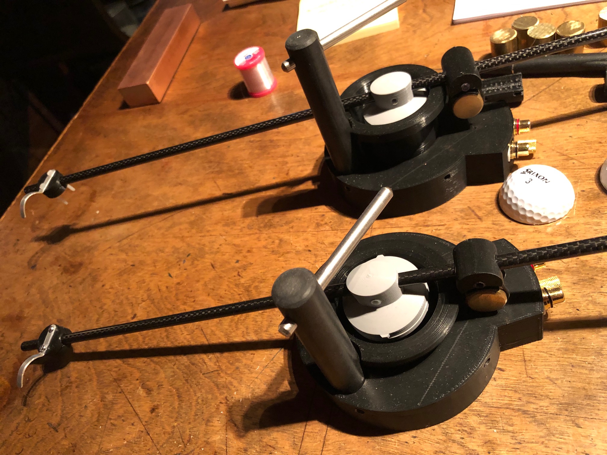

You are the first to see 'em. Making a 9" and a 10.5" for use on my Braun PCS5 and a Neat Shield MO-19 idler. The base adjusts to accommodate the taller Neat platter.
I made two arms for them previously, using existing parts, brass disks, pipe end caps, stainless steel... it was hard to get done because I had to depend so much on others for drilling. Now that I have a FlashForge Finder printer, it's all in house! Bases will be filled with steel balls or cut brass rod for weight. I'l be able to move them to other tables easily with the wiring done in the bases.

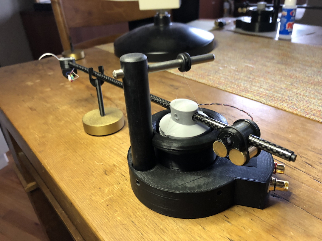

Yes, I've thought about that. I see the install going something like this:
Feed the ground wire thru the pivot hole and out the back (may need a monofilament lead to pull it with), where I'll solder it to the sleeve, which has two oval holes cut out of it for entry of the wires in at the pivot and out behind the headshell. Run monofilament thru the front to the pivot hole and another thru the front and out of the front exit hole. Then I'll tie these monofilaments together and to the arm wires. I'll pull the sleeving thru from the back to the front and wrap it over the front end and twist tie it in place - after the wires are installed, I'll pull it forward and cut it off.
Arm wires will be twisted pairs red/green and white/blue, a twist about every 1/4 inch. These will be wrapped more loosely around a thin piece of silk and, hopefully will enter the sleeving from the pivot hole and pull thru the front side hole. If successful, I'll check continuity, add a piece of a 5mm diameter O-ring stopper to the front and smaller pieces to close off the two small entry exit holes, then fill the arm with hermit crab sand. The sand is extremely fine and has damped other arms very well. I'll add another O-ring stopper to the end.
Sound right?

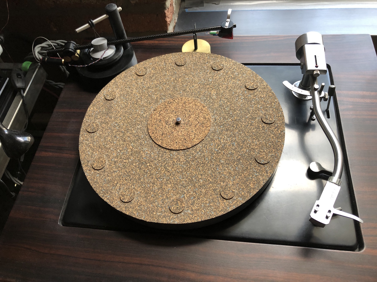

Finished my two arms - here's the 9" at it's highest adjustable height and installed on the table. I used a tinned copper shielding inside and hermit crab sand to damp the arm tube. It's on my 1962 Braun PCS5 for now. Original headshell of the Braun was upgraded last year. My 3D printed subplatter ring (not shown) reduces the 33-1/3rpm position speed to 33.7rpm by enlarging the subplatter's diameter. This was due to the motor being 50Hz and running fast under 60Hz US power. Using a thread belt also helped reduce speed. Sounds fantastic. Mono cartridge in the original arm.
Finished my two arms - here's the 9" at it's highest adjustable height and installed on the table. I used a tinned copper shielding inside and hermit crab sand to damp the arm tube. Mounted it on my 1962 Braun PCS5 for now. Original headshell of the Braun was upgraded last year. My 3D printed subplatter ring reduces the 33-1/3rpm position speed to 33.7rpm by enlarging the subplatter's diameter. Using a thread belt also helped reduce speed. Sounds fantastic. Mono cartridge in the original arm.
