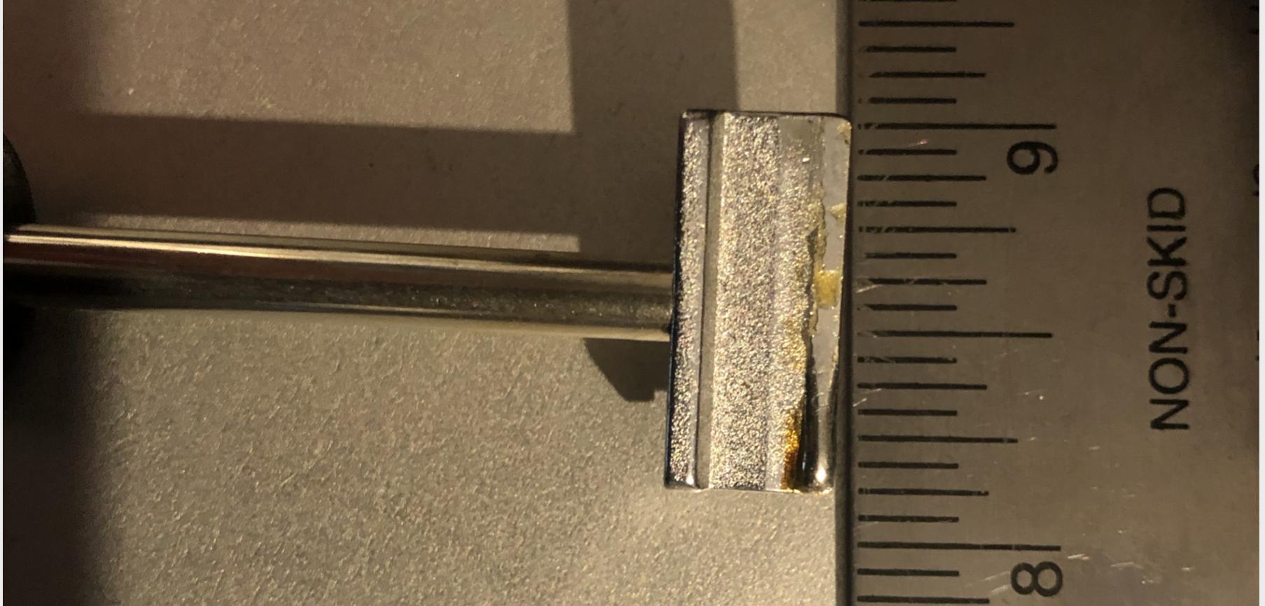

This is the bit I use to clean off PCBs when I remove BGA chips to fit new ones. It is used with my OKI MFR 1300 work station.
