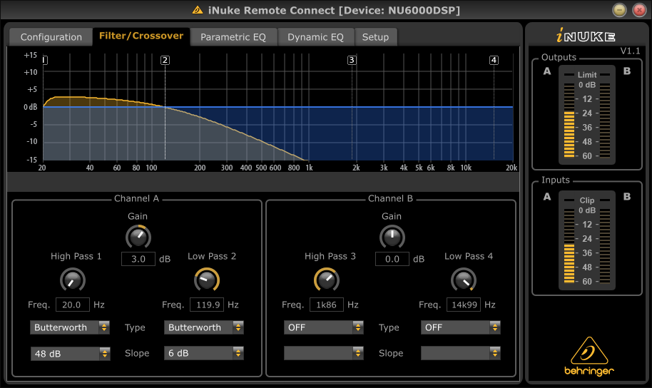

Started to experiment and a few simple settings is satisfying enough.
Did a HPF on 20hz with a butterworth 48dB/oct

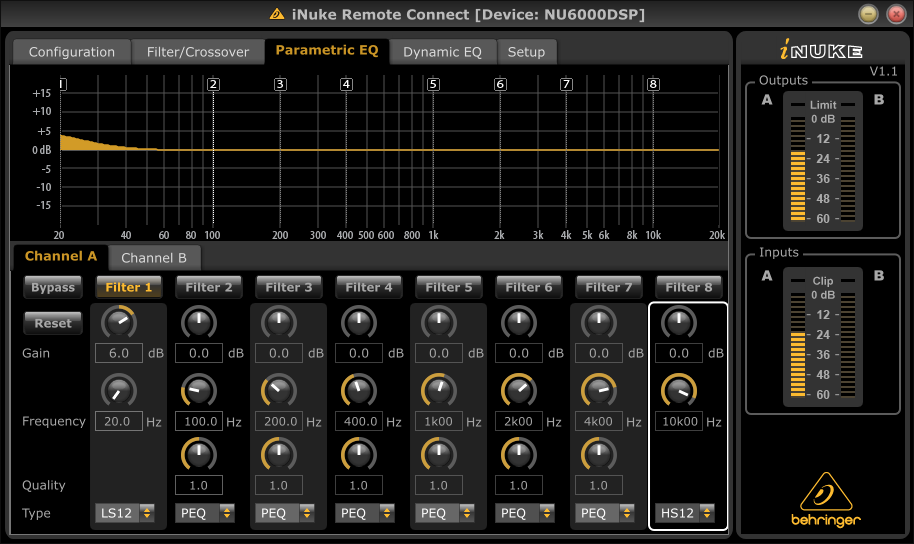

And a PEQ boost at 20hz of +6dB
Which results in a flat response down to 20hz and down from there falls like a brick. 🙂
Boosted everything by +3dB and sloped down -6dB/oct from 120hz and up to counter the supposedly rising response from the sub.

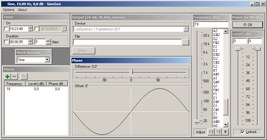

One question I hope to learn more about is when I tested sine signals from the laptop, not much input went in the amp until I fiddled with the 'Phase Difference' Then the volume went up fast as the difference increased. I don't understand this but would like to know.

from the first pic i see a low shelf,not parametric eq.
phase responce should do nothing with input/output level?
maybe a glitch.

Yes I meant the tab 'Parametric EQ' sorry for being unclear.
