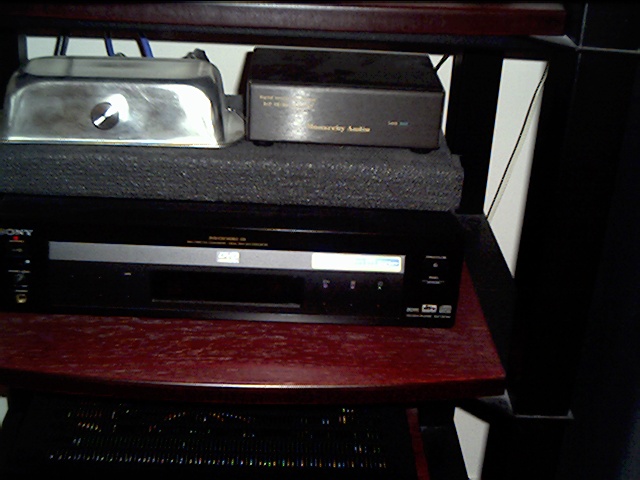

I try to avoid selector switches in my main system. After all, it's a reference system and I'm using only one (the best) source. So no need for switching. I believe that even the best switch, has some influence on sound and can degrade it in some extend. Little inconvenience is a small price to pay for quality (whenever I have to switch sources I just switch cables)
Even my new preamp will have only one input (RCA and balanced) and no switch.

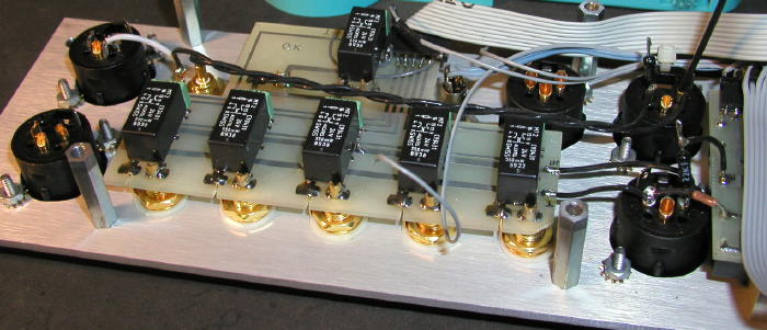

Previously, I was usually using multiple relays to do switching (both signal and ground).
