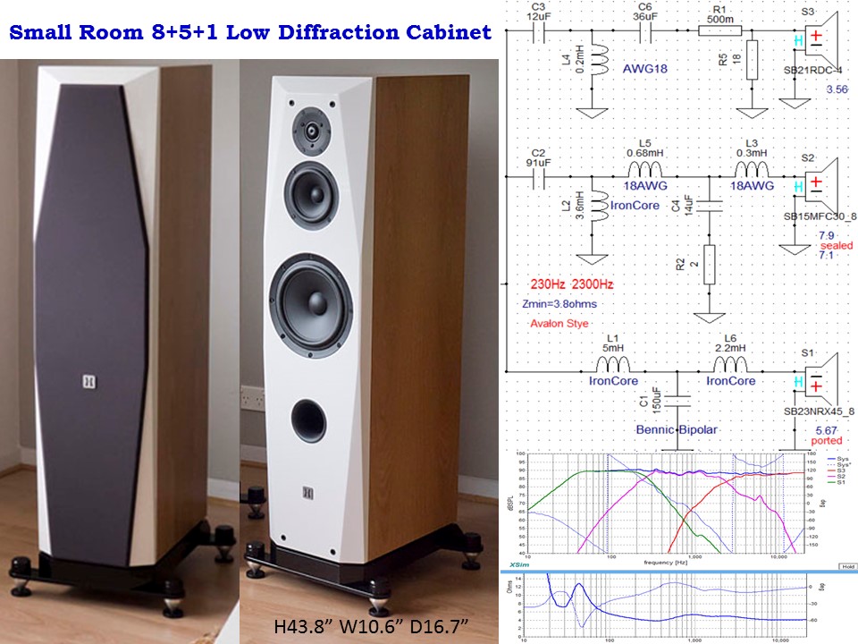

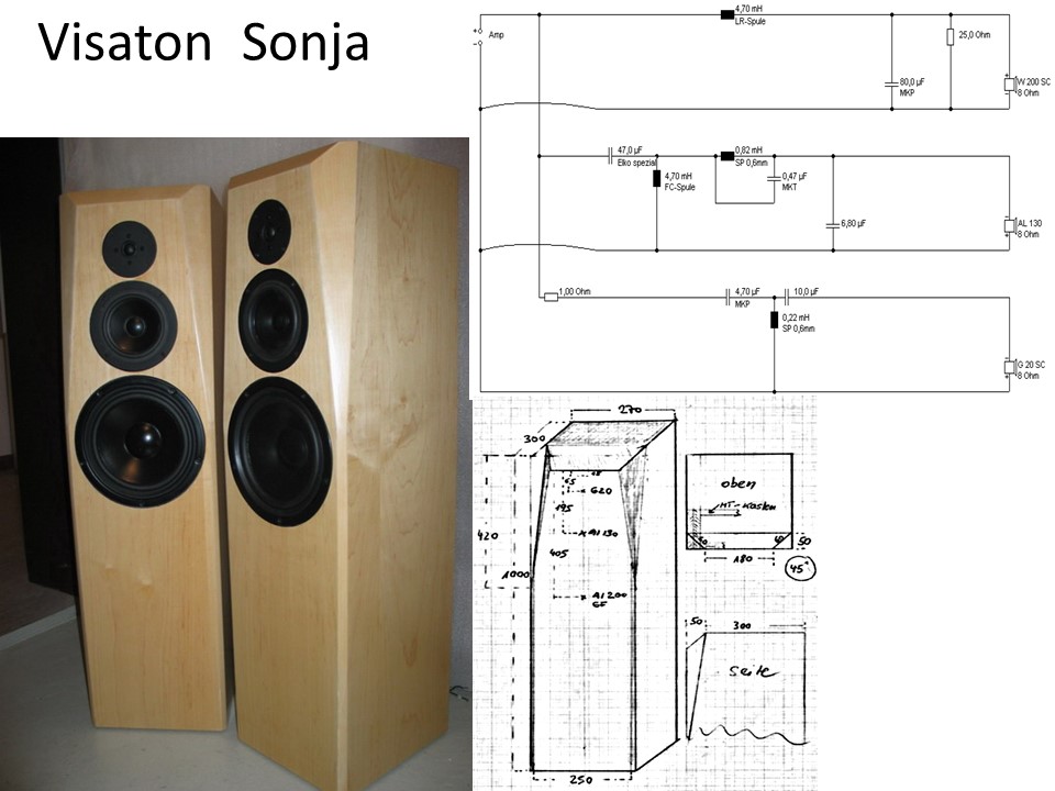

-----To best mimic a point source, with a 250Hz crossover the C-to-C of the M-to-W should be < 13"
Example: 8+5+1
Truncated Pyramid: Drivers + crossover L-R-C ~ $250/speaker

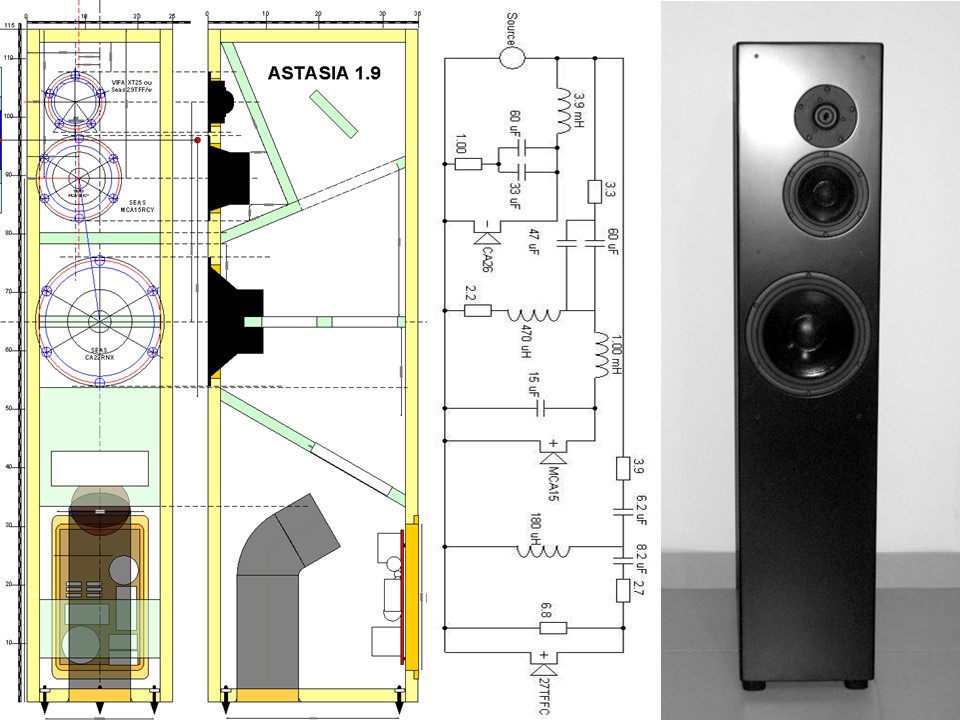

Sonja from Visaton diy info
ANASTASIA
Astasia Prject - 3 ways loudspeakers
Example: 8+5+1
ANASTASIA
Example: 8+5+1
ANASTASIA

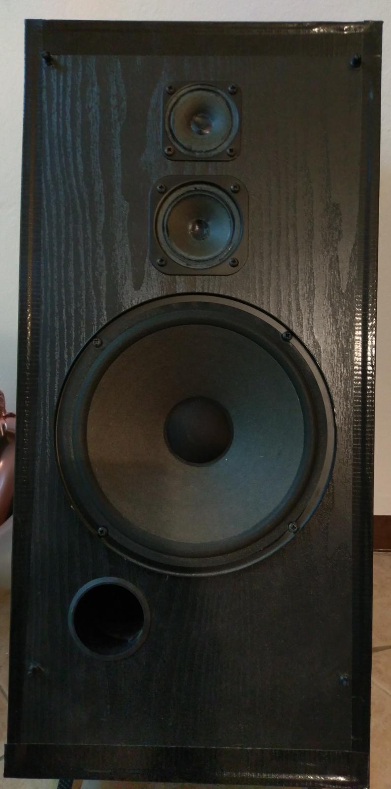

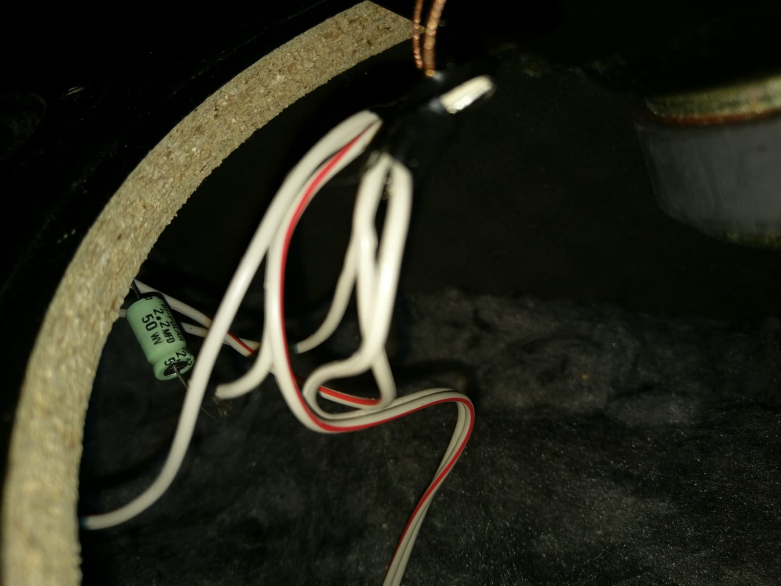

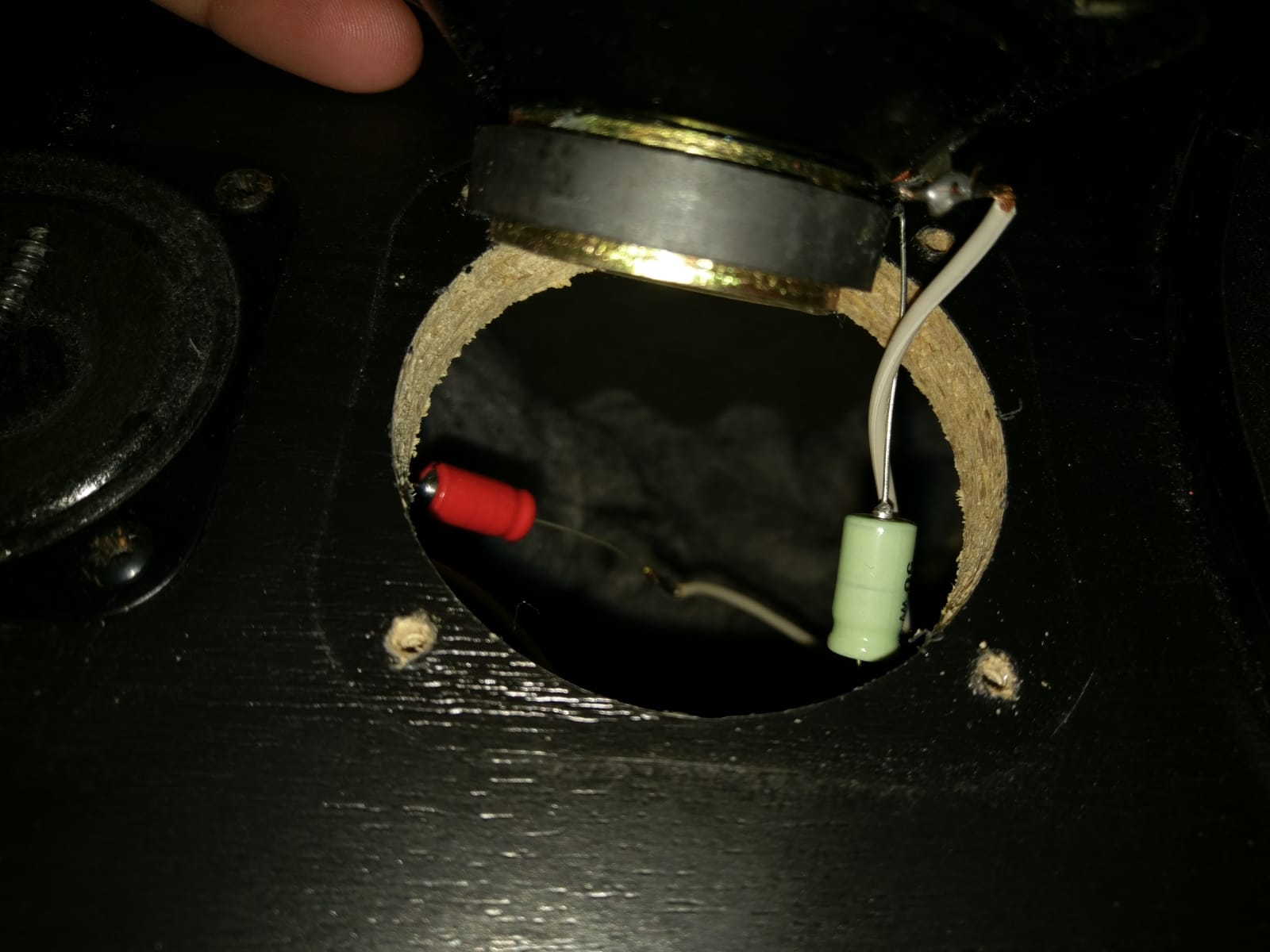

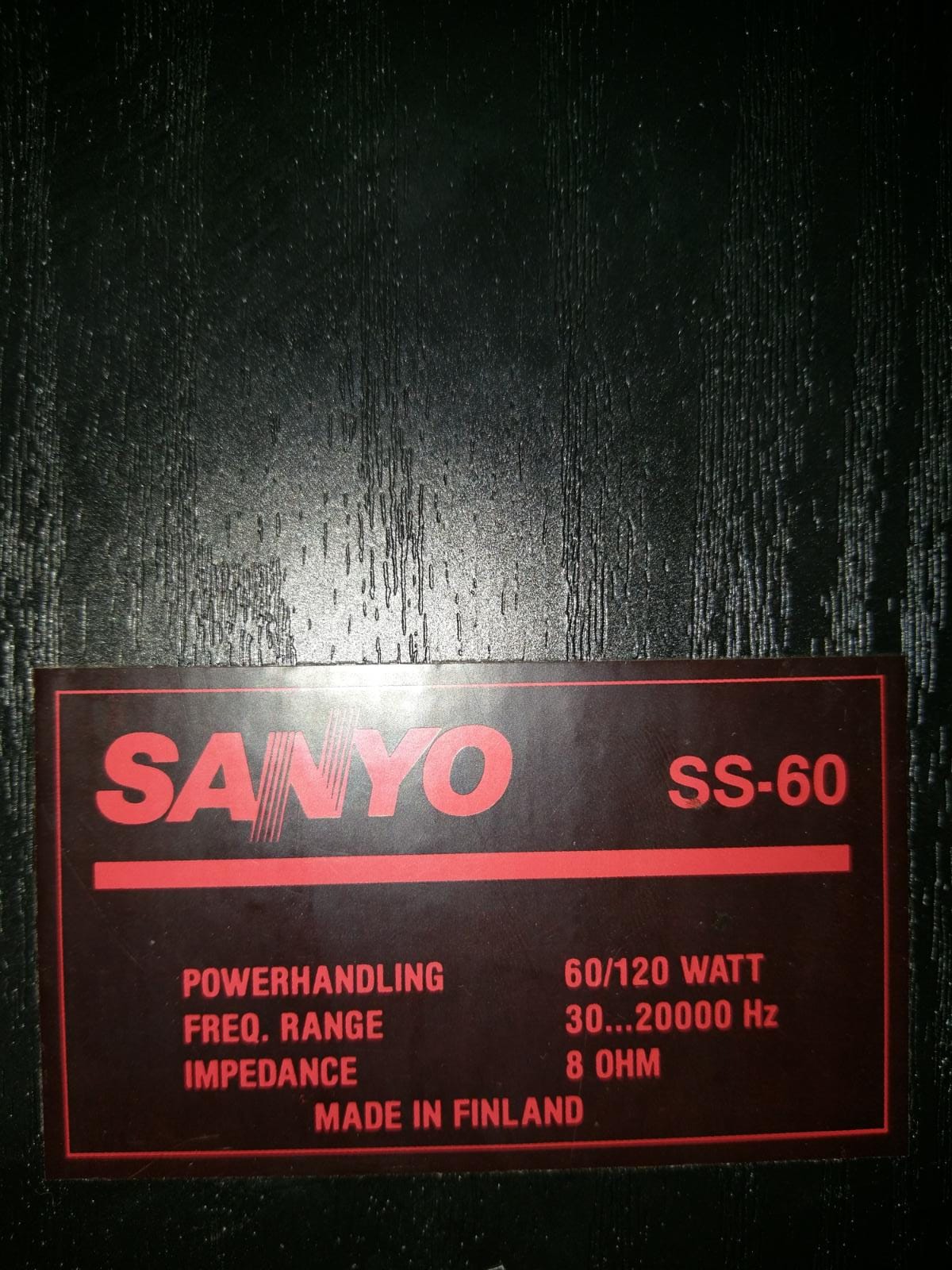

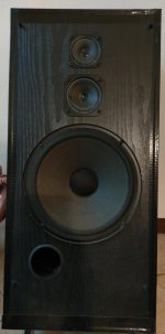

To clarify the last part, I have a pair of old 3ways (box falling apart and probably tinkered with by previous owner, yet have sounded quite good). So I thought I could do a combo of Rescue/new speaker i.e. Salvage what I can to use in my experiment build (Ill attach a picture of them).
So for now I was thinking I could use the 7" woofers on 2 separate boxes (using the current box dimensions and port to avoid all the calculating since I have no T/S specs on them) and I saw some cheap amps around for them as to be used as a pair of subs (they are supposed to be rated down to 35hz, dont have +-db on that, but "seven nation army" sounded quite good on them 😛 😀 ).
And then I'll do the the 2-ways either using a kit or try* to diy. I'd rather diy, obviously got a lot to learn still but I can make time.

2. Provided that the receiver/amp I have sends anything below 90hz to subs (as per user manual) and that I'm going to attempt doing these "subs", does this mean that the design of the crossover for the 2-ways has to be in anyway different? Im guessing no cause it's still 2 speakers, but Ive been corrected plenty and rightly here before LOL.
3. The "rescue" 7" woofers are rated at 60W (100max) so should I look for similar rating for the 2-ways? I know I have been given some info on the wattage here before but since the "subs" would be separately amplified then Im wondering if this changes everything.
