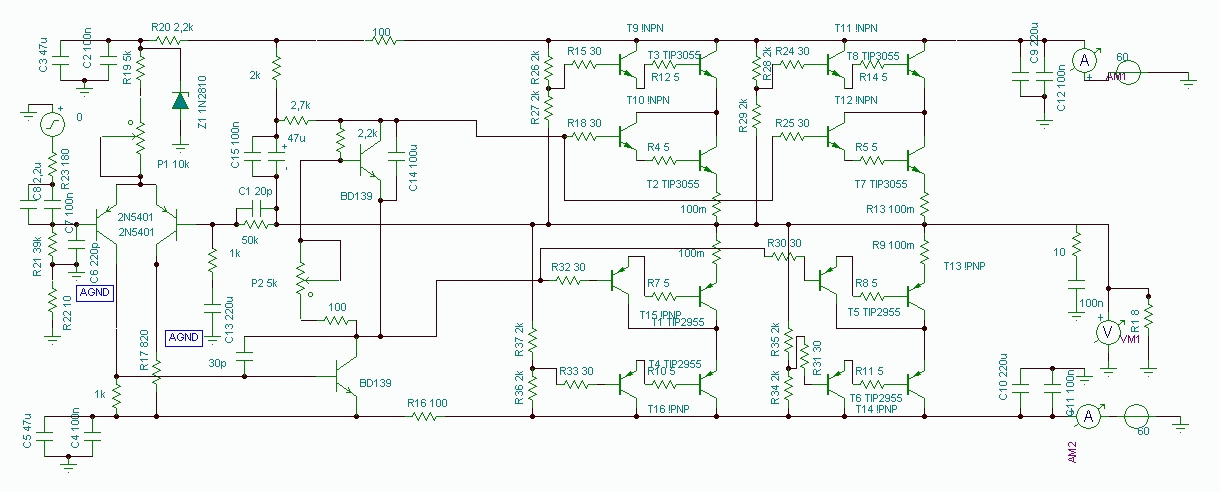

You can put two 2n3055s in series to get higher rail voltages.
Hello
I've just finished, for a friend, to simulated an amp base on the DX amp and using 2n3055s in series and same for 2n2955s. I've post it in the DX thread.
After correcting an error the simulation work good.
It seem that my schematic can not have a suck-out capacitor between the drivers emiters, any ways to place a suck-out capacitor to reduce the driver switching noises ?
You would get about 125 watt out of this amp.
Bye
Gaetan

You need to do a bit more work on th e fron t end of this design. THe output stages are slow, so you hav e to limit th e loop gain to giv e yourself some decent phase margin. 1st step her e is to provide some degeneration on that long taile pair. You hav e used a boot strap load on the VAS. While this is ok and gives good results, you might consider using a current source load (added bonus: use th e current source Vref to create a current source for the LTP - see Douglas Self for some examples on how to do this). For this type of classic design, I'd definietel;y encourage you to add a Zobel network and an output inductor.

Hello
Yes, I would use a 100k hz low pass filter at the input and maby a CCS.
Maby also a phase lead capacitor. And a zobel.
And a better VAS transistor, like a 2SC3503
Any ideas where to put a suck-out capacitor ?
But that was a test schema and since I was using the DX amp as a base I did keep it close to the DX for now and to post it in the DX thread.
My friend will need to a prototype since I'm short of time to do it for him.
Thank
Bye
Gaetan

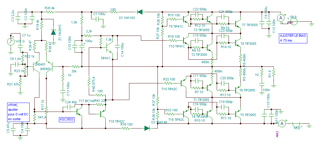

You're making it a bit more complicated. Use one driver for each parallel pair of outputs, not one for each. Then you only need two sets of divider strings and a lot less holes in the PCB.
You can't put a large suck-out cap on the outer set of drivers because it will upset the voltage division for fast rise signals. The inner set can have a standard suck out cap. One thing you can do is to put a resistor between the emitters of the outer driver transistors (maybe 20k) to force a higher bias current in the outer drivers. I did this on a 1500 watt amp of this style and it improved both crossover distortion and stability.

Hello
I've done another one and use the second type of suck out cap by placing it across the base stopper of all the output transistor. I've also raise the divider resistors value and put a buffer to the vas.
