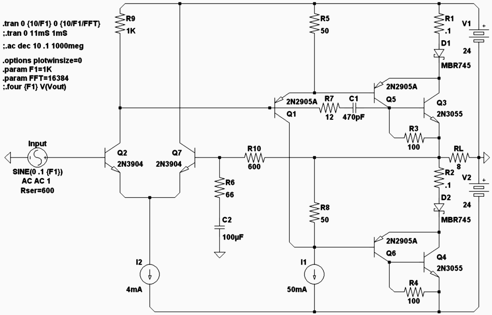

I've noticed that I have amassed quite a few TIP3055, TIP2955, 2N3055, MJ2955 transistors throughout the years. These are the standard 60V/15A variety.
I would like to build a power amp that can put out approximately 300-500W into a 4 ohm load with +/- 30V rails. My main problem is the lack of a proven/suitable design to work off of.
Does anyone have any ideas?

Hmmm. With 30V rails, your output will be some 28V peak which is 20V RMS, over 4 ohms that's 100W. So you will be needing two amps bridged to get to 300-400W. Each amp will 'see' 2 ohms load. To avoid 'gain droop' at high currents you probably want to have at least two output pairs in each amp.
Other than that, there's probably a ton of amp circuits around.

as suggested earlier, a pair of 150W into 2r0 amplifiers connected as bridged will give 300W into 4r0.
This can be achieved reliably with a 4pair output stage on +-30Vdc. That requires 16devices to get your 300W.
You will probably need another pair of devices as drivers due to the low gain of the 3055. Your total is now 18off 3055 and 2off 2955. There are better ways to do 300W.
Neither 400W nor 500W is possible from a +-30V supply.
Bridged in 4 ohm, just about 400W. Only just with 28V out. Not sure it would work with 3055 on 30V, so you may be right.

Sziklai pairs hold an advantage here. It can hide both the base current
and the base voltage swings of these old dino-transistors into the total.
Slap a Schottky and .1R in series with the effective emitter of this pair.
Gives a nice Squarelaw curvature, independant the clunker's curves and
thermals. Wether or not an MJ and 2N behave as good compliments, two
Schottkys far away from the heat will.

Sorta what I meant... Take the 2N3055 base currents and thermals
out of the decision making process.
And this may look like JLH split current drive. But due to big leaky
bypass resistors, behaves more like folded concertina, split voltage.
Important distinction if you want the Schottky square law voltage
drops to have a say in the output currents.
Also big leaky base to emitter resistor, help put the brakes on that
2NLedSled.

IIRC, the forum software does not "allow" usernames with characters other than letters and numbers; I'm not sure why I was even allowed to sign up with the username. I guess to forum seems to be linking my profile to anyone with "db" in their profile name. I sent a PM to the admin a long while back and I never got a response; either ways I'm not too concerned...
As for the amplifier, I would really prefer something that uses both the xx3055 and it's compliment, the xx2955. I have looked into building several JLH amps and bridging them but the amount and cost of parts required is more than I want to pay...
I am looking into using the LM4702 chip to drive 14-20 pairs of transistors. Since the voltage I intend to use is very close to the lm4702's minimum, will this cause any problems? Should I use a dual rail supply instead?
Any and all comments/suggestions are greatly appreciated!
