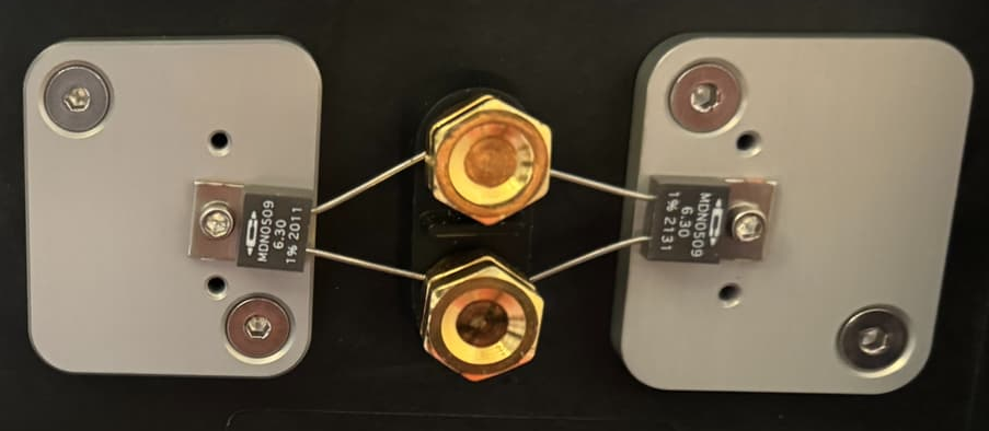

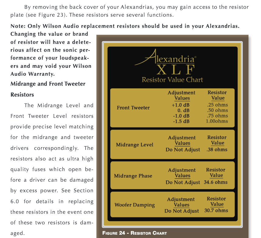

The tweeter attenuation series resistors "also act as ultra high quality fuses which open before a driver can be damaged by excess power".

The Caddock resistors are an interesting specialty item.

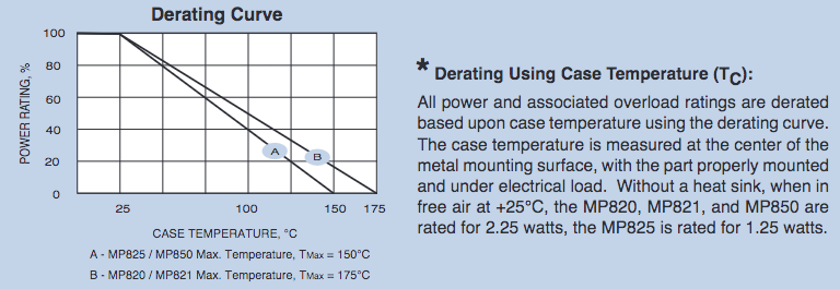

This Caddock "current sense" resistors appear to what Wilson uses, though I didn't find the specs for the specific units, these specs give an idea of what they do:
Interesting resistors, power handling goes from 20 watts at room temperature, derated to zero at +175 degrees C.
Without the heat sink, they are rated for as little as 1.25 watts:

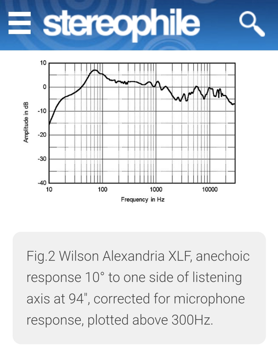

Could someone please explain that chart to me:
  1. it shows a frequency range from 10hz to 20khz but the text says 300hz and up!? So is the chart <300hz not anechoic, thus subject to room effects?
  2. Is the vertical axis normalised to 0db = average efficiency of the speaker? Is that to disguise its true efficiency?
