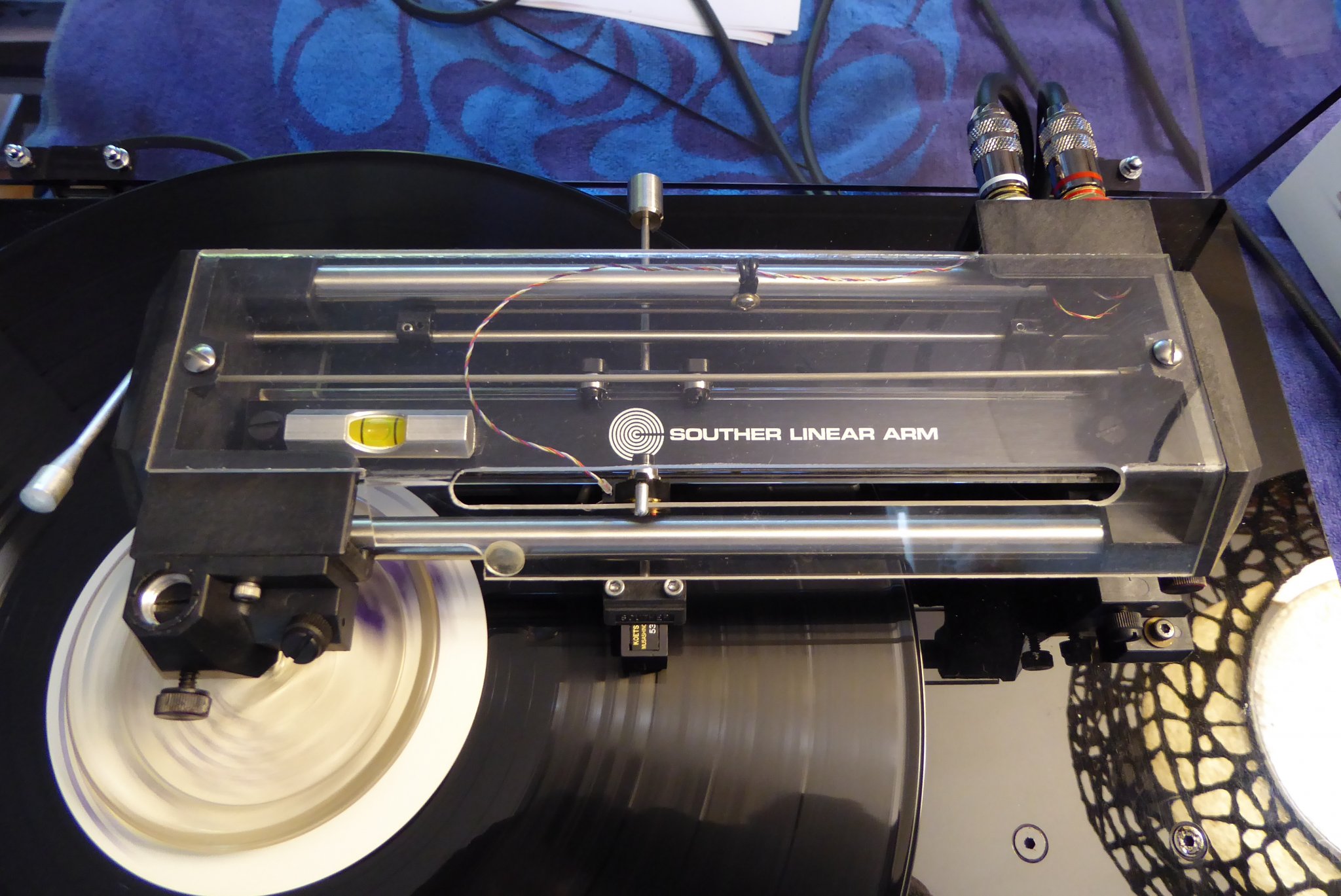

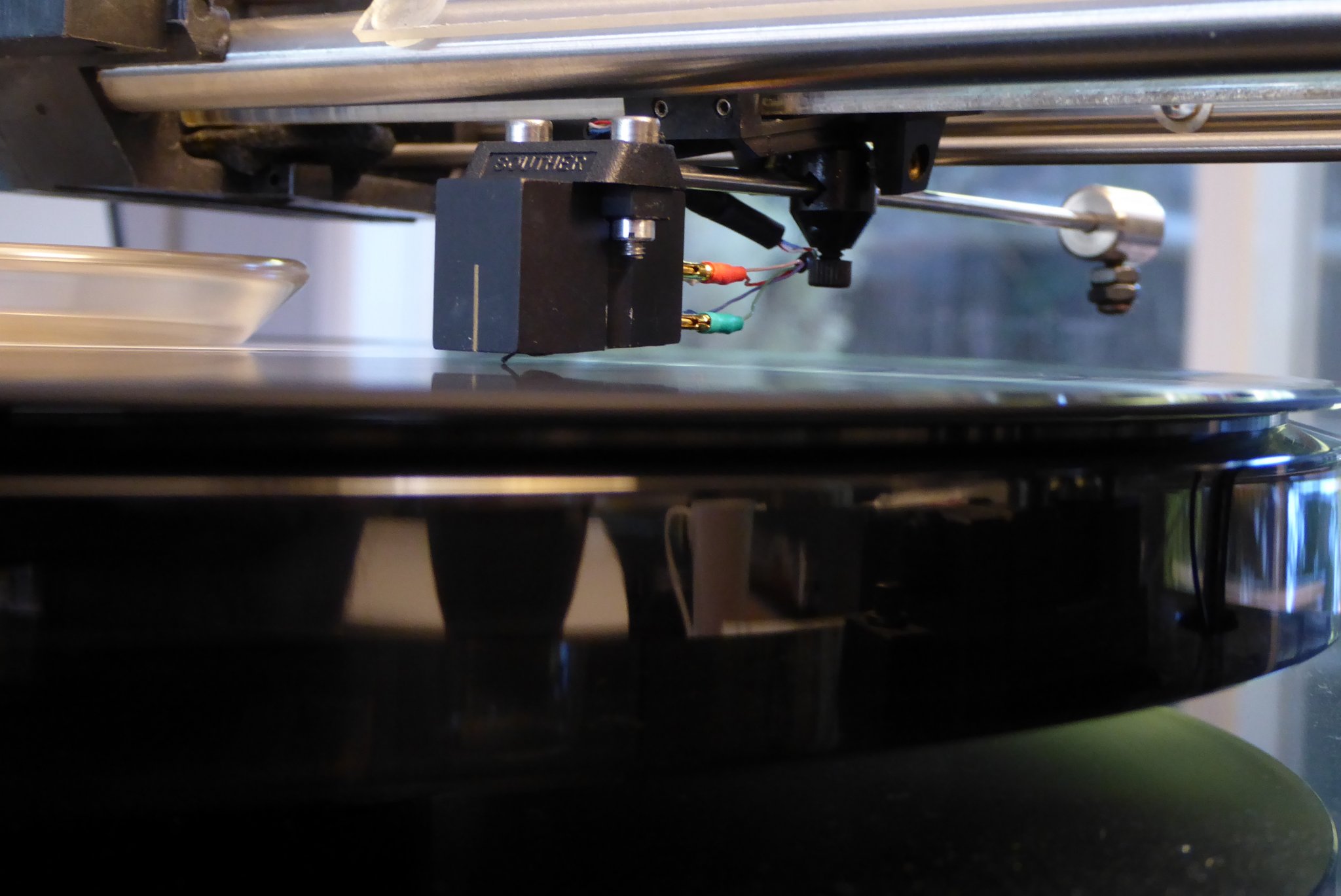

I would like to have considered something like Daburn 2712/4 when a few years ago a I rebuilt a Souther linear tracking arm, which would have made the task a lot easier. In the end I used flexible conductive plastic screening sleeve, donated from inside some Canare GS4 cable, to cover the Cardas Clear 34AWG cable wherever the extra stiffness wasn't an issue. Combined with foil screens along the raceway and grounding every bit of metal in the tonearm mechanism I was able to get the induced noise down to acceptable levels, though not eliminate it. The owner was ecstatic with the result, and still is many years later. The idea of planes of foil is that if grounded they "shade" the wiring from electric fields, though not entirely screening it. Mumetal and some steel alloys also work to deflect magnetic fields and need not even be grounded. Here's a simple yet effective accessory to reduce motor current induced hum in many Rega turntables: Hagerman Hum Bucker
You can see in the photo below the black tube behind the cartridge into which the wiring disappears; that is a piece of the Canare conductive plastic tube, which screens the cable up to the raceway. In the second picture you can see that there is a lot of unscreened cable along the raceway which needs to be super-flexible or it will induce skating forces, however by grounding all of the metal parts (which Souther had not done) and by installing grounded adhesive metal foil planes wherever I could out of sight, the noise pickup of the cabling was significantly reduced to almost inaudible, of course helped by the low output impedance of the Koetsu MC cartridge. Because of its proximity to the grounded metal bar, the section of cable to the right of the cable clip in the raceway did not benefit from a conductive plastic jacket, therefore I left it uncovered for looks.
