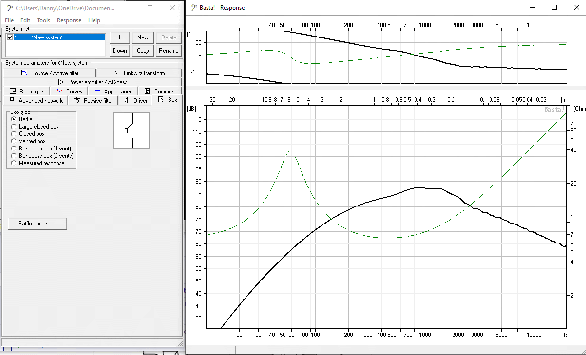

I was hoping to get some input on my first build, which I fear might be too weird to pull off. It's a desktop 2 way open baffle using a ribbon + woofer and DSP crossovers. I've never made a speaker before but have done a share of complicated DIY projects (drones and go-karts). After being blown away by a pair of spatials I thought I'd finally try my hand at a OB speaker, since according to the great Linkwitz, an OB is very hard to screw up.
For a tweeter with dipole behavior I picked up 2 dayton mid/tweeter ribbons that go from 250 to 20,000hz and a 4" aluminum woofer picked for flat FR, low group delay, and relatively high excursion for DSP purposes
Since I'd heard low crossovers are desirable the plan was to get the ribbons to cover down to ~500hz (or lower if possible). But since I heard crossovers can be the achilles heel for a speaker I opted for a minidsp which would split signals prior to 4-in-4-out 100W per channel class D amp so I could experiment with different crossover points and filter types. I was aiming to make the baffle as small as possible—which I know is detrimental to bass, but with a desktop system with a 4' woofer I'm not trying to dig into the sub-bass regions much at all. I just want some presence in the 100hz range.
With the sensitivities being different I wanted to know whether being able to independently control the gain to each driver through a miniDSP would compensate. My worry is that, should the spl-to-wattage response of the drivers be nonlinear, that there'd only be one gain sweetspot where the drivers would blend. Second, I was hoping to get some input on doing tiny open baffles. Why aren't they done more often? Given that small speakers aren't expected to have bass and that low bass is a common complaint for OB's, I'd figure mini OB projects would be more popular? Do the advantages of OB (less placement sensitivity, more open sound) not translate to small systems?
Finally, any recommendations or warnings? Thanks in advance!

You should put your crossovers before the amps.
Yes that's the plan—the miniDSP divides the signal which then feeds into a 4in/4out class D amp which goes to the drivers. am I understanding correctly?
Yes, you are understanding perfectly.

It's a bad idea to use a 4" in OB as woofer.
I would go for semi OB: 4" in 4l vented, planar as OB
A small 4" in OB with a minimal baffle will not reach 100Hz.
Here's an OB sim in Basta! you see it's already down 15db at 100Hz
I also did a sim with a 4 liter box that will give you below 100Hz output

Danny thank you for the advice—very useful simulation you sent me. I will get enough wood to try an H frame and ported options as well.

That S11 OB is an 8", it has 4x more Sd area than this Dayton 4"
Eq the bass of the 4" in OB with 15-20db is not possible, you'll hit the limits of the driver and your amplifier
