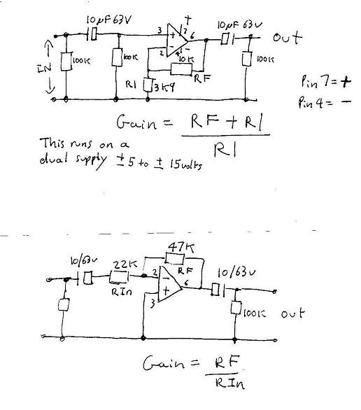

Is what your after a simple Op-Amp based amplifier, low noise, wide bandwidth etc. That's easy !
The problem is I have no idea what sort of signal a guitar pickup outputs (amplitude etc) or what the characteristics of one are. Is it a low impedance device of only a few ohms. If you know what the amplitudes are that it puts out at max and what level you need we should be able to come up with something suitable.
Regards Karl
Edit, I have attached the following. I drew this a few days ago for another posting but it seems relevant to what you need.
Simple Opamp gain stage, you can see how to calculate the gain you need. The first stage is non inverting, the second inverting.
Regards Karl

I'm not understanding what they mean by "the parallel combination of R2 and R3" (I understand what parallel resistance is & how to calculate it!)...but in their diagram the resistors R2 & R3 in series?!
It's exactly as it says. Treat R3 as if it were going to ground as well, which it is basically for dc analysis.
Also I'd need R1 to be at least 1M ohms (so as not to load the piezo pickups)...where does that leave me wrt their statement for the values of R2 & R3 (& bearing in mind I need a gain of 8)
R2 will be a bit more than 1meg and R3 will be 8 times higher. Will just have to do the math to find what values you need.
Finally does it matter how I achieve a gain of say 8. In other words is it better to use higher resistances in the feedback loop (eg 800k & 100k to get the gain of 8) or smaller resitances (eg 8k & 1k)...or does it matter not?
Ideally you want to use as low of values thats practical to keep noise low. Since you have already defined what it has to be in the previous statement, you don't really have much choice.

-> B output ->inv opamp-> summing amp.
& so on....up to 6 inputs (one for each of the guitar strings)
The output of the summing amp would give me one signal...which would be a combination of all the inputs. I can then send this down a standard guitar lead to a normal guitar amplifier.
I guess my question here is do I need to buffer the B output leg via the second inverting opamp described in the chain above in order to keep the 'A output ‘pure’, or can I just take the ‘B’ output straight to a summing amp (cutting out the second inverting opamp).
