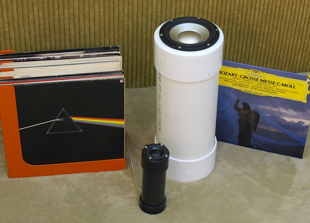

A few months ago I realized that I was going to be traveling a lot over the next few years, and I started to explore how tiny I could design a HiFi system without losing fidelity. My goal was to produce a set of small speakers, with a tiny matching amp, that could travel in a suitcase with me, my laptop, and my FLAC collection. What I developed is the 8" high black speaker you can see in the photo. It uses the magnificent Peerless Tymphany 83093 widerange driver.
However, in all but the smallest rooms, the 2" widerange needed a little more deep bass, so I added a woofer, using the SEAS driver from my Linkwitz Pluto (the white tube) to boost output power below 200Hz. Suddenly I found I had not only a portable system, but a top-notch set of HiFi speakers capable (IMO) of holding their own in any 'average living living room'.

Neato ! If you could find a wider range for the woofer tube, (negating the tweeter tube) It would be even more elegant 🙂
It's not really a tweeter'. The crossover is at 200Hz. The tiny speaker covers 200Hz-20KHz. All the woofer tube really does is increase the amount of air which can be pushed around at low frequencies. The smaller speaker tube does have an extended bass (down really low) on its own, it just can't push around a lot of air 🙂

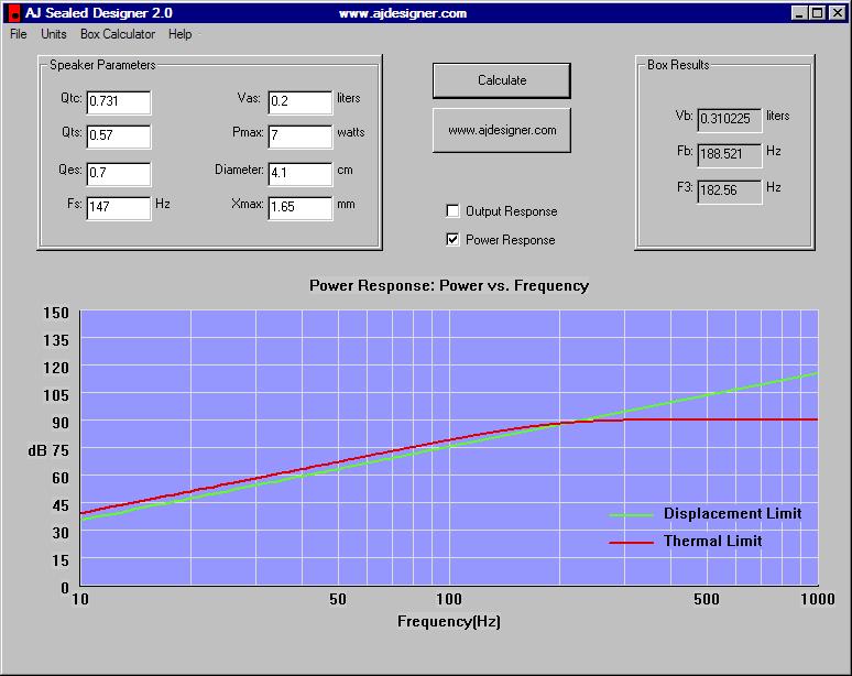

Ive been messing around with something similar, (albeit using seperate satellites, and presently minus the Sub) using Tangband W2-800SL in ~50cc tea-light holders (40x40x50mm truncated cuboid).
They sound fairly good, to my ears. Actually the graphs looked better than the Peerless, which is why I got the TBs, but the results dont always concur with specs 🙄 so Im not critising in the slightest. Interestingly, the cube's F3 is around 450Hz (low Qts ~0.24) so 2 subs are in the pipeline, to avoid localisation as much as possible.
Out of interest what F3 do the Peerless have in the small tube enclosure?
Details attached (P980983 in 8 inches of 2 inch pipe)
First is response, then Power handling vs frequency.
Let's see .. your 90dB limits us to 200Hz and above 🙂 Guess where I put my crossover 🙂 Great ears must think alike🙂

The Qts and lower Fs of the Peerless makes a big difference here, with a Qt=0.24, Vas=0.23, and Fs=160, the TB fits into a Sixth of the volume (sealed)
Had I gone vented instead, my F3 would be better (~265Hz).
