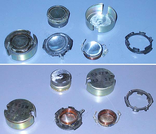

I was sitting listening to a pair of $20 headphones, listening to thier suprising sound quality. I got this idea:
What if I were to purchase a large amount of headphone-type drivers and make array speakers out of them? I would get reasonably good volume levels with large amounts of the drivers, and they tend to be very accurate. I would probably make dipoles and just cut the high frequencies 6db to yield fairly linear response down to the point where I'd xo to a monopole subwoofer.
This could be an inexpensive design, and although rather odd, might yield suprisingly good results.
Thoughts? Problems?

I fear those tiny drivers just won`t have enough (linear) excursion for use as ordinary speakers.Thoughts? Problems?
The power rating and efficiency is supposed to be veeery low too.
You would need huuuuge amounts of them to get reasonable sound presssure level.....and then it is not so cheap anymore.
Better to make an array of minimum of 3-5 inch diameter fullrange units IMHO.

If they are so cheap, the easiest way might be to slaughter one and to throw a look at the voice coil and the magnetic gap height. After You have seen that miniature coil, likely You`ll reject Your idea anyway, I guess

The 115db at 1v is measured in the ear cavity. So is the frequency response. Move is 6-10 feet away and it's a different ballgame.
Take a pair of headphones, put them on and adjust the level to your preference. Now take the headphones off and walk 8 feet away. Notice that there is no bass and practically no lower midrange. Notice too, how quiet they are. I'll bet you've already tried this. Imagine the equalization you would need to do to get them to sound flat.
So let's say you crossed to bass drivers and have equalized the headphone driver array. You still have limited SPL even with a large array. And the high end will pretty much suck unless you add a properly crossed tweeter.
You would be much better off making a two way system with an inexpensive 6" woofer and one or two small Tangband drivers. And a couple of small Tangbands would be cheap too.
