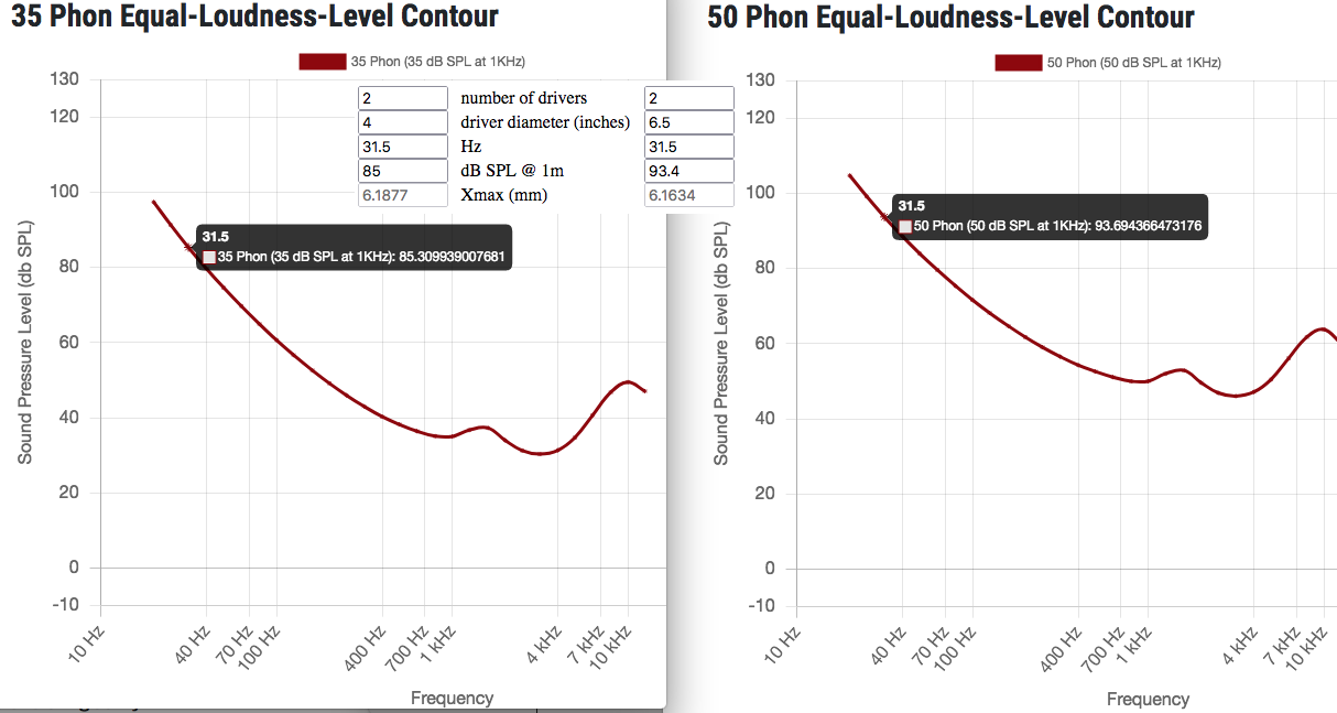

Small speakers are great, but there are limits to what is useful output.
For a given excursion, 2x6.5” have 8.4dB more Sound Pressure Level (SPL) potential than 2x4”.
For example, with 6mm excursion at 31.5Hz, a pair of sealed 6.5” can do around 93.4 dB SPL, the 2x4” 85dB. Finding a 6mm Xmax on a 4” would be unusual…
At 1kHz, an increase of around 9-10dB sounds about “twice as loud”.
At low frequencies, a louder level is required to sound equal in level, that difference being called the Equal Loudness Contour (ELC) , which changes with SPL.
Although the SPL difference between the 4” and 6.5” drivers is 8.4dB at 31.5Hz, the ELC drops 15dB, from 50 Phon (SPL @1kHz) down to only 35 Phon.
50 dBA is pretty quiet, less than most conversations at one meter, 35 dBA drops into the whisper level, below the ambient noise levels common in many rooms.

If you happened to measure using the dB "A" scale, it would read -35dB at 40 Hz, "C" scale about -3dB at 40 Hz.
Room modes can cause large peaks and dips (+/- 12 dB is not uncommon) depending on sub and listening locations.
What was the SPL and excursion you measure at 40Hz which you found distortion unacceptable?
