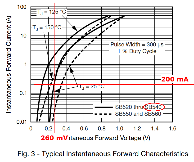

It appears your PCB layout has plenty of room to mount the Vishay SB540 Schottky rectifiers in positions D3 and D4. They have exceptionally low forward voltage drop at 200mA of forward current, see below. Which will eke out a slightly longer battery life.

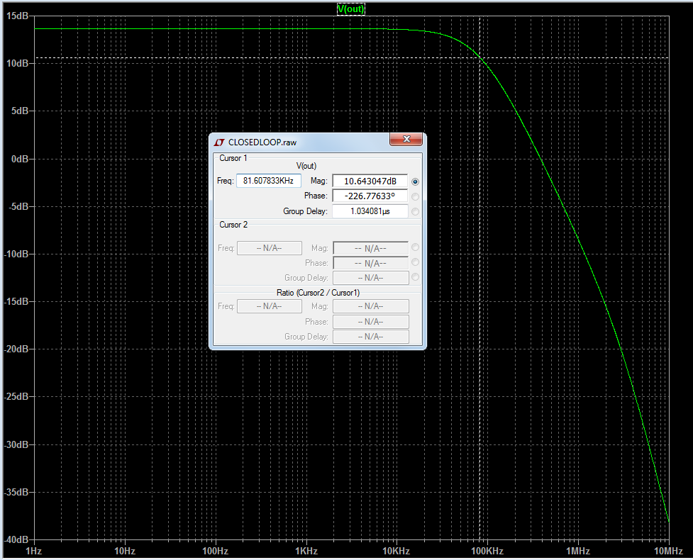

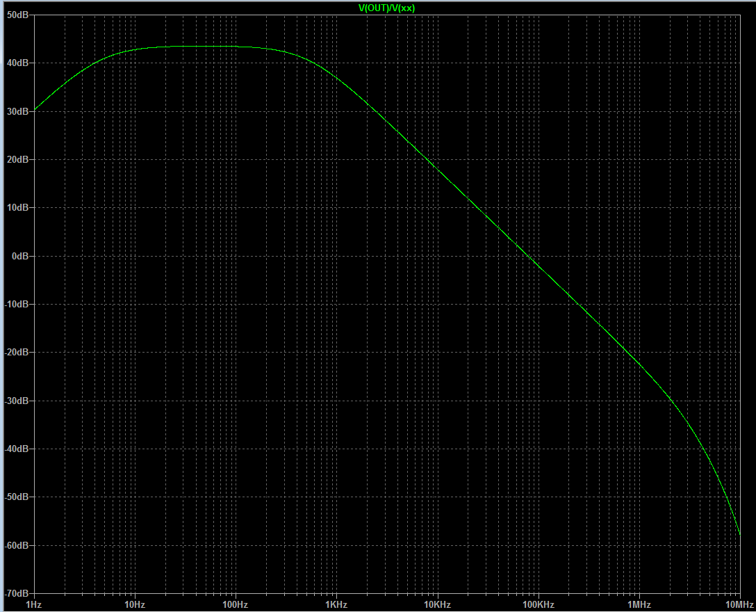

Thanks! I slapped together an LTSPICE simulation using transistor part#s that are presupplied with the simulator, rather than the part#s in your schematic (which are NOT presupplied). I juggled the JFET source resistors to make the JFET bias current about 300uA, which is my wild eyed guess of the current your J112+4.7K will conduct.
Open loop frequency response is in Figure 2 and closed loop frequency response is in Figure 3. The -3dB point is 82 kilohertz, with these device models. Lower impedance headphones will probably change things a little bit, I imagine.

With J112 bias current is about 0.44mA. I can't proof it mathematically, but SPICE says "less current — more linear".
My model's closed loop response:

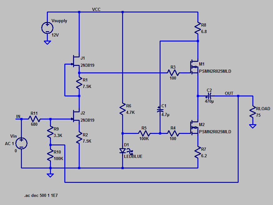

It's alive! I have replaced blue LEDs with UV ones. Blue LEDs has too low dropout voltage at low current (about 2.5V instead of specifier 3.2). I can hear a lot of noise in left channel. I think I should replace one of FETs. Also I plan to experiment with different FET models (I can try 2n54xx series)
Here is my latest all FETs F5 headphone amp. Class a 100mA bias.
2SK170/2SJ74 inputs, IRF610/9610 outputs.
I'm building a portable battery powered amp, so I'm trying to get lower bias current. About 50-70mA should gives enough power for 32Ohm headphones with tolerable distortion level (less then 0.01% in SPICE model). Also lower quiescent current allows me to use TO-92 devices without any heat sinking (or with very little of it, see image).
Also asymmetrical output buffer is very promising. It can be built with two identical cheap MOSFETs. I little bit of asymmetry (controlled by upper resistor) doesn't increase distortion, it's all about power efficiency.

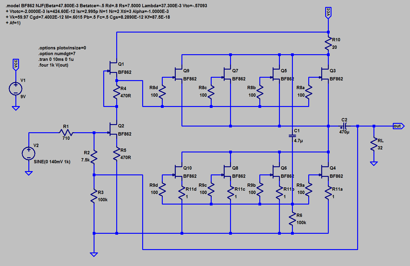

Here I share with you my simulation results.
I use one type JFET throughout (BF862 SOT23).
This has lower noise than both J112 and ZVN4306.
Even though bias is a touch lower at 50mA, I can still get comparable performance into 32R 1Vrms.
-3dB bandwidth is > 3MHz.
And the use of JFETs simplfies the output White Follower considerably.
Best regards,
Patrick

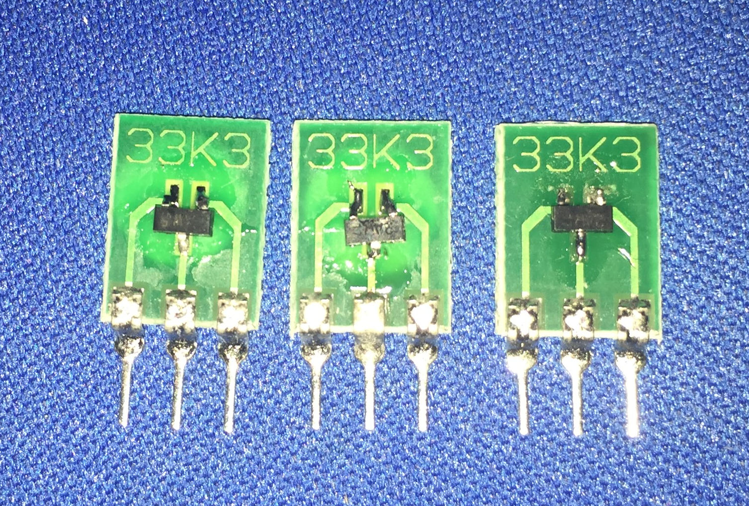

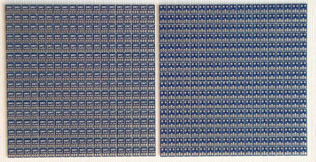

Thanks, Mark. Now, we just need one of the layout masters to make a PCB. :)
Although this is easy enough to do a P2P on a small veroboard with 2SK170's? For SMT, I have used the PVA glue the SMT to a sheet of paper then solder P2P. Or hand painted nail polish resist mask traces can work too.
There is none.
The closest is LSK170C, but Yfs is lower. Also too expensive.
If you wish to try I can offer you 20~30 pieces adaptor boards free of charge.
Might take a couple of weeks.
But eventually you might want to make a SMD board, and have the FETs on the bottom layer.
Then you can use a silicon thermal pad to conduct heat to the case.
BTW, what 470uF caps are you intending to use, bearing in mind you have up to ~150mA Class A output current available.
