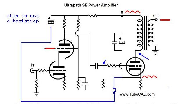

@ #40
Hello Cauhtemoc,
A local circuit in the output is fromed by C2, triode and load, shown by the green line.
C2 is the "ultrapath cap".
Kind regards,
Darius
Hello Cauhtemoc,
Originally #40 posted by Cauhtemoc
If the cathode is grounded, the ultrapath capacitor comes in parallel with the B+ capacitor, and is effectively just another B+ capacitor.
The schematic above is very messy, please post a simpler version if you have one.
Kind regards,
Darius

Re: @ #40
I still don't see what you mean. In a standard grounded cathode amplifier with the cathode grounded, a local loop is formed by the triode, load and B+ capacitor instead.
oldeurope said:Hello Cauhtemoc,
Kind regards,
Darius
Re: Re: @ #40
Yes. 🙂
link #35
Cauhtemoc said:
... In a standard grounded cathode amplifier with the cathode grounded, a local loop is formed by the triode, load and B+ capacitor instead.
Yes. 🙂
link #35
