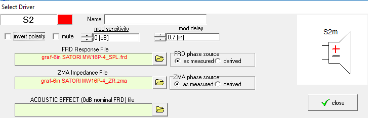

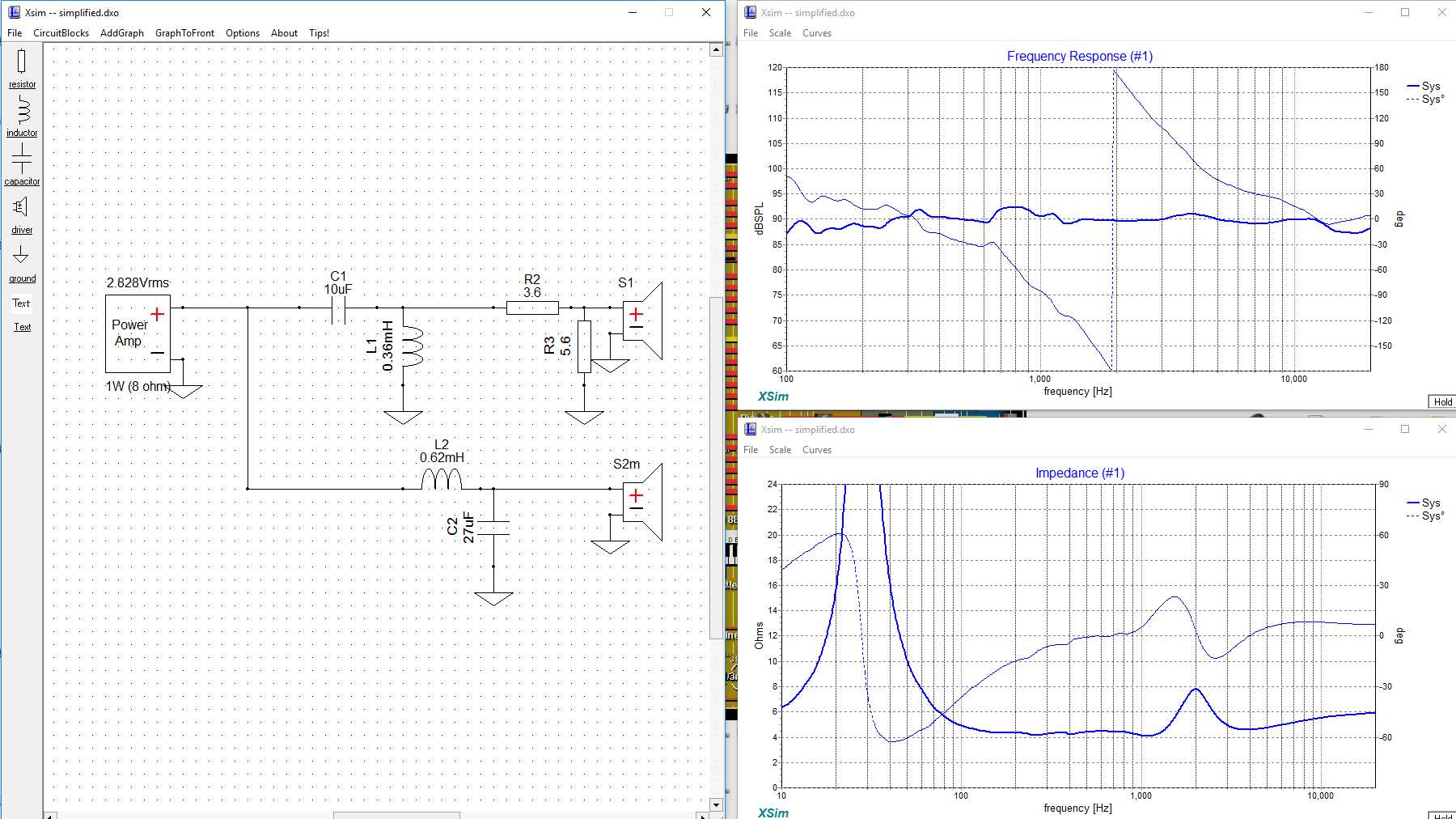

I'm starting to break down here a bit, I am currently trying to make a nice high-end set of bookshelf speakers and we all know the crossover is so essential to having that final great sound. I've currently done some messing around and just for now I have come up with this (see crossover1 photo) yes it isn't perfect and may require a notch at 700hz etc I understand...
(NOTE HOW BOTH DRIVERS ARE CONNECTED WITH +, TRYING TO ACHIEVE THE "IDEAL" LWR 2 CROSSOVER.)
First of all regarding crossover software, I personally use XSim. Does the software assume that EG a 2-way bookshelf speaker that the acoustic sources of energy (lets say the dustcap on a woofer and top of dome on tweeter) are in alignment to start with when in reality on a flat 90 degree baffle the woofer is behind the tweeter by that little bit? Would this not make sense to design the speaker with a delay behind how much the woofer is behind the tweeter on your 99 out of 100 speakers? And let’s say we are to adjust offset by let’s say woofer 1 inch in front would this program assume the acoustic source (dust cap) is actually one inch in front of the tweeter when in reality is actually near perfect aligned? So is it telling you what the drivers "physically aligned" is or is it plus the 1 inch you added which would make it one inch in front of the tweeter? But how come when in practice it actually works as we want it to, are the programs designed in mind with the standard that the woofer is a set distance behind the tweeter ?
This then leads into my second and just as important question to me.

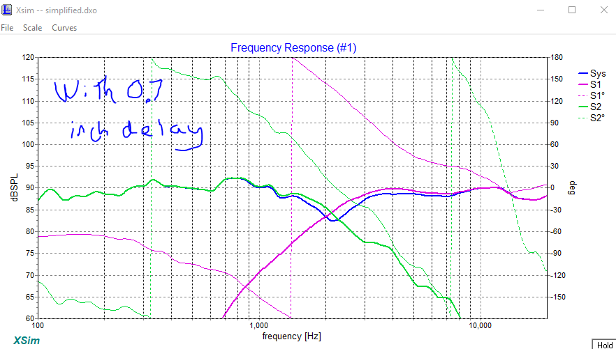

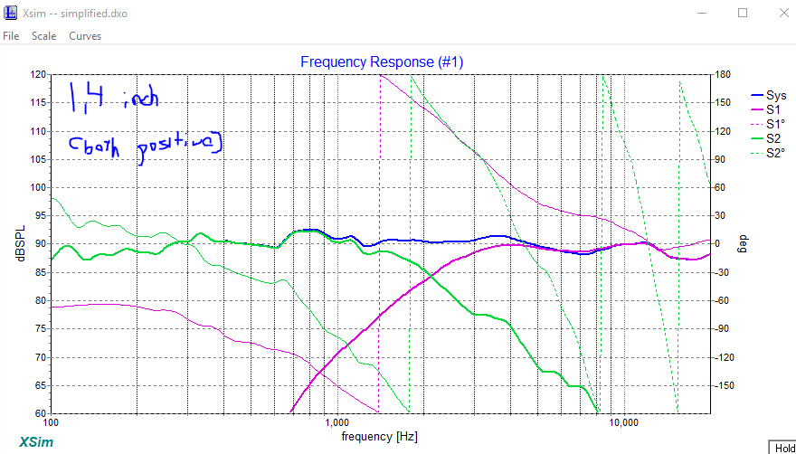

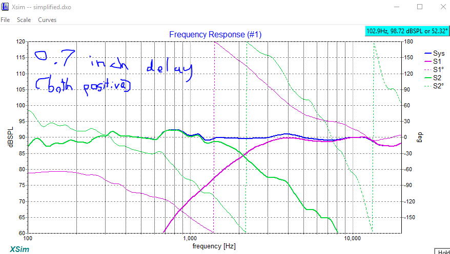

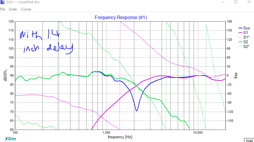

In photo crossover2, we can see that I've adjusted the offset of the woofer by 0.7 inches in front. If I am to invert the tweeter (see crossover 3) we get that response. with a shallow dip at the crossover frequency. However, if I then go ahead and adjust that delay to 1.4 inches, and reverse the polarity on the tweeter (refer to photo crossover4) we get a much deeper, sharper dip at the crossover frequency. Is this not showing much, much better agreement with drivers when the woofer is 1.4 inch in front? am I missing something here guys? is the shallow "null" with 0.7 inch delay with a driver reversed polarity not giving optimal phase results?

Great stuff with simulators that take in acustical effects of off-set and dust caps. I am guessing that the dip variation is probably caused by the phase difference between the drivers themselves (not the total phase). I read a cowboy-trick somewhere, that you should be able to get away with flushmounting tweeter and bass by adding an extra pole in the tweeter crossover. That is 2. order filter for bas and 3.rd order for tweeter. I haven't tried it myself but it sounds plausible.
Anyway, the acoustic of any listening room is quite forgiving, and I am quite shure that the small dip at 0,7" offset is not audible, and not even measureable more than 3 feet away from the frontbaffle.
There is no need to make guesses about where the acoustic center may or may not lie on the driver diaphragm, etc. Instead, make some measurements and determine exactly how far apart the acoustic centers are for your particular set of drivers in the particular baffle mounting that you will be using. This means you need to build the loudspeaker FIRST, then measure, then design the crossover. When you know the acoustic center offset you can include it in the model of the system, e.g. in Xsim or whatever crossover modeling+design package you are using.
You can measure the acoustic offset using the interference between the output from two drivers and a program that will let you fitting the offset. There is a good explanation of this technique written by Jeff Bagby called "How To Use Passive Crossover Designer To Find The Relative Acoustic Offset". Just google it. Not sure if Xsim has this functionality or not.
The delay is differential (i.e., apply to only one driver -- in most cases, add delay to the tweeter, moving it away from the mic). If you know where the pole pieces of the driver magnets are, those aren't usually terrible guesses of where you can estimate the positions to be if you don't have measurement gear.
That bump near 700Hz will probably be minor (and possibly nonexistent) compared to what baffle diffraction will do (Jeff Bagby and some others have software to estimate that). If you do measure (advisable), try to do it AFTER you make the baffle/box so you can measure the drivers on the baffle and box which will include those effects. Don't try to get too detailed unless you have real on-baffle measurements of your actual drivers -- reality in speaker design can unfortunately be a b**ch! 🙂
