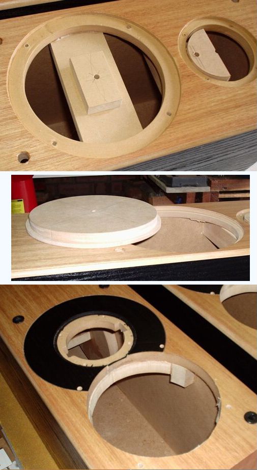

I'm Glad you are closer to your sound goal (Is there a pun in there?)
anyhow, the other thing I like is the "plug" you built for the original woofer hole AND you craftsmanship! 😀
Thanks for your kind words.
I suffer from OCD (obsessive compulsive disorder) which helps the craftmanship, but can take ages.
You'd roll around the floor in laughter watching me put a woofer in.

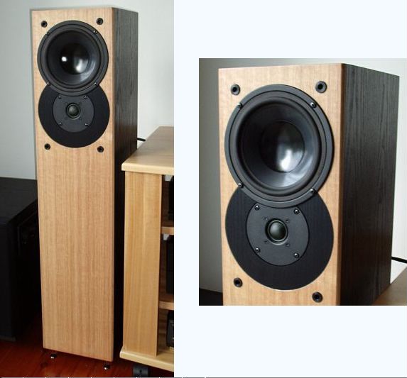

Eton said:According to this detailed article, it creates more problems than it's worth.
http://sound.westhost.com/ptd.htm
I've seen that article before and is quite interesting.
He still concludes that time alignment is beneficial. Diffractions are a problem with a stepped baffle, but could be minimised, a sloping baffle is not true time alignment and neither is the method I have chosen with inverted drivers.
1st order crossovers need to have nearly zero driver horizontal offset to obtain their benefits and not have great dips or peaks at the crossover frequency. The modification I have done is to minimise the problem that occurs at the crossover frequency where you can have response variations of 10dB due to driver offset. I think this is too large and needed improvment. My frequency response would still go up and down all over the place due to the room, drivers but would not now be compounded by the crossover dip.
I've noticed manufacturers such as Mission, Kef and Dynaudio are using this method.
