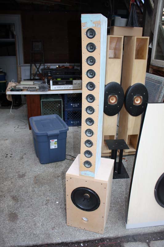

I've seen other speakers with odd-shaped tilts and boxes.
It's just another gimmick to lure people with.
Just like those spikes and all the other dreamed-up nonsense.
