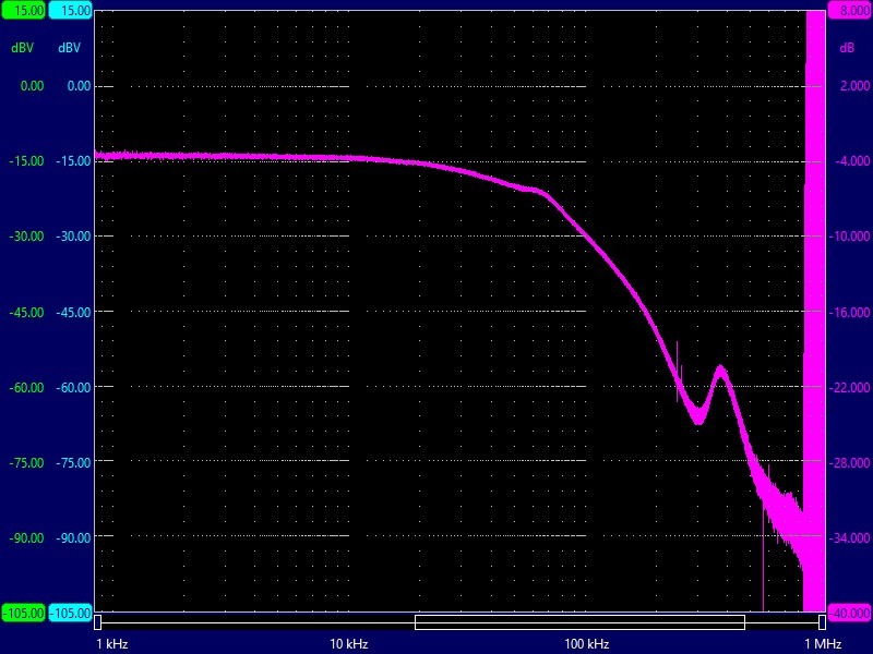

I recently use a Tiepie HS5 usb oscilloscope.
I'm trying to measure the response of amp, output transformer or filter.
Apparently there is no fast tool for bode plot (phase and magnetude response measurement).
I find a solution for magnetude response/fréquency with "Math" tools but nothing for phase response
Is anyone using another solution ?
Thanks for help

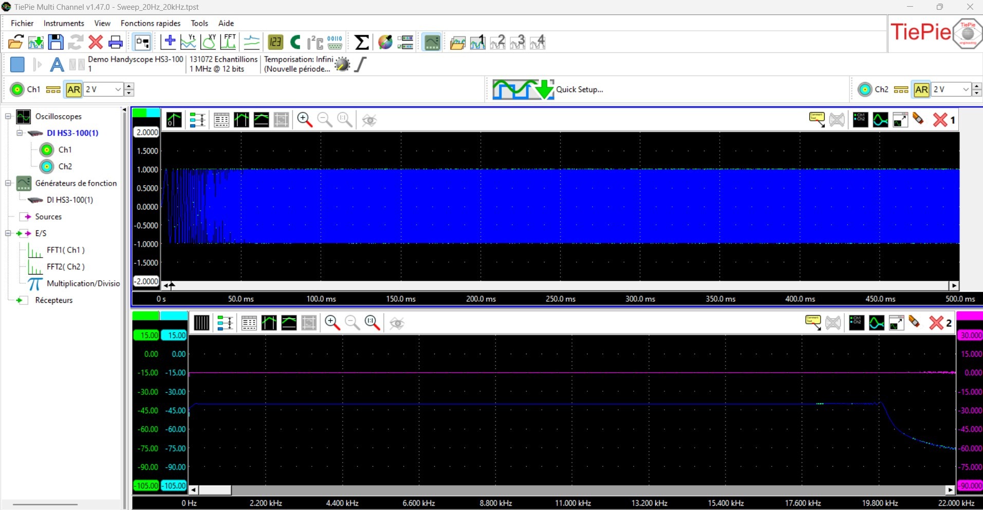

Hi
Many thanks for your answer.
I've found a solution for the bandwidth and she works with de hs5 on win11.
I'll ask directly Tiepie for phase response.
Here a screenshot with hs3 demo
Quick setup / spectrum analyser / circuit sweep /...
