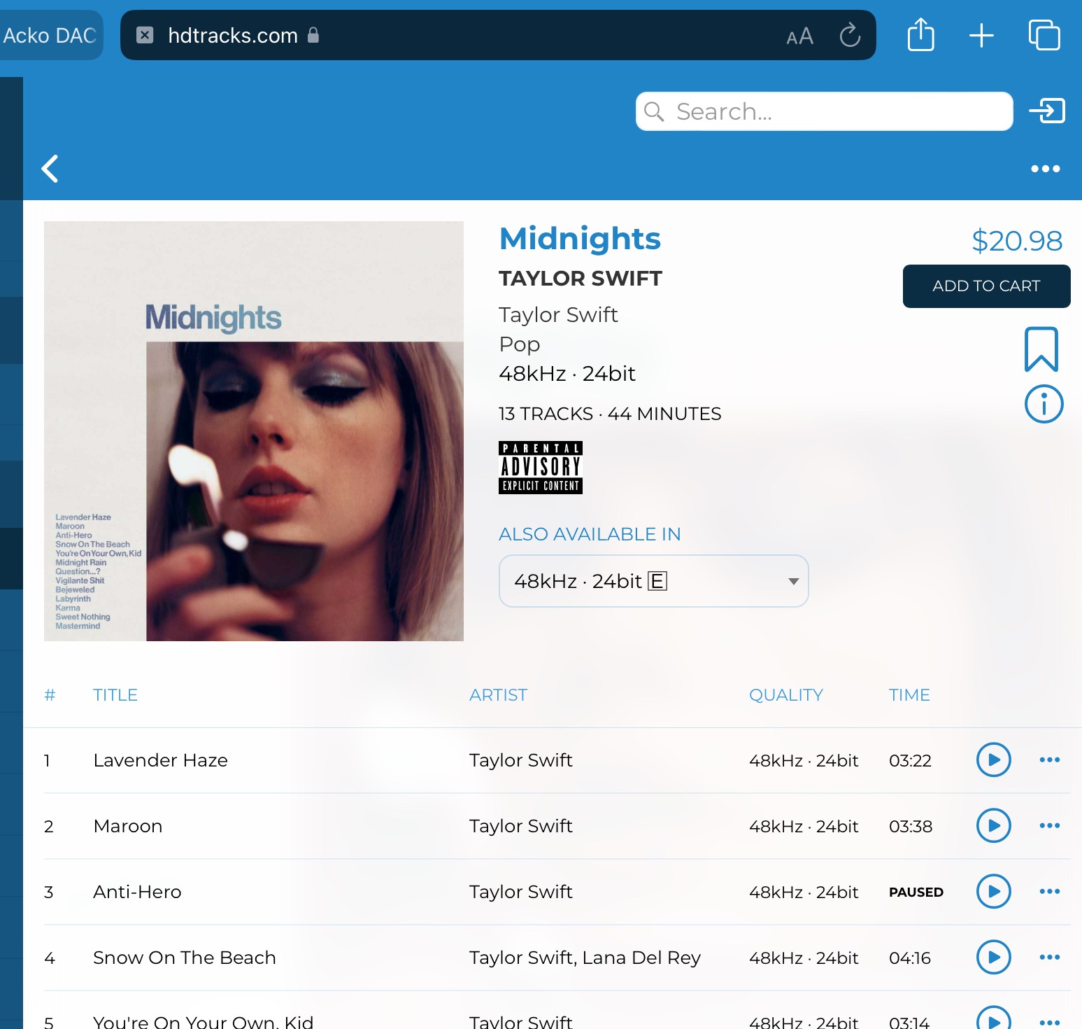

Perhaps another take: looking at downloading this from HDTracks, only two formats available Standard and E, both 48k, 24-bits so, HiRes and better than CD quality but no information on how the studio master was created. If recorded at 48k 24bit then exactly as intended for us to hear. Otherwise, we are sort of missing out on the original version with what is actually ‘flacked’. Who knows it might 16-bit CD quality resampled to look like ‘HiRes’
