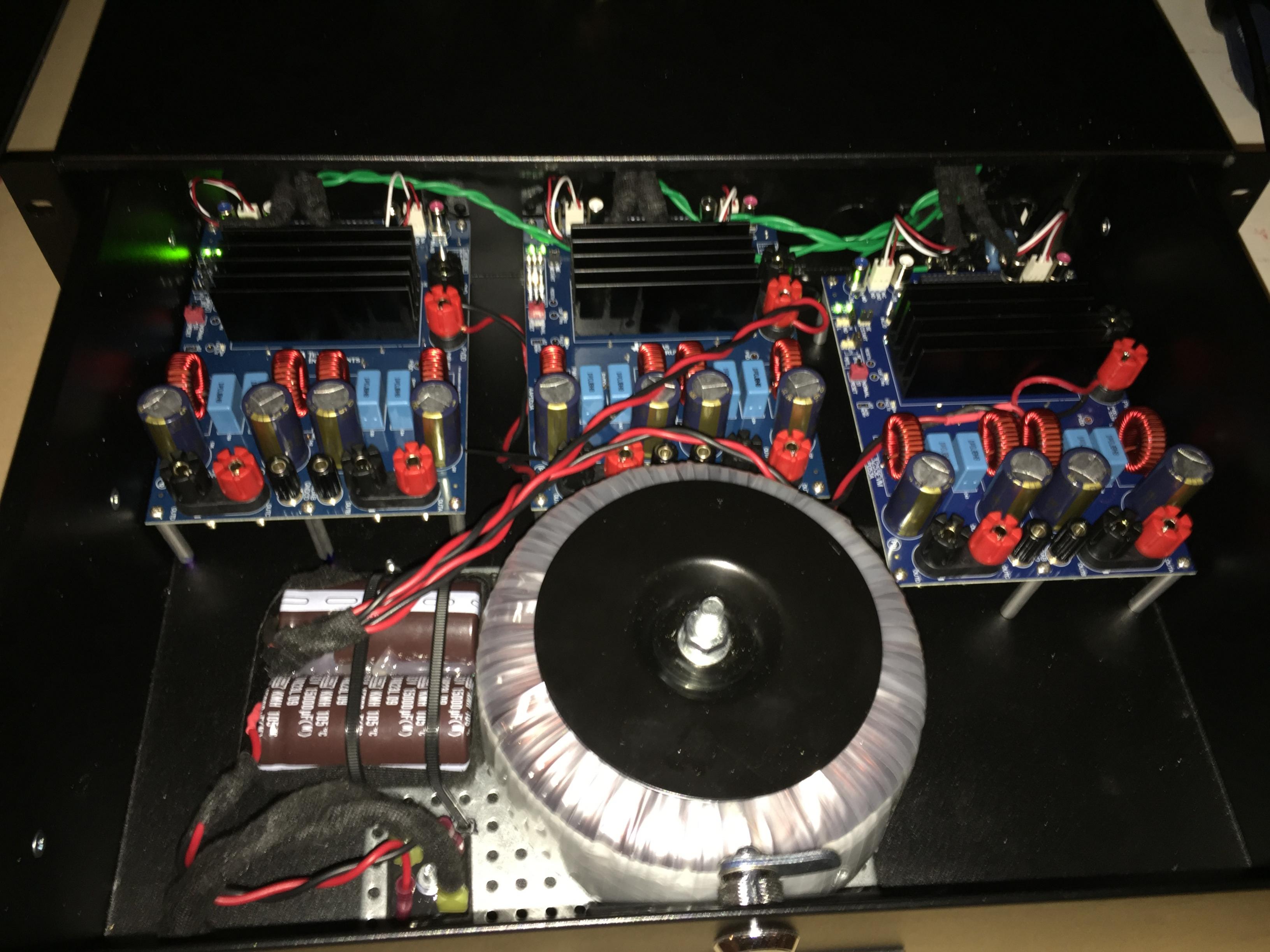

Has anyone put one of these into some kind of finished project? By which I mean doing something more elaborate than just screwing it down to piece of wood.
My TPA3250 EVM is housed in this:
It's now running PiCorePlayer (although it shows Rune in the picture)
Also in the case (an old Cossor radio) is:
RPi 3 with an IanCanada Isolator, Waveshare 7" touchscreen, Allo Boss DAC, an ALPS pot, and a Lorlin rotary switch to select the amp input from either the RPi, a BT module or a 3.5mm AUX jack input.

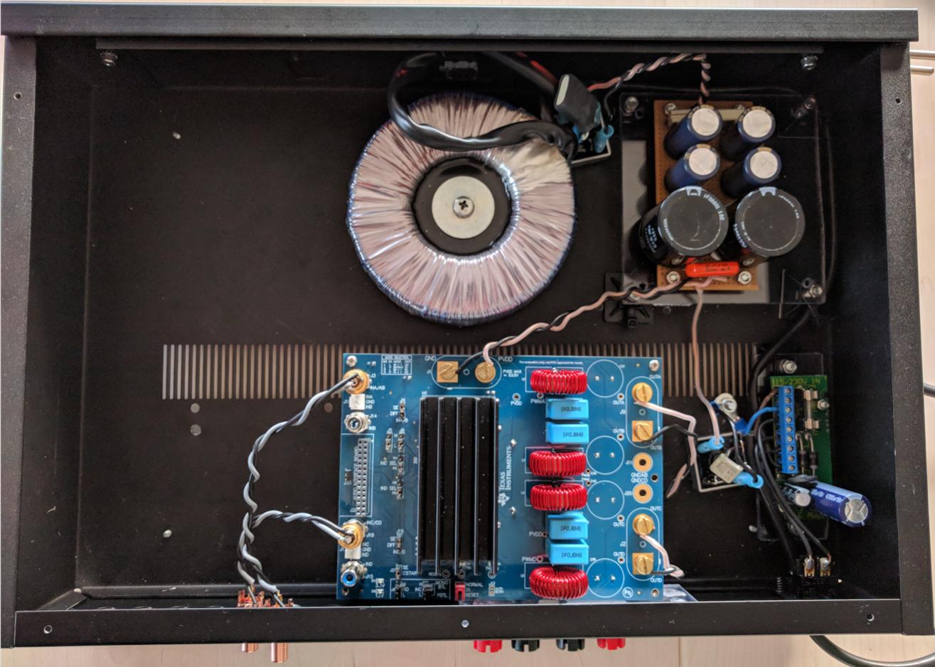

I (nearly) completed my second class-D amplifier this weekend, and the first one built around TPA3255 EVM. The chassis and transformer is an old Thule preamp (yes the transformer is from a preamplifier!).
Capacitors is salvaged from the preamp and from the TPA board, as they didn't fit inside the chassis. For the permanent capacitor bank I plan to order a few Kemet PEH169 caps.
As for the sound, first impression on this amplifier compared to another class-D amp I built is a much clearer, "softer" sound and very easy to listen to for extended periods. Excellent midrange and good or very good treble, but a bit weak in the bass.
...but a bit weak in the bass.
Perhaps due to the tiny transformer?
Best regards!
No, the transformer is more than adequate, 2x33V and 3.8A continuous. Besides, I haven't played loud enough to use more than a small amount of this power.
I have a Wondom TAMP2500, with a smaller trafo and there is definitely no shortage of bass there.
