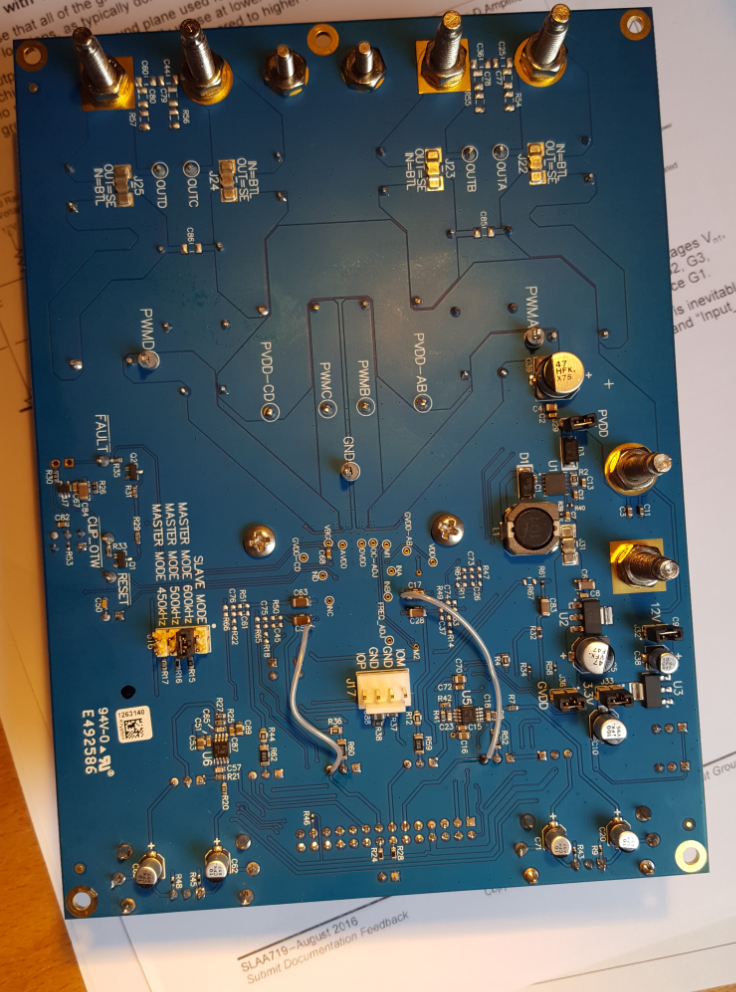

DPH please photo other side PCB.
Sorry, I guess I can get a photo, but the top side really just has the jumpers, connections, output inductors/coupling caps and a heatsink covering the chip. All the interesting bits are underneath, to be honest. Plus, the EVM manuals have a rendered view as well.

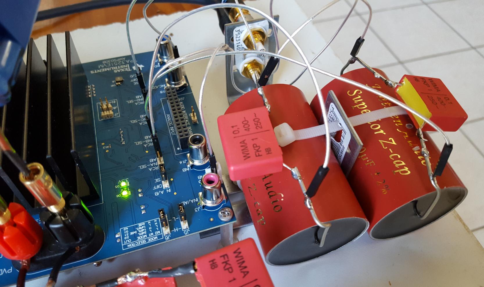

Disclaimer : this is just a test for me. Don't laugh or I never post again :D I write this while other are watching football...
I finally managed to find some nice quality caps to replace the onboard DC blocking with ceramic cap and try to evaluate the effect on the sound quality of my precious TPA3251EVM.
I made this test very quick. I will think later how this can be assembled in a clean way. The ceramic caps were bypassed by soldering wires from exit of ceramic coupling caps until jumper headers for easier testing. There is absolutely no perceptible noise.
My first attempt was not successful. Sound was not meeting my expectations. Too flat, weak bass, shrunk sound stage. Was thinking switching back. But after overnight the stupid culprit mistake jumped into my face. The header pins I choose for the bypass were connected on both sides of the coupling ceramic cap, and this certainly messed the sound. After changing to the header pins linked to AIB and switching on again, the awaited wow effect came.
I like the "out of the box" sound of this board very much. It is really good. There is some kind of graininess I like on some tracks, like vocals but disturbs me on others like orchestral passages where it becomes a bit harsh like the big grains are blocked in the audio tube. Compared to my modified amps, the sound stage is very nice and precise but smaller, more around the speakers.
The replacement of the ceramic caps by nice big red Jantzen, bypassed by Wima fkp1 remove partially this graininess. To my opinion, highs have more details (grains are smaller), voices are more realistic and sound stage appears more consistent, bigger. Music seems to me more fluid. Complex passages are easier for me to follow and I feel bass to have more precision and pressure. And this is just with a few hours of burning in the caps on the counter.
I think this coupling modification (and input stage bypass) pushes this already very good amp board to a better level of musicality. It costs, beside the expensive caps, also half of the amps power. Ideal-wise a dac with balanced output is better with this amp. In my system it is a worth tweak. I will not go back.
I was thinking the coupling ceramic caps are directly connected to input pin of tpa3251, but I noticed while measuring that on this tpa3251evm there is still a 100Ohm resistor between them and input pins of chip (with 100pF to ground). This is certainly a LPF just before the pins. Soldering my wires on via inputs would have also bypassed this. I hesistate, but didn't do.
Dominique
Dominique
As I understand it, since there will always be zero volts across C28 and C63, there was no need to bypass them. You only needed the new caps to "replace" C17 and C55. If you were to go with a balanced input, you would have to "replace" C28 and C63. Two's company, four would be a crowd!
